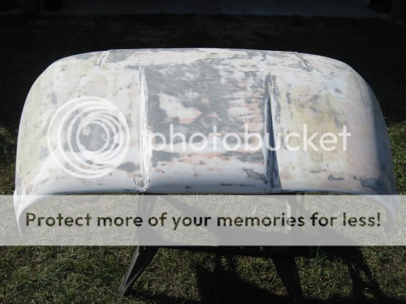

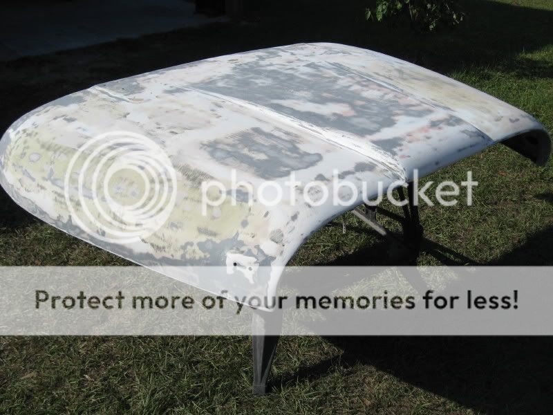

Since Bondo said "get it off" that's what Clay and I did. Clay did most of the sanding to remove my screw up last Monday. The hood has been air-drying in the shop since then with the hopes that the solvents will gas off. I went out this morning and took a piece of 80 grit and hand sanded the hood. The purpose is two-fold. I wanted to remove more Bondo (maybe it will gas off faster with the surface opened up), but I also needed to give the hood a little more tooth. It had been sanded so much it was like a baby's you-know-what! I was concerned that the primer would not stick.
It's a beautifully cool day with a little more breeze than I would like, but she's gonna get primered anyway. 30% chance of rain today with 70% tonight.
Here's where we are at...
Same old side reference shot.

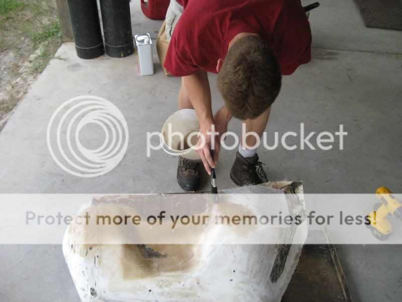

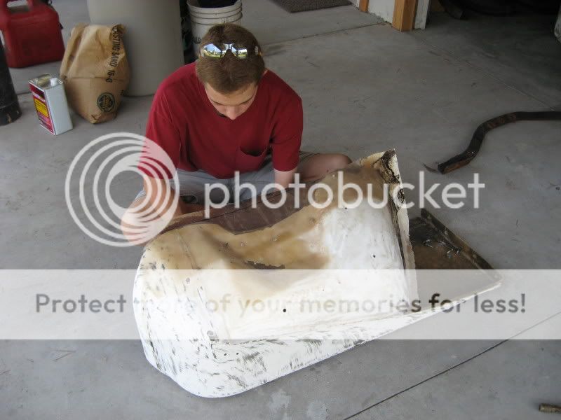

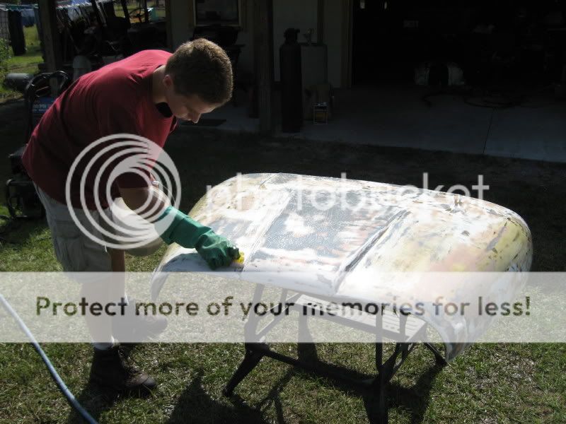

Clay took a break from his school to work on his Jeep. YAY!! Made me happy. Y'all haven't seen him on it for awhile. He had a Biology quiz last night, and he really doesn't like Biology! Poor kid!

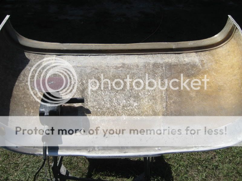

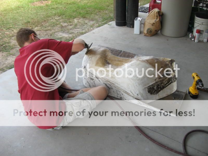

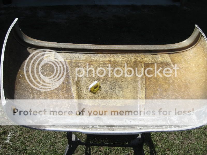

After reading up on FG prep on a Corvette forum I realized that we would be making a mistake if we didn't finish under the hood too. So Clay came outside, hand-sanded the top some more with 80, and I hit the underside with the sander. The idea is to just knock down the rough stuff and coat with something durable. Don't know what yet... any recommendations? We finished the sanding and degreasing and washed it all down with water. We also discovered, while inspecting the underside, that some of the reinforcing glass is looking somewhat rotted/aged. So we're planning to do a little repair in this area since the hood gets a lot of wind stress.
While it dries, Clay got busy on his fenders. We worked on that until he had to come inside to work on his Technical Writing. So I am in withdrawal again!
Clay washing the hood.
Sanding the underside with 60 grit.
A wee bit of a scrub bruch. I have a nice, big carwash brush. But, BEHOLD, I have an 18 YO with his own truck! Where is my carwash brush??
Clay removes the screws from his fender mold. How does he sit like that?

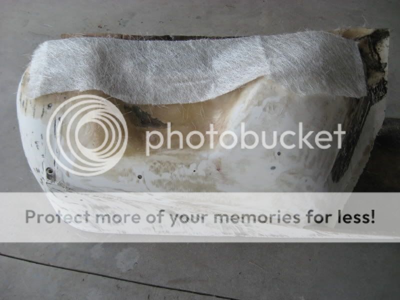

Preps for last layer of glass.
Checks his fit.
Applies the resin.
Done! Let it dry.
