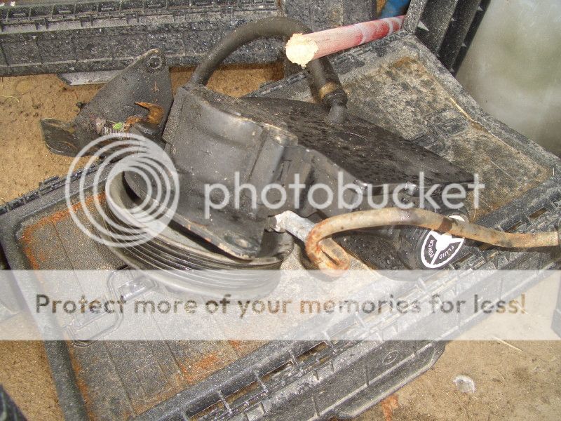

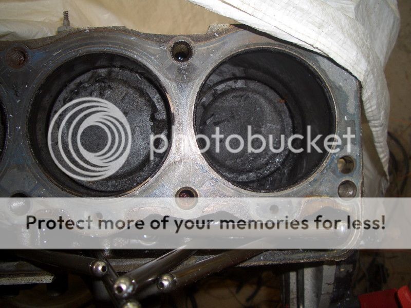

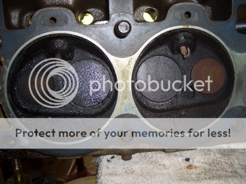

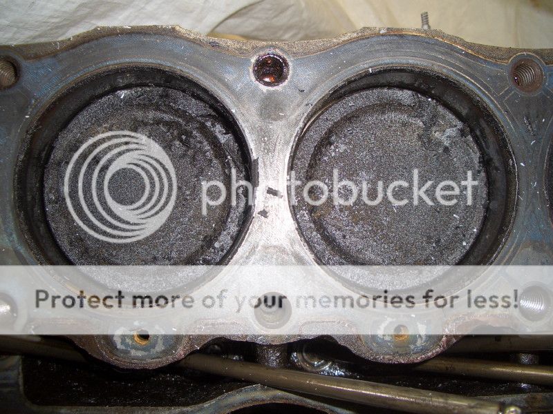

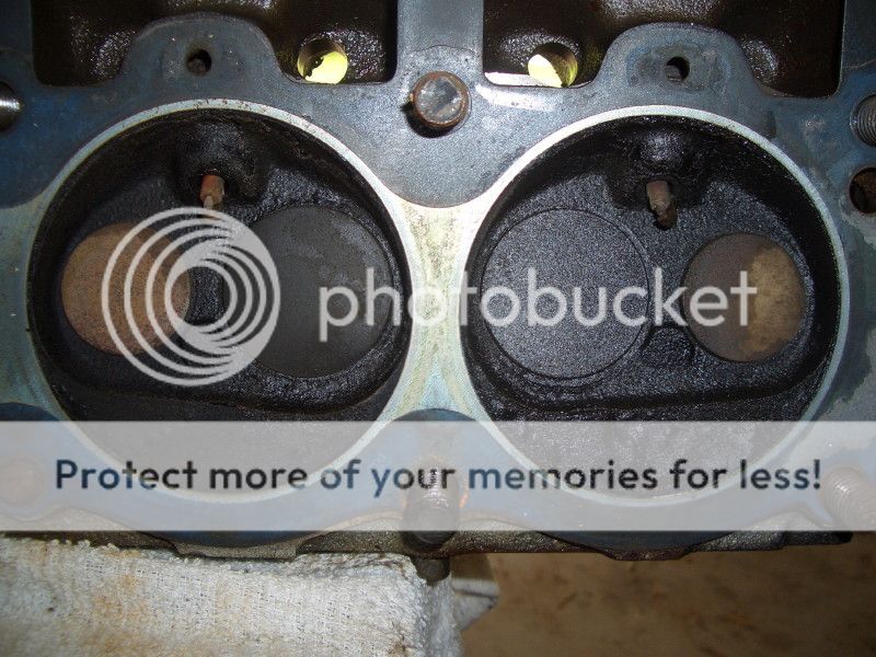

The junk yard owner is crushing cars, cleaning up his yard. He has only 5 Cherokees left, only 3 of them are XJs, and only 1 is an OBDI vehicle. So we're looking at an extreme shortage of parts for this swap. Clay decided he wanted to go serp afterall, so we ended up getting the power steering pump and gear box and the cooling fan and shroud. I got the tilt column for my 7... but that will be on my thread. The really good news is I found a 92 XJ Laredo stuck out in his lot, at random, not in what used to be the Jeep section, and it is complete. LOTS of parts to get!

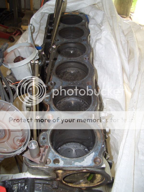

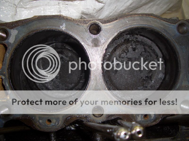

In the shop, Clay swapped back to the XJ water pump, replacing the CJ pump we had installed. Now he is painting parts, and it is raining! I took some pics for you guys to look at. I never showed you his 258, and I wanted to do that. here are some pics of what it looks like after pulling the head.

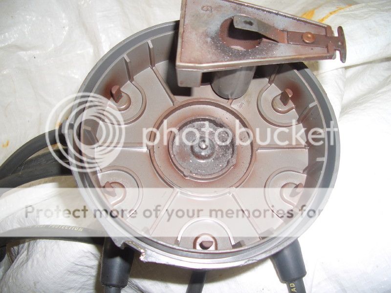

To start, here is a pic of the dizzy. This is off the factory 4.2 dizzy that had been Teamrushed. Why does it look like it does? I was going to stick it on my engine, but I want to know what is going on first.
Overall shot of the block. This is the 258 we pulled. If you remember, it was spewing oil out of the dip stick tube.
From right to left, cylinders one and two.
Cyl 3 and 4...
Cyl 5 and 6...

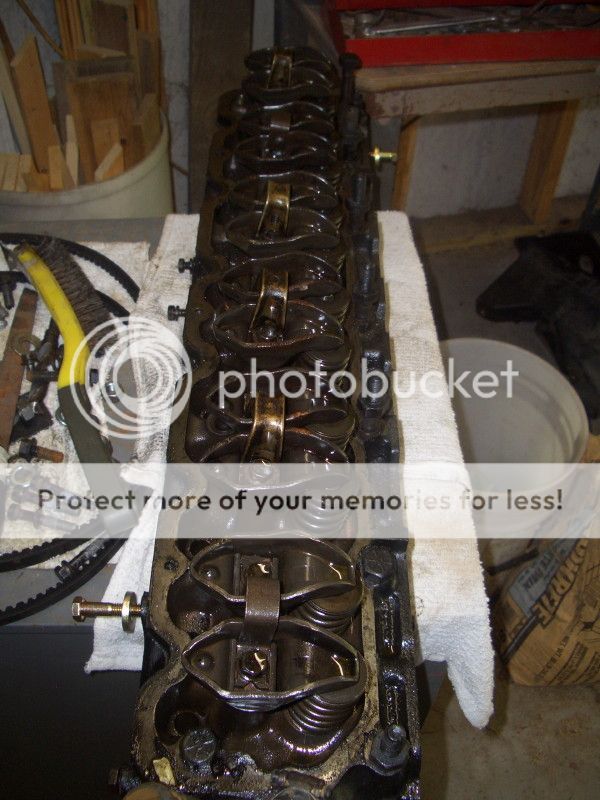

Pics of the head. First one is overall.
From right to left. Cylinders 1 and 2.
Cyl 3 and 4.
And finally, 5 and 6.
There is a distinct lip at the top of each cylinder. I'm assuming the engine has high miles, the rings expanded enough so there was a larger gap between the ring ends, and thus the blowby?? It sure did run good!

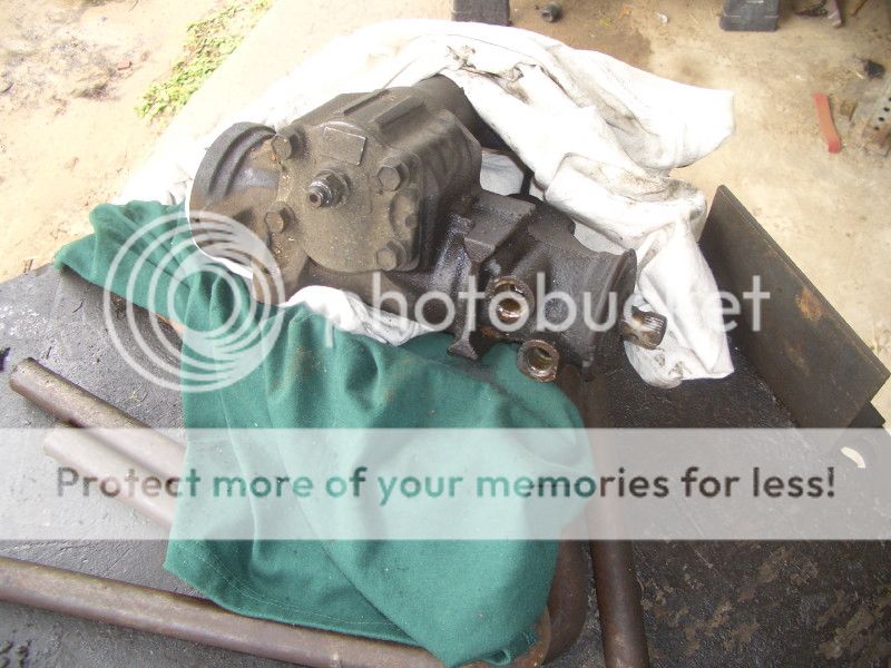

And some new parts to go on the broken down, sickly, despondent, out-of-action CJ5! The thing that's clogging up my shop!
XJ steering gearbox.
Power steering pump.

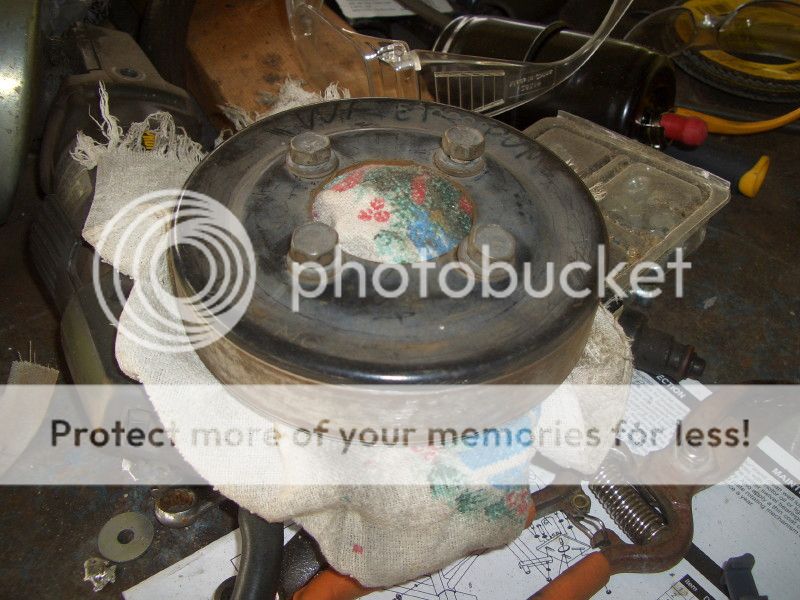

Cleaning up parts prior to install.
Going back to serp!

Hey Skipper on that pic of that thingamagiggy that bolts on to the top of the whatumacallit (the round stuff that goes back anfoth ) aint those black things supposed to be completely round?
In uderwerds me thinks you burnt a couple of valves.
And yes a ridge on top of the cylinders is normal depending on the mileage.
gmakra is offline
post #5053 of 5462 Old 07-06-2013, 03:29 PM
Jim1611
Jim1611's Avatar
Posts: 7,319
The old 258 looks like it could use some help. I'm with George on the valves. Has allot of carbon buildup too. I'd say the block needs to be bored but you can't know till you measure the cylinders. They need to be within .002 to really be in spec, that's taper and roundness. Sometimes you can cut that ring ridge off and be fine though.
The dark spots on the two valves?? I didn't even notice them until I posted the pics! Gonna have to look at that more closely.

No immediate plans for the engine, Jim. It may become a reef!

Valves look pretty nasty. Keep at the 4.0 Scott, you are so close!
