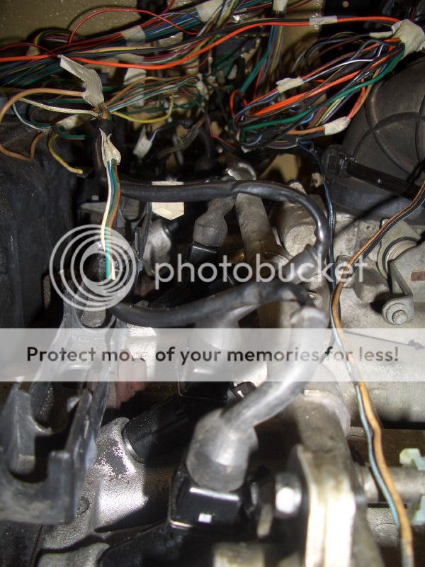

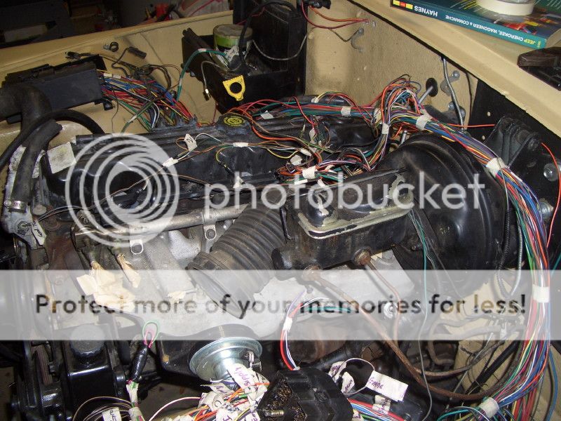

Here are the pics that George requested. Let me know if you need something more specific.

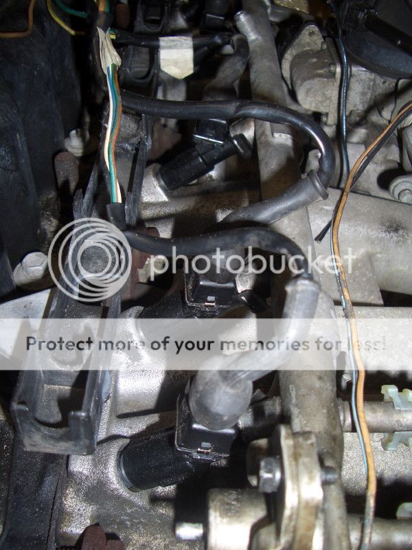

Injectors...
Cam/Sync sensor.
Coolant sensor.
TPS and, and, steppor motor?

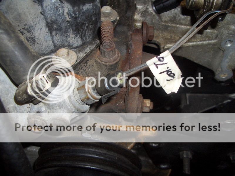

CPS (CPK) Crank Position sensor.
Overall shot of engine bay.

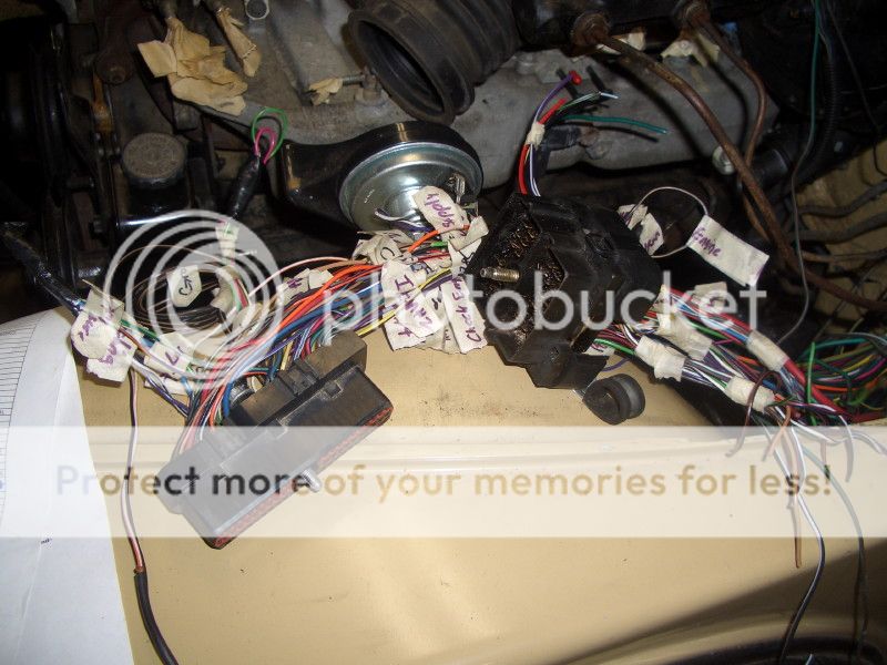

PCM plug and bulkhead connector.

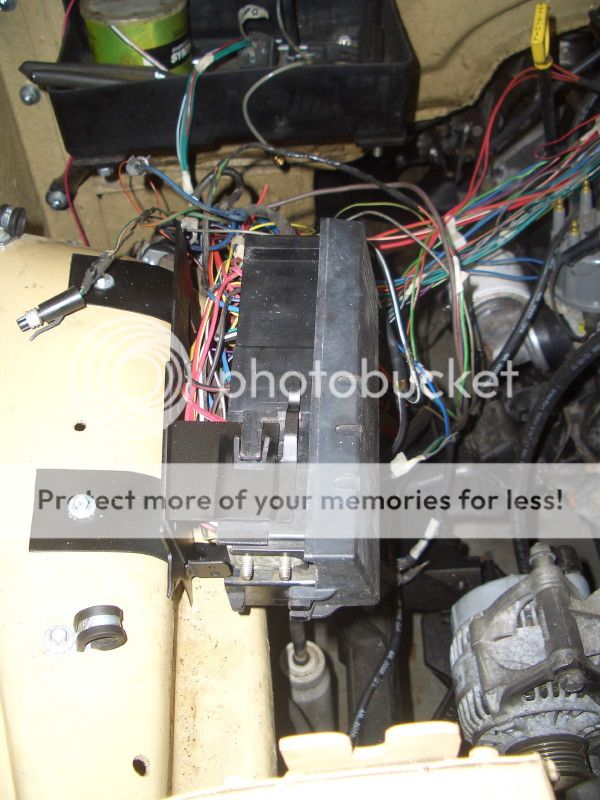

PDC (Power Distribution Center) mounted on pass fender.
What is this plug? Looks like a headlight plug that didn't get cut out. I want to be sure.

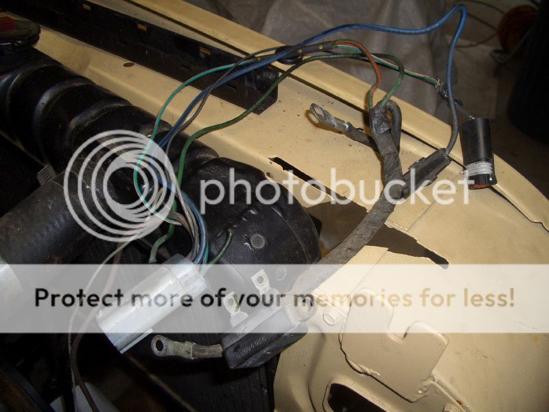

This harness is chopped up by PO. Goes to Alt, coil, etc. Can I save it or do I need another one?

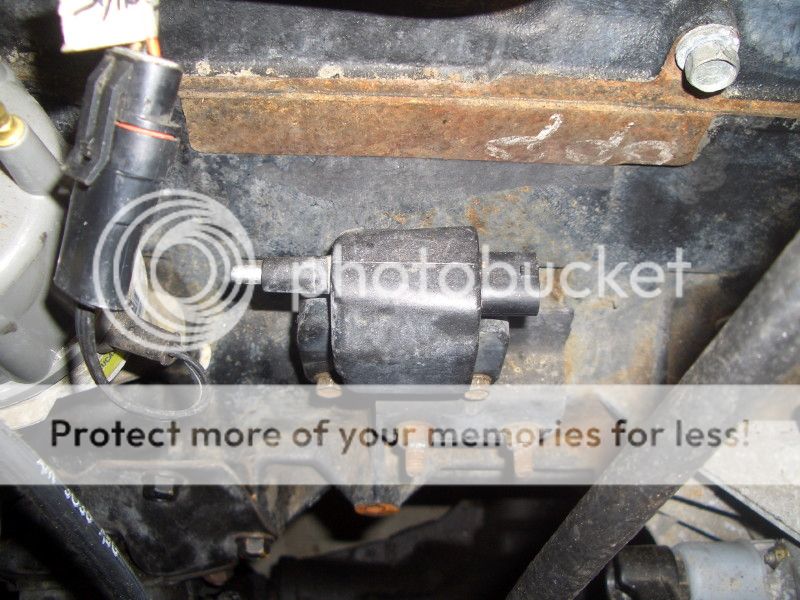

Coil.

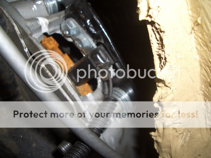

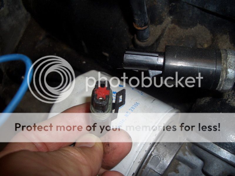

Oil pressure sending unit. Gotta change the sensor.
Oil sending unit plug. Looks to me like one tab???

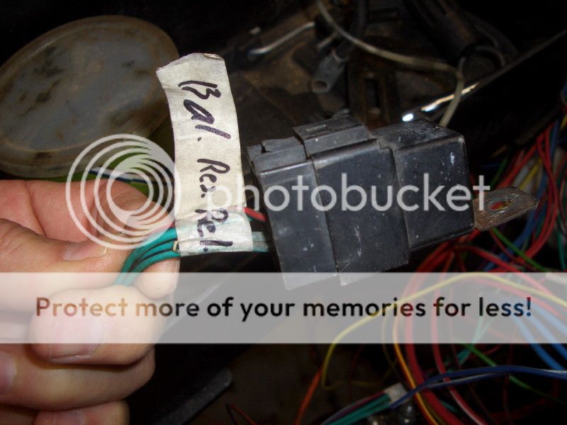

Calling this a ballast resistor. Correct? Just screw it to some surface somewhere?
Still have pulleys to change.

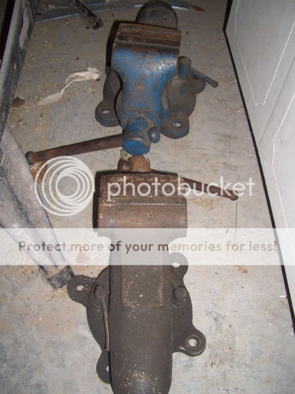

A couple of oldie-but-goodie vices Clay's boss gave him!
How is it looking? Thanks, Everybody.

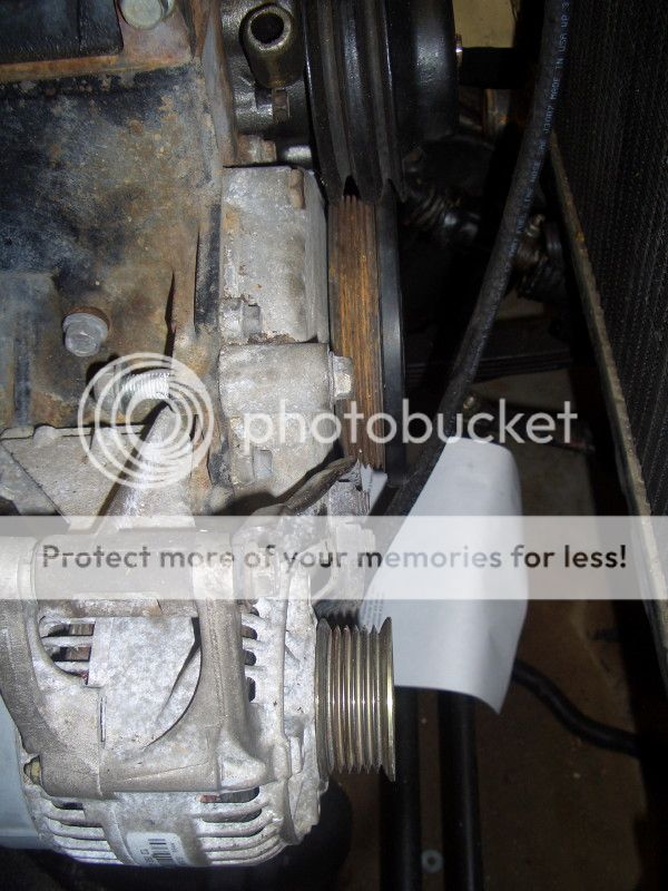

I will also add that it doesn't look like the V-belt pulleys will line up. Water pump is at an angle. So is the power steering pump. If we go back to serp belt, what will it entail? I don't want to mess with electric fans and relays.

Well I guess I am getting old, cause they are definitely heavy! Clay's boss likes him. He has asked Clay if he can continue working for him through the fall. It was supposed to be a summer only job. He has offered to Clay an old hydraulic metal brake and a wire-feed welder. Some of his old, commercial stuff that has been updated. When Clay told me about it my jaw 'bout hit the ground, and I started trying to figure out where to put them! Too bad they are both 3-phase!

Your "Ballast Resistor" is a relay. Mopars used an ASD relay (Auto Shut Down), that powered the coil and injectors. They also used a Fuel Pump Relay. Maybe check the wiring into it and see if you can determine what relay it is...
The other round w/ 3 blade terminals looked almost like a A/C switch, but don't quote me on that.
TPS and IAC (Idle air control). IAC should have 4 wires going into it.
Man, you really went at that bellhousing!! Your sensor position looks a little off. Maybe that's just 'cause the hole is so big!
Here's a photo I used for reference...
That alternator connector is tough to find! (The molded one with a bunch of ring terminals coming out of it.) I'd try to save it if possible.
It would make sense that the fuel pump relay is triggered by the CJ ballast resistor wire. This wire should be hot on Start/Run, which is when you want the fuel pump running
I let my son (Clay) do all this on his own. It was very hard to sit back and keep quiet! But he built the bracket, mounted it up, everything by himself. He measured carefully to get the sensor in the right place. I hounded him about it! I'm hoping it would prove to be an issue. I did not go behind him and check it.
Will do...

So is this correct? Ballast resistor? It does look like a relay, but I thought the fuel pump relay was inside the PDC?
You are correct, that there is a fuel pump relay in the PDC. Your photo looks just like the fuel pump relay from my Howell TBI setup. It's definitely NOT a ballast resistor. All the ballast resistors I've ever seen either look like this...
or a long section of resistor wire integrated in the harness. It exists to reduce the voltage to the coil from 12V to around 9 or so (to keep the coil from overheating).
What I meant is that it would make sense to have your fuel pump relay switched by a lead from the ballast resistor. As in, when there is power to the ballast resistor (and therefore to the coil), the fuel pump relay (and therefore the fuel pump) should be energized.
So there should be four wires going to the fuel pump relay (regardless of if it's in the PDC or elsewhere). Fused Batt(+) [30], switched power (from ballast resistor, or other start/run source)[86], ground[85], and fuel pump(+)[87].
I'll retrace it. Wonder what it is for? Your technical knowledge is leapyears ahead of mine! I do have a ballast resistor as shown in your pic.
