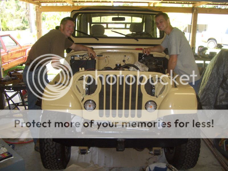

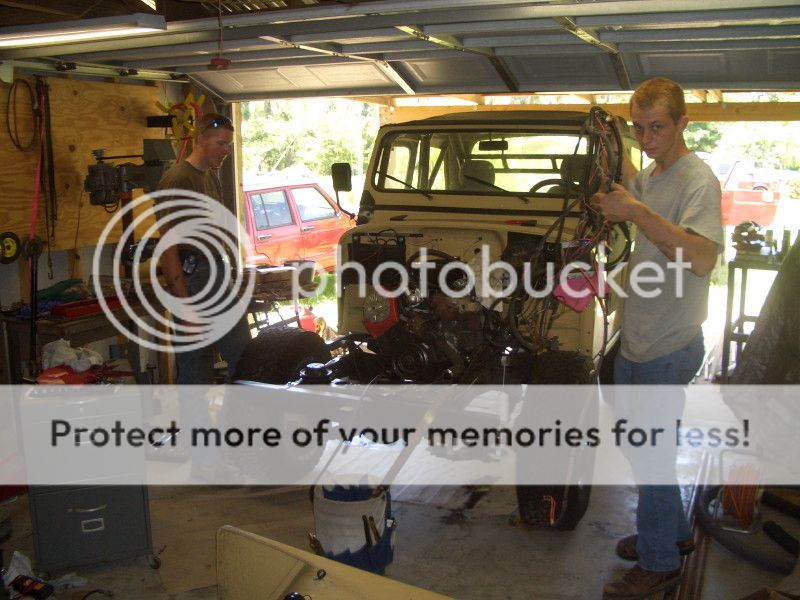

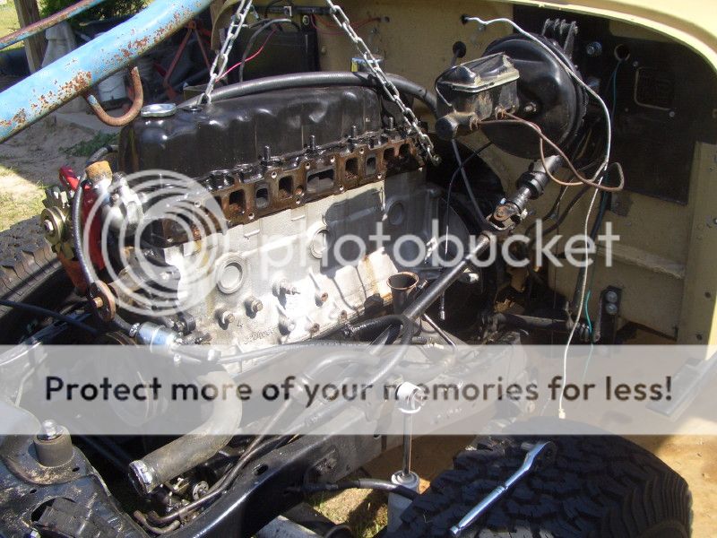

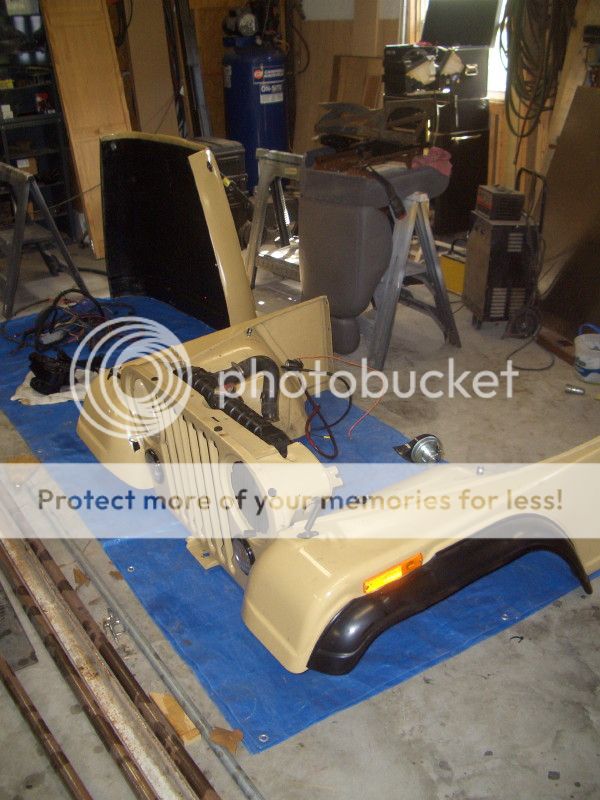

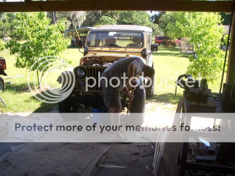

I feel like we are moving forward, finally, on Clay's engine swap. Although I am making the same mistake again, I just don't have the time to do this swap correctly. We should be cranking it up out of the Jeep. We should be installing some new gaskets and checking things like freeze plugs. But I'm told it is a good running engine, so I'm going on faith. The plan is to install it as far as we can then take it to our mechanic to button it up. Here are the pics of today's achievement!
Missing the hood.
Clay digging out the dirt to fit a bucket to catch the coolant.
Clay's buddy Sam is talking to the Jeep, trying to make it cooperate! Sam was excellent help today.
This early in the work, and everybody was feeling good! Sam jumped right in.
Buddies working together.
Clay disemboweling his CJ!

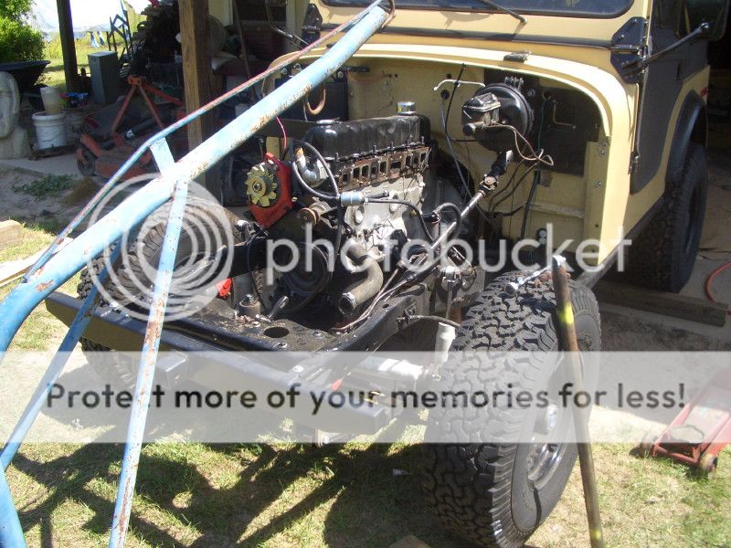

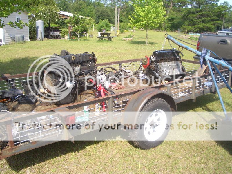

Using my little tractor to hoist the engine.

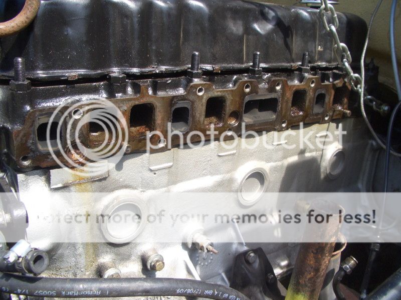

Engine parts removed.
Notice the oil in the exhaust ports!! This engine was blowing oil everywhere. It did not smoke, however. Also, notice the freeze plug. It had been leaking. We would have had to rebuild this engine soon anyway.
Engine is separated.
Once we had everything cut loose it came right out.

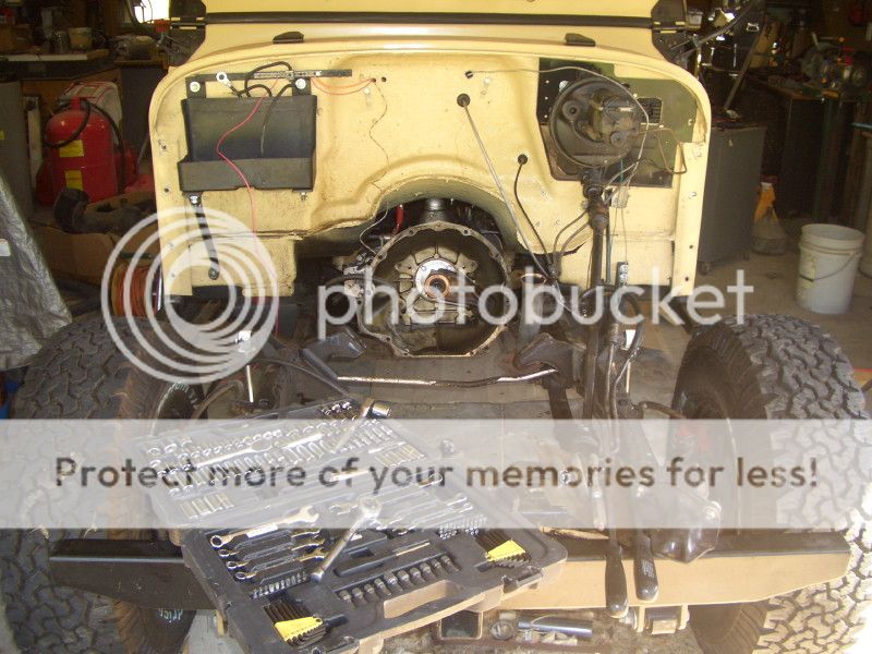

Getting ready to swap components from the 258 to the 4.0. We found Clay's water pump was going out. He is at the parts store right now!

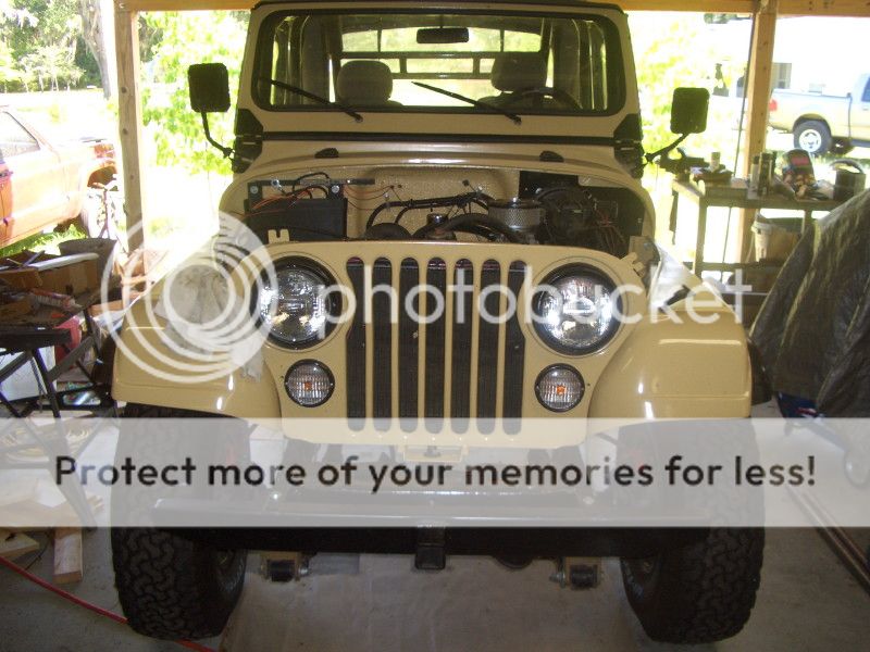

Ugly Jeep! Seems not so long ago that we were at this point.
Shop full of Jeep parts... again!
So we are moving forward, or we have the appearance of moving forward. At least we are working instead of just looking at it everyday!

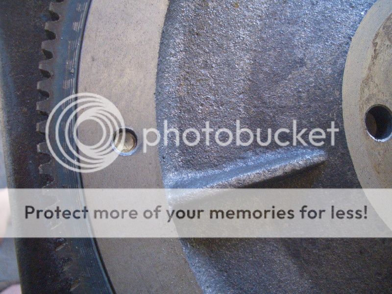

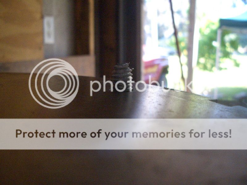

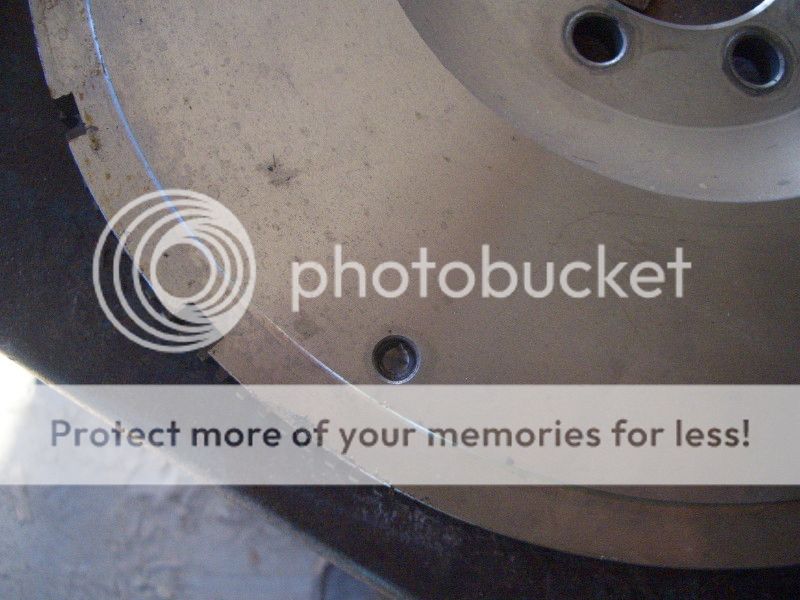

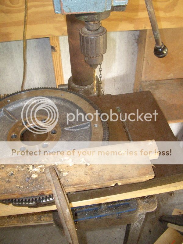

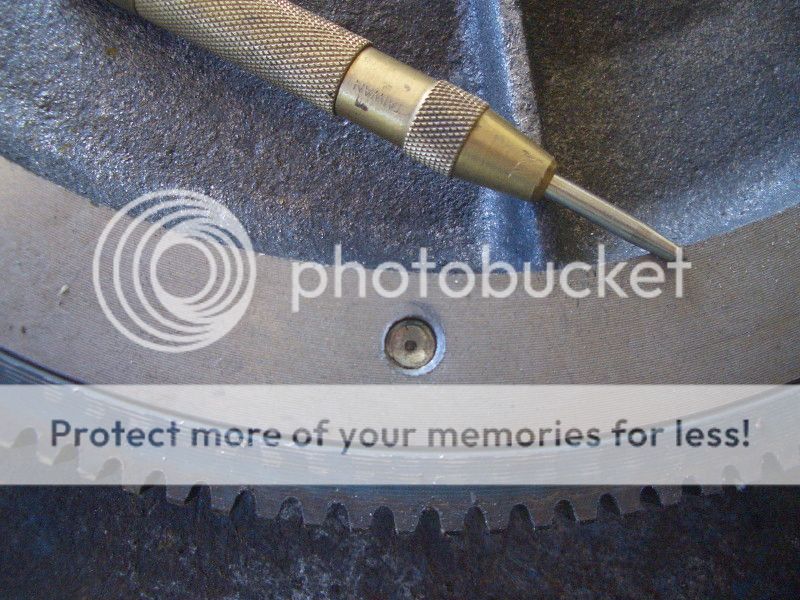

Today, I am working in his stead. Looking back a few days ago, when Clay was attempting to mount up his clutch set and flywheel, he broke off a bolt in the flywheel. Leave it to rookie teenage youthful hardheadedness, and maybe throw in some ignorance and the "I know what I'm doing" attitude! So the Old Man fixed his flywheel. I have to admit that I was comforted by the wise and knowing words of Jim Crabtree, whom I spoke with at length. With confidence, I threw the brand-spanking new flywheel up on the table, eye-balled the center-punch, transferred it to the drillpress, flipped it over and drilled from the back, and the bolt unscrewed itself! HALELEUAH!!! Thank you, Jesus! And Jim!

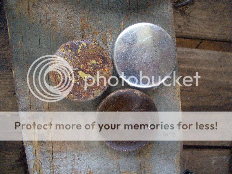

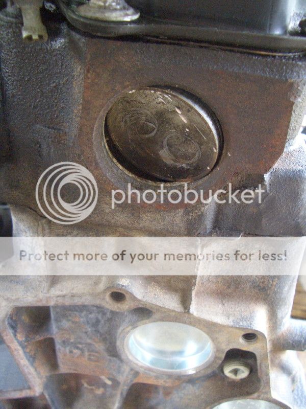

With so much success starting off my day, I decided to change out the rear freeze plugs in the 4.0. One of them had been done, so I thought maybe the others OUGHT to be done. Since these are in the back of the engine, and would be a moderate PITA to change after installation of the ripping 4.0, discretion teased me into making the improvement. So, without further ado... tap one edge of the freeze plug into the block, popping out the opposite edge, and pull it out with pliers. Easy. Schmeezy.
The two "bad" plugs I removed. They aren't so bad afterall. Could have left them there. Might have been the smart thing to do.
Since I bought the WRONG SIZE. Freakin' moron...
