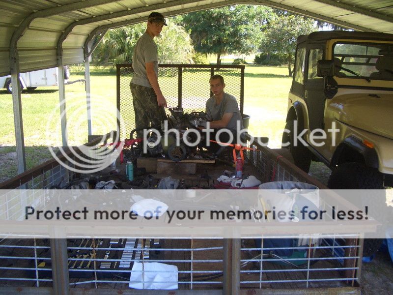

This is Clay's makeshift shop for the while.

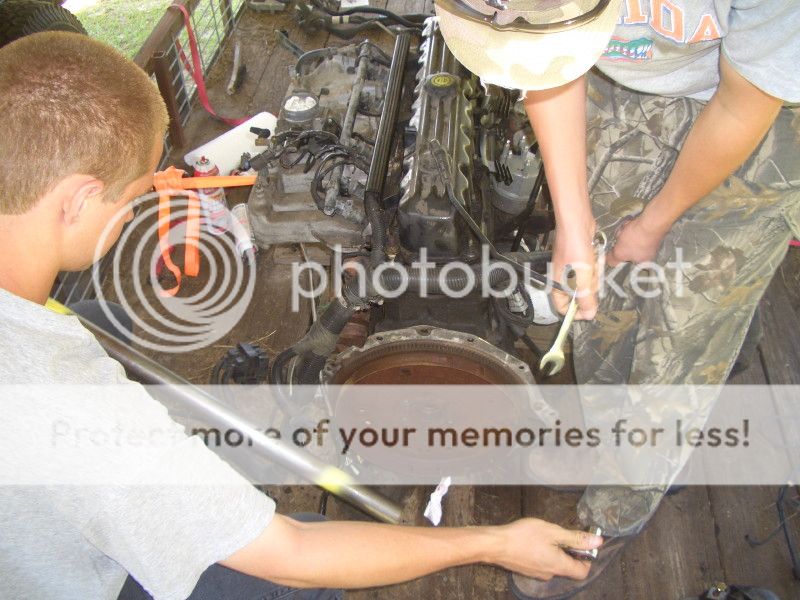

Clay and Fallon pulling the automatic flywheel. I am surprised at how light the metal is... nothing to it, really.

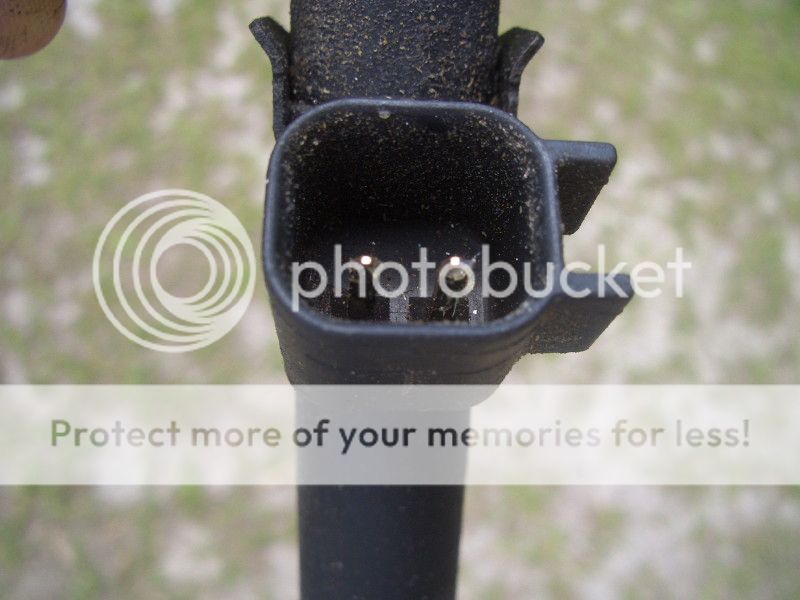

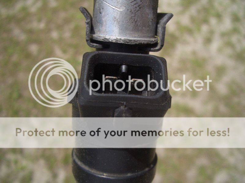

This is an USCAR plug for an OBDII injector. This is the style plug used on all of them post... what...'97? '98?
This is the Minitimer plug, found on all OBDI vehicles. I understand there is some kind of an adapter available to convert USCAR to Minitimer, or vice-versa.

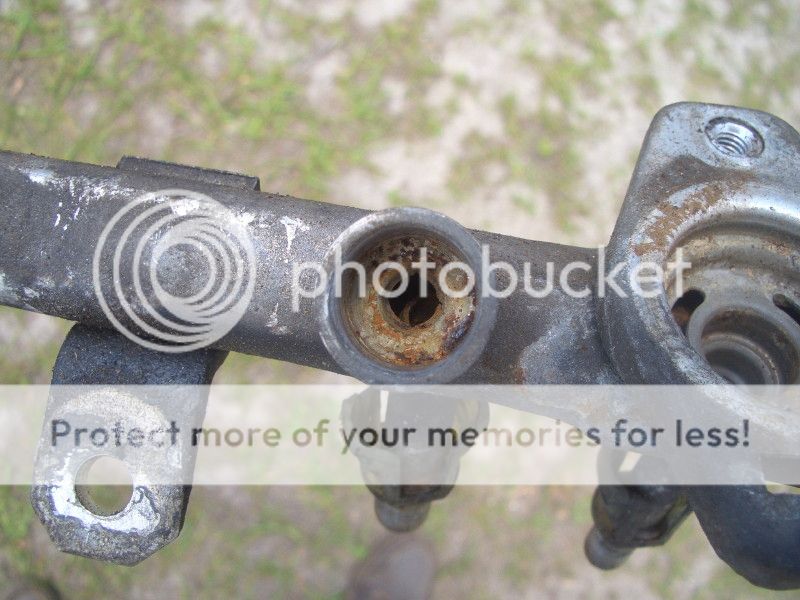

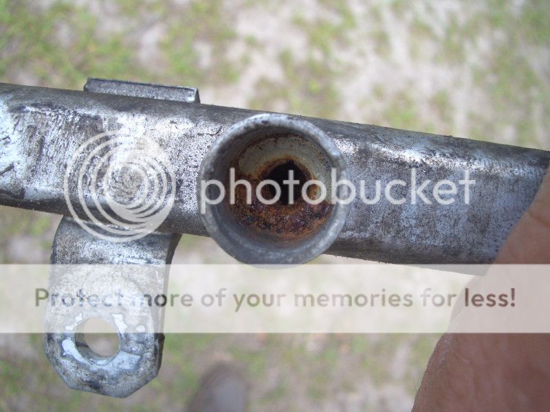

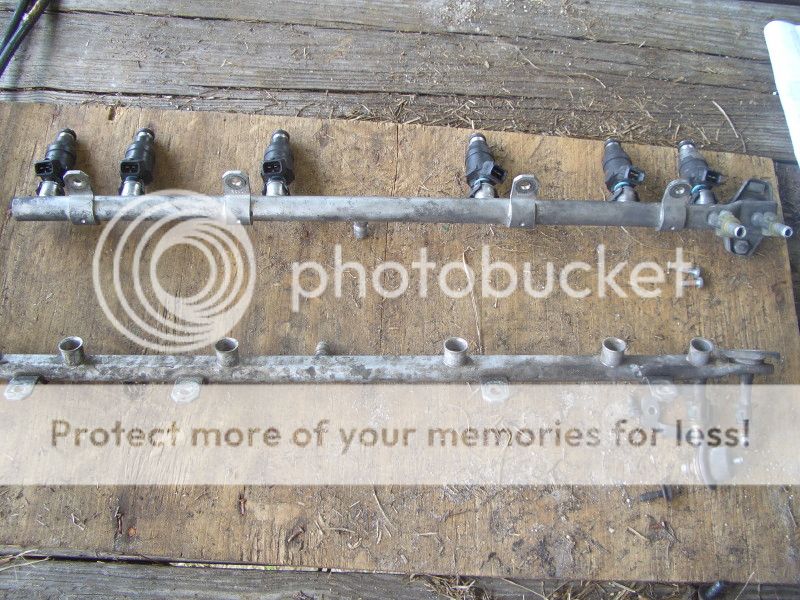

This is an OBDI fuel rail from a 4.0 XJ. It came off a '92 engine. I actually had to drain the gas from it when I removed it. It was still under pressure. I have had it, inside, for less than a year. I got it out to install it on Clay's engine and found it rusted out. I thought it was aluminum.
New fuel rail with factory injectors pulled today, next to bad rail.

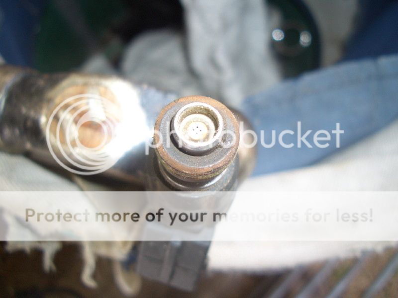

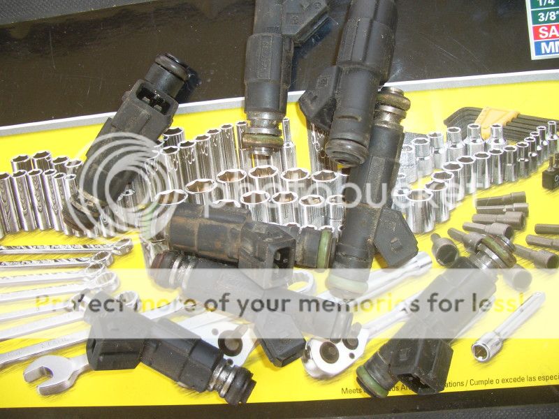

This is a factory 4.0 injector. See the single hole (pintle). There is nothing wrong with this, but there is something better.

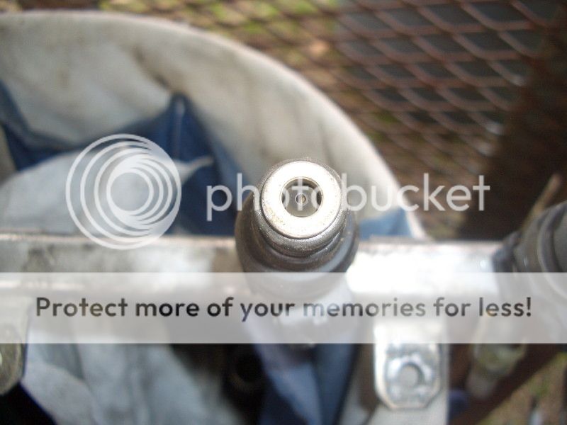

This is an injector from a '92 Dodge/Plymough Neon. Notice the 4 tiny holes. Better atomization, cleaner, more efficient fuel burn = better acceleration and smoother engine. Gotta have a good filter system, though. This delivers the same amount of fuel as the single hole.
The Neon injectors we found.

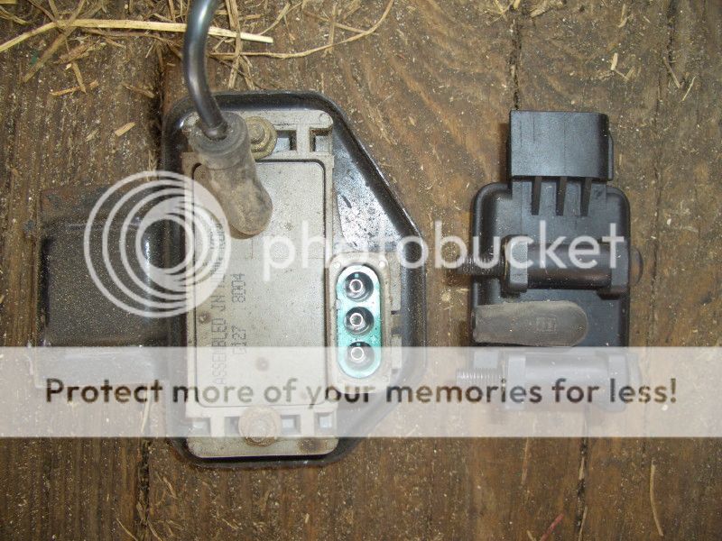

The difference between an OBDI MAP (left) and OBDII MAP (right). I am convinced changes were made in plugs just so the industry would have to buy new parts!?
