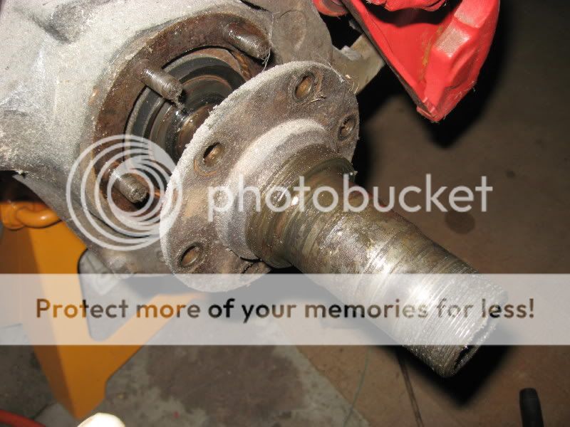

Removing hub.
Only two bolts with washers.
Tap the hub off with a rubber mallet.

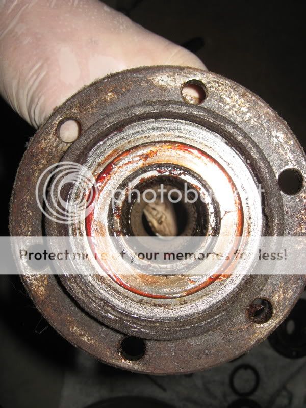

Backside of hub.

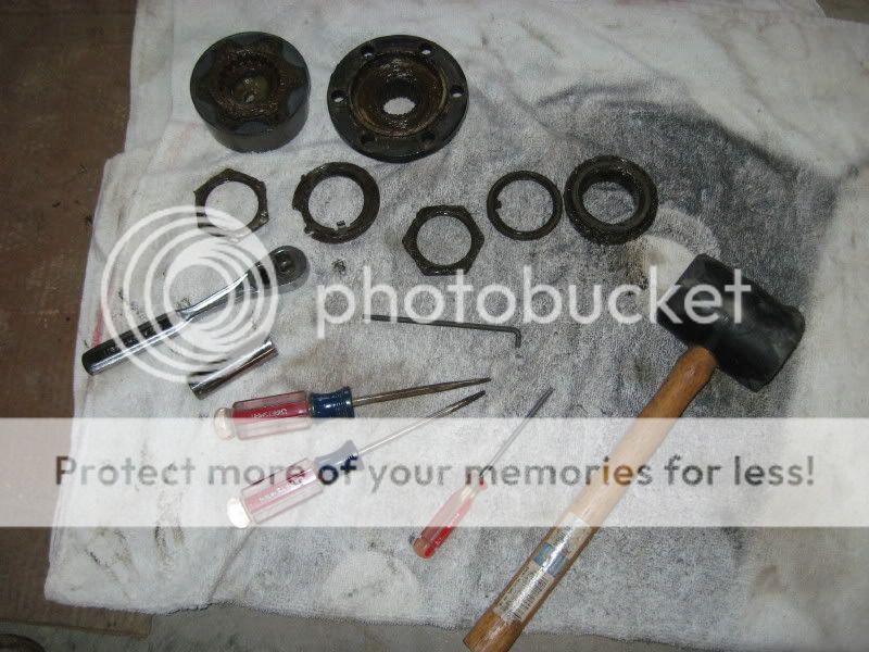

My PO is a real redneck! Axle nut... the first one.
Washer is after the nut.
Another nut! Dang... how many nuts is there!? PO is still a redneck.
This is a secret washer! It's there but hard to see.
There it is... told ya so.
You're looking at the outer wheel bearing.
Wheel bearing removed.

These are the tools I used to get to this point. Not much needed.

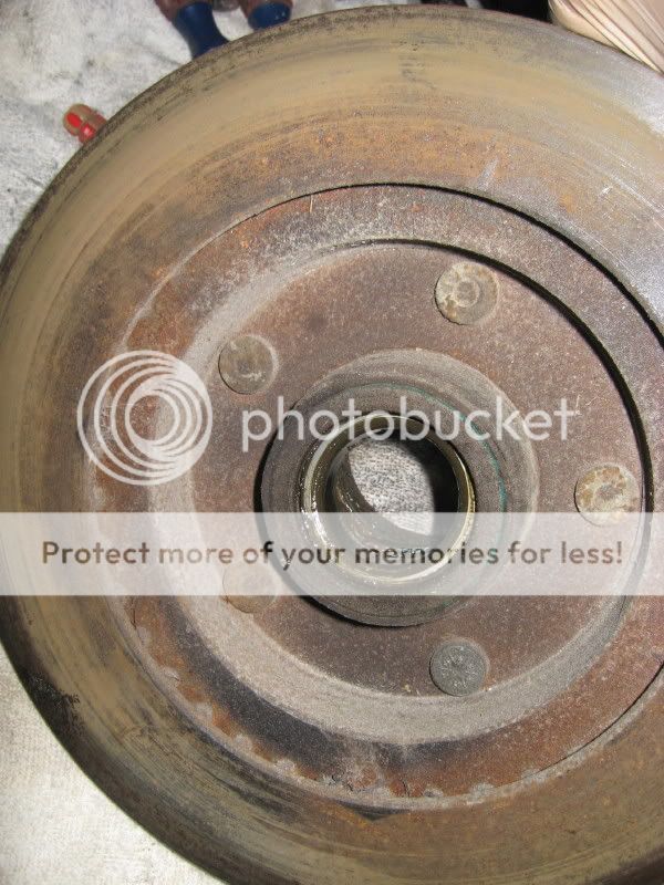

Knocking the retainer clip out of my caliper. Pay attention to how it comes out.

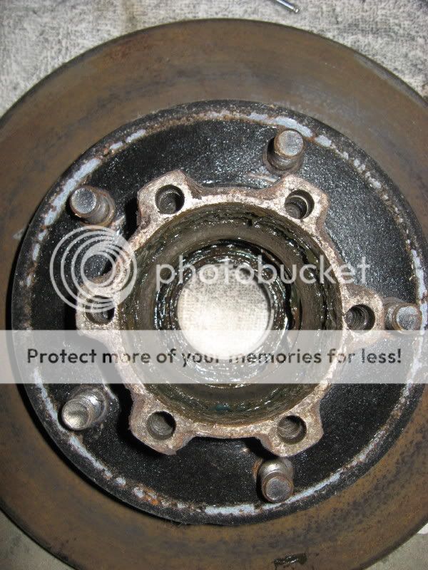

This is the front of the rotor.
This is the backside. You can see the where the studs are pressed into the assembly.

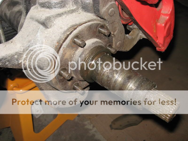

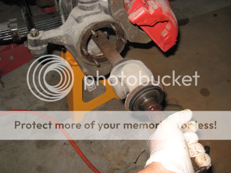

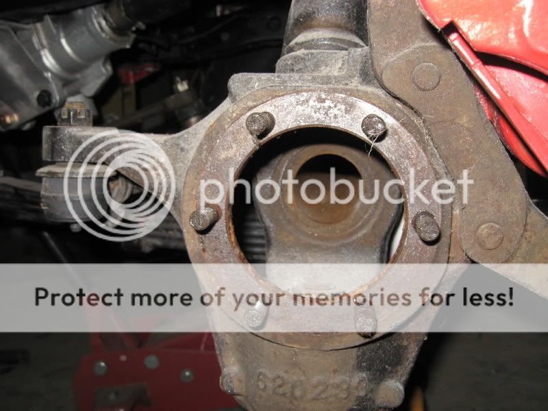

So now I am looking at the spindle.
Remove the bolts and whack it with a rubber mallet.
Whacking and pulling, whacking and pulling...

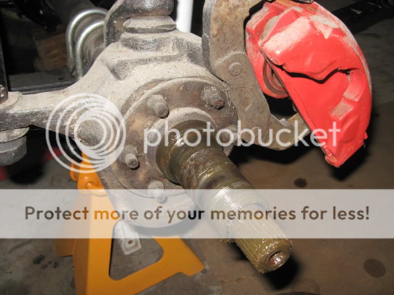

Backside of spindle.

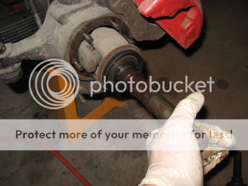

Axle is kind of hanging out, just waiting.
Grab the shaft firmly in your hand and pull.
Pull harder. Easy Big Boys.

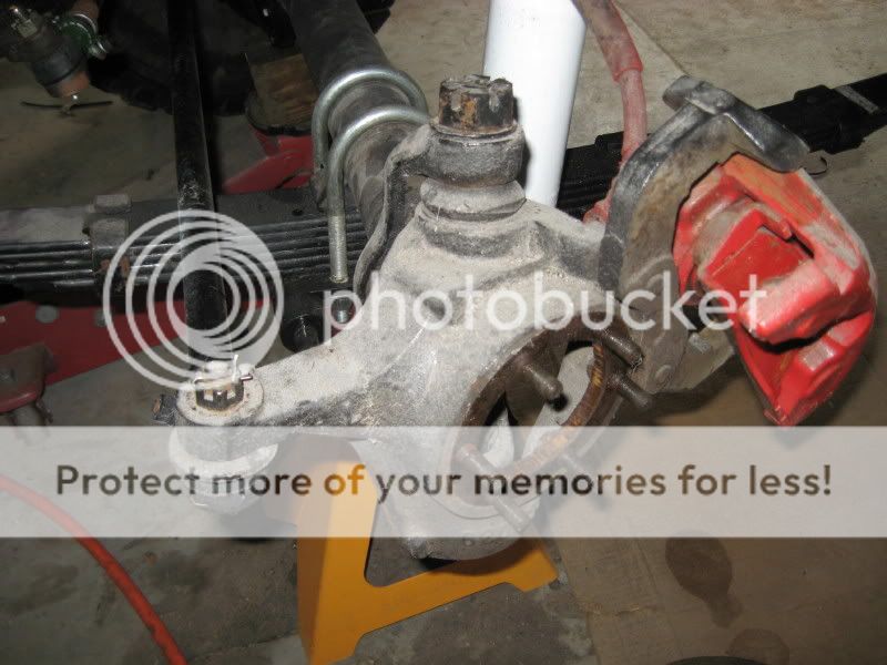

Ahhhh... the empty axle housing.

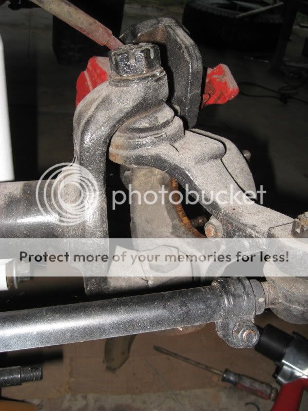

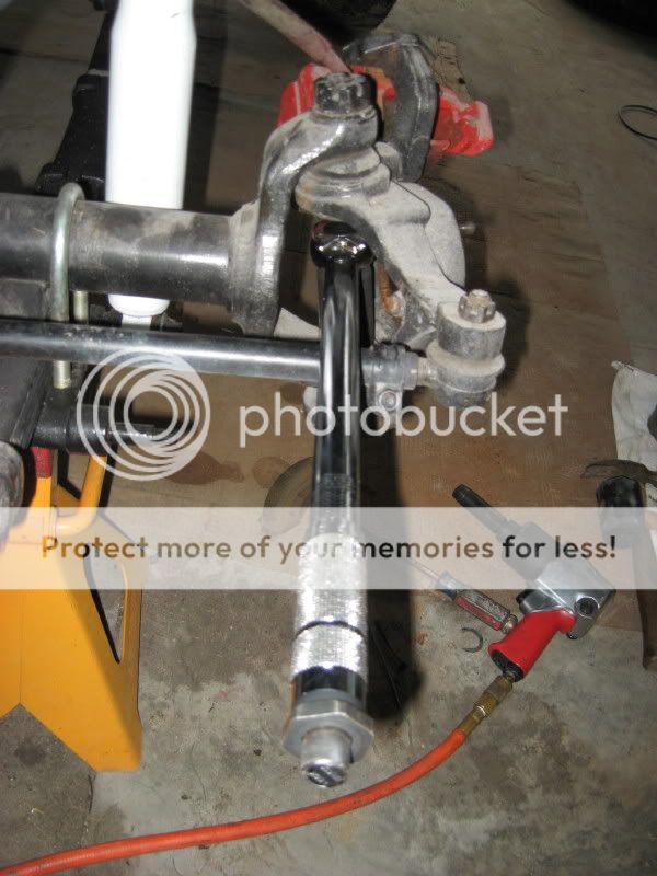

All this work to get to that little bolt. Evidence is clear that you should "do it right the first time"!
Torquing. I got maybe 4-6 turns before I got where it needed to be.
All done. On to the other side. Put it all back together in reverse order.

NOTES*
This is not difficult to do. Simple tools are all that's necessary. You can't mess it up. When you remove the axle nuts and washers, lay them out in the order you removed them.
Everything got cleaned up and regreased. Bearings were re-packed. Everything internal looked very good.
Don't rely on your memory! Do things that need to be done WHEN they need to be done. This could have been a major accident, and I would have caused it.
Tighten bolts in a cross-wise manor. Don't do it radially, like around the clock face. You need to torque everything down as evenly as possible. I think everybody already knows that, but I'm throwing it out there.
