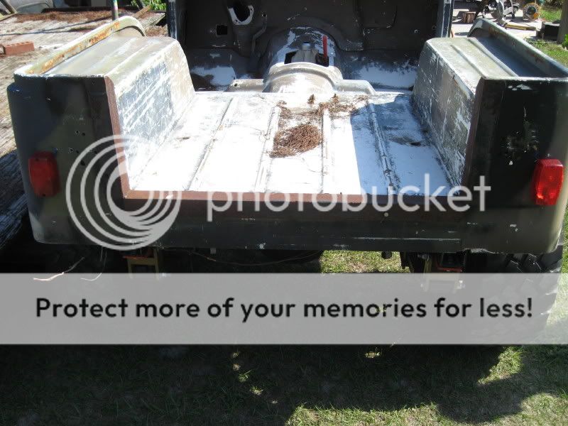

Originally Posted by Skerr View Post
C

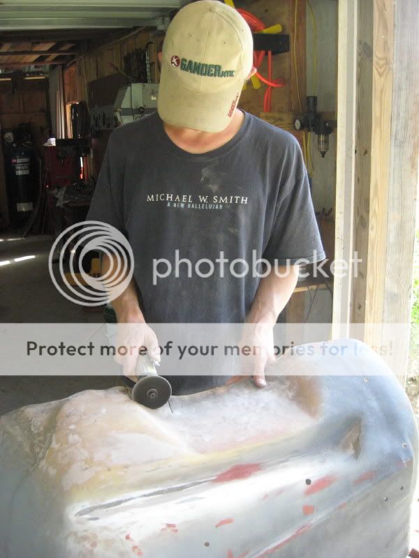

Clay washing the hood.
Sanding the underside with 60 grit.
A wee bit of a scrub bruch. I have a nice, big carwash brush. But, BEHOLD, I have an 18 YO with his own truck! Where is my carwash brush??
Clay removes the screws from his fender mold. How does he sit like that?
Preps for last layer of glass.
Checks his fit.
Applies the resin.
Done! Let it dry.

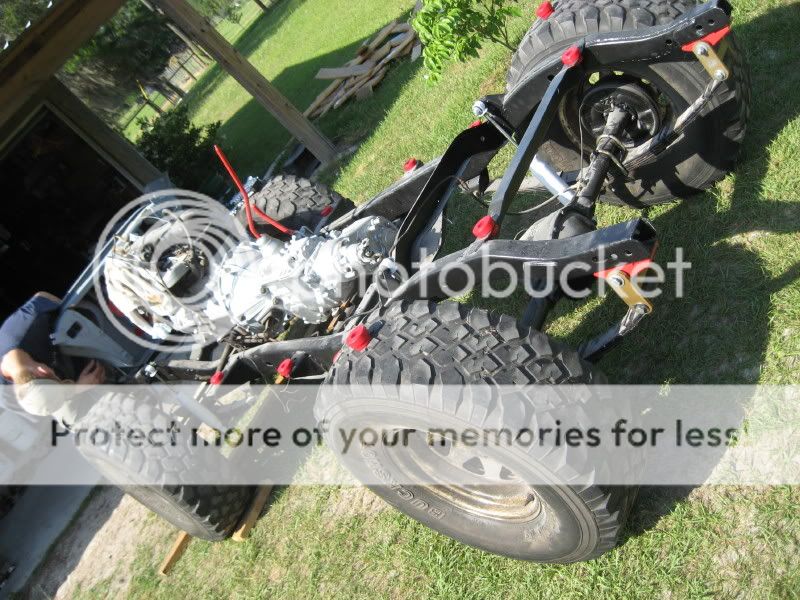

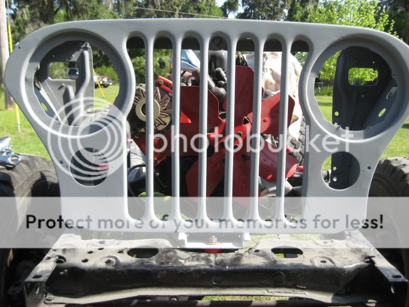

This is the beginning of the tub mock up. This step brings a lot of excitement. Just the grill makes a frame look good!

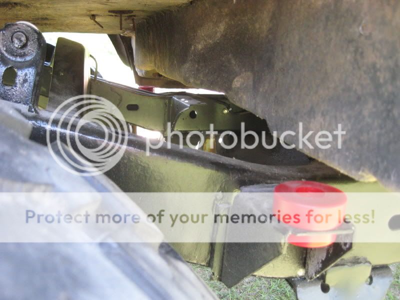

New pucks. Urethane bushings... stock height.
Tub is set on the frame. It is very temporary.
Clay notching the fenders to fit over the shock towers. Thanks to all who responded on my separate thread. I had a hard time coming to grips with cutting what we had rebuilt!
They fit!

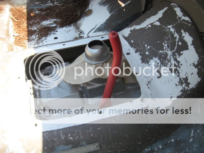

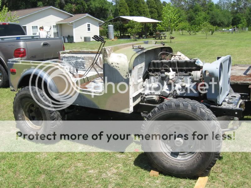

Going to have to notch the transmission well... or whatever you call it. The hole! PO had this thing so jimmied on the frame. We had to remove about an inch and a half so we could slide it back to fit the fenders.
Pucks don't touch! Going to have to build some pads/mounts.
There is something about the front end of a '79 CJ5 that is so tough! I love the front of this Jeep.

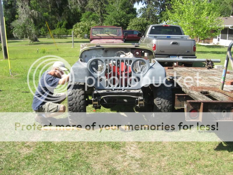

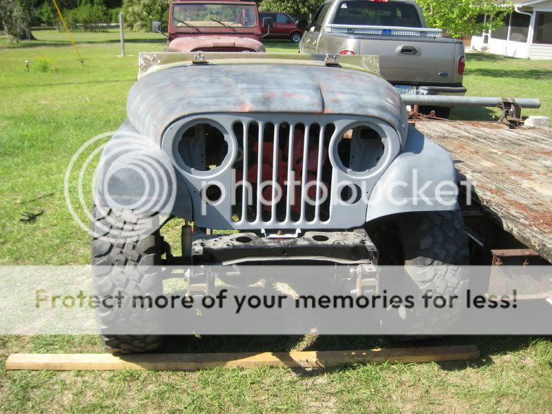

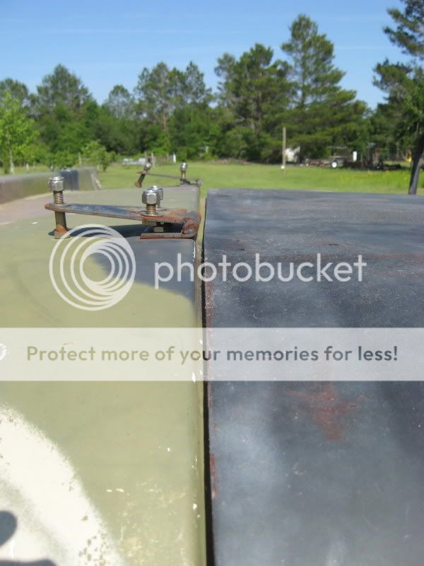

Fitment issues. Using the same holes that the PO drilled. I'm thinking that we may be able to elongate the holes to get the correct fit. Other side is the same. What do ya'll think?

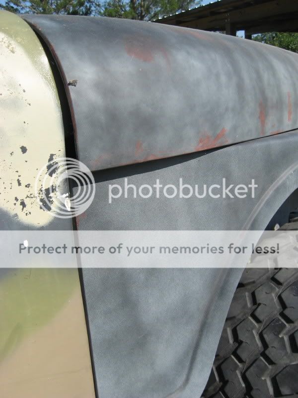

It's almost like the hood is too wide!? Crap! How we gonna fix dat?
Back edge of the hood is not straight. This causes the hood to go to one side. Gonna have to fix dat too!

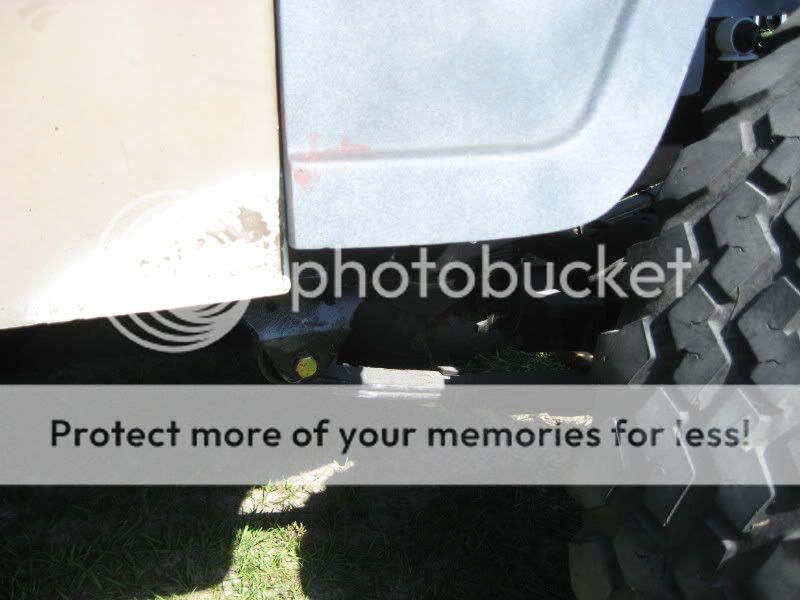

Need to trim off the bottom edge of the tub.

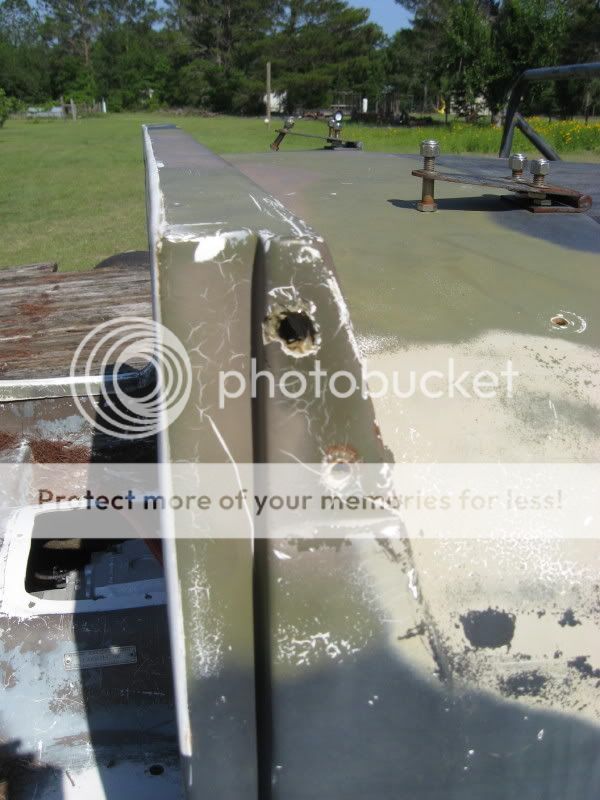

PO holes to fix.

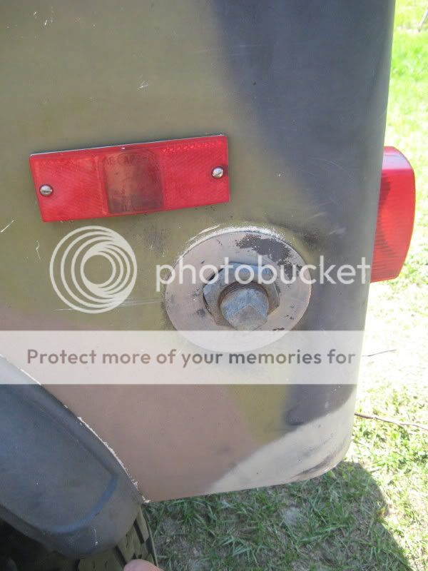

PO gas door!! GAWD!
PO tailgate reinforcement! For PO homemade tailgate.
Compared to my 7. I like this look better!
