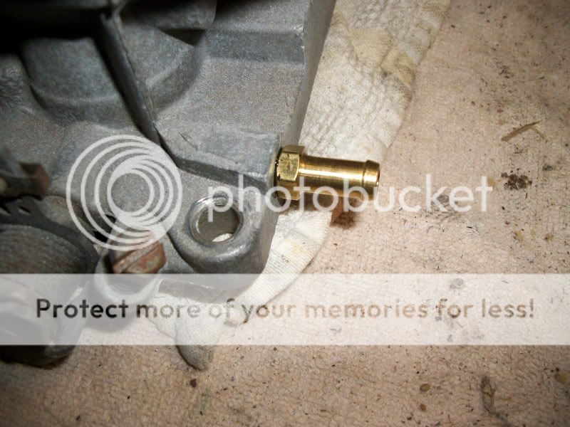

MC2100 Vacuum Port Install
Apparently some MC2100s did not come with a vacuum port on the base. The "mock" hole is there, where a port WOULD have been, but it is not drilled out all the way. This is where I choose to run vacuum for the PCV, so I needed to have a port. I had to drill out the hole, tap it, and install a nipple. This is how I did it. All of you guys that know how to do this... take a nap! Or throw some comments my way.

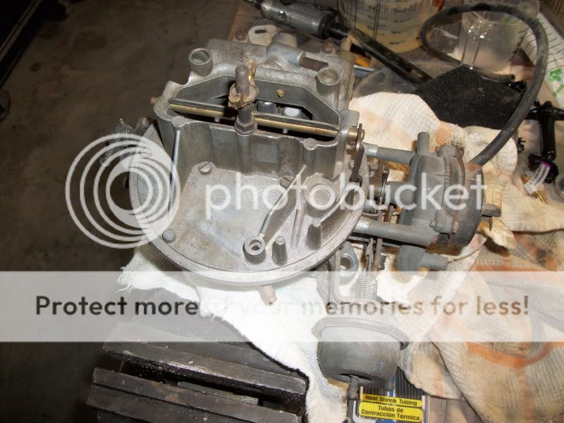

The MC2100 on Clay's 258.

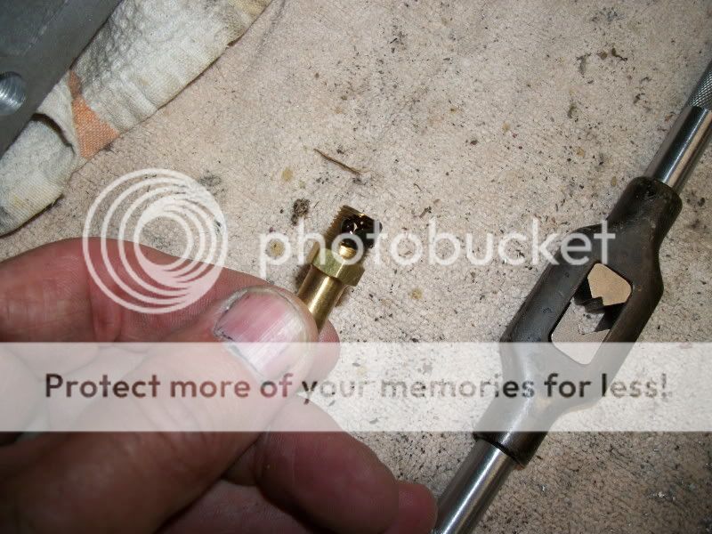

I have already drilled the hole. I didn't think about pics until I was into this process. There was a factory "mock" hole here. The mock hole was machined halfway, I drilled it the rest of the way. I used my hand drill. I selected my drill bit by removing the bit from the case and attempting to thread the nipple into its hole. Or, you can hold the bit and the threaded end of the nipple against each other, drill bit in front, and see if you can see threads on both sides of the bit. When you see just threads, that's the bit you want.

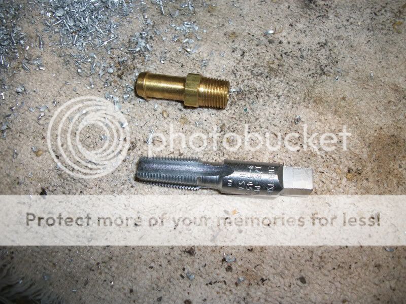

I am using this nipple. It has pipe threads, and it is the same diameter as a 3/8 tap. I am going to cut threads with this 3/8 pipe tap. A pipe tap is tapered as you can see in the pic.

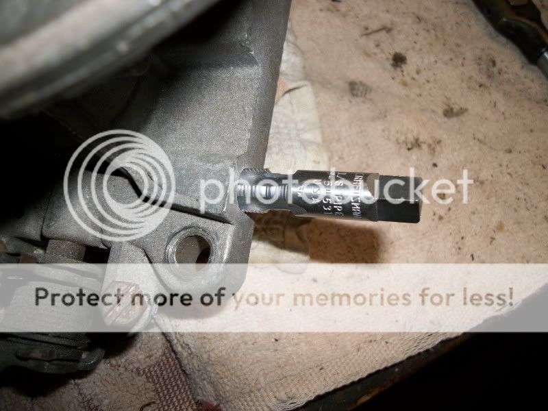

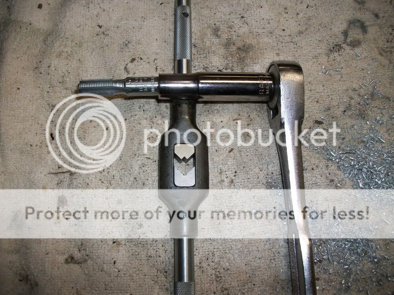

My T-Handle won't fit in this application, so I am using a 3/8 ratchet with socket to drive the tap.
Don't go plowing in there thinking "this is easy"! It IS easy, but you can go too far with a pipe tap. You need to cut a few threads and pull it out, test fit the nipple. Do that over and over until you have the proper depth. The carb base is aluminum, so the threads cut easily. If you go too far you'll end up with the nipple going all the way through the hole!

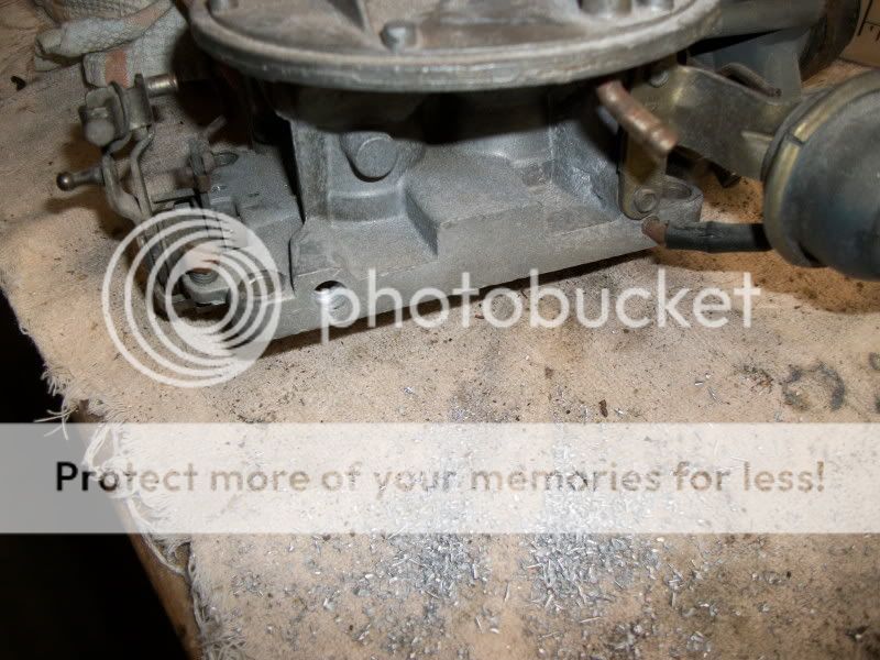

I placed a little dollop of Form-A-Gasket non-hardening sealant on the threads. I want to make sure I don't have a vacuum leak.
All done and snugged down. DON'T OVER-TIGHTEN! You'll strip the aluminum threads. Gentle now...

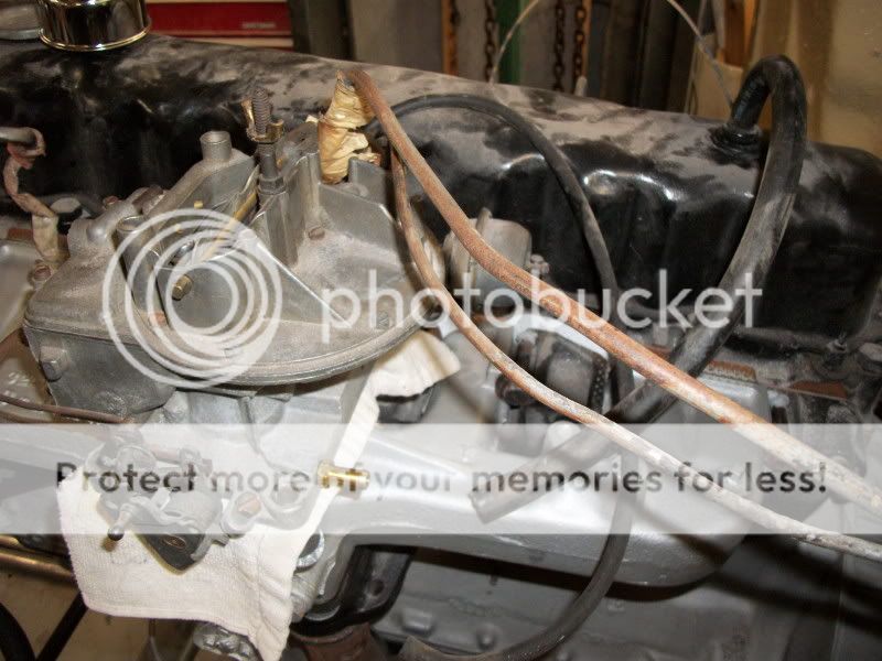

Carb mocked up and the PCV can be easily attached (once I get enough tubing).
