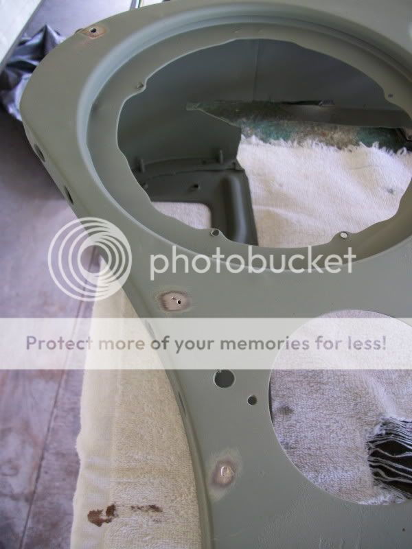

Found these holes when I sandblasted this time. I don't remember them when I sandblasted last time! Clay welded them all closed. he did a great job.

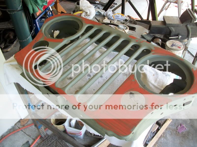

After welding, skimmed with glaze. I have done this twice now. The finish isn't as good as I did the first time, but this time it should stick! Paint tomorrow...

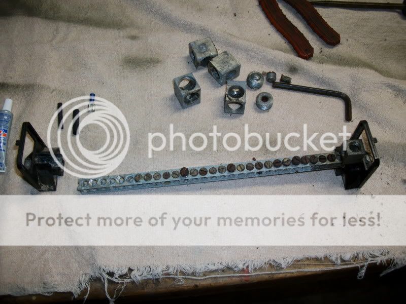

Grounding buss I took out of an old breaker panel. It is a big one so I cut it in two pieces. A short piece for the back end, and a long piece for the front. I am cleaning it up.

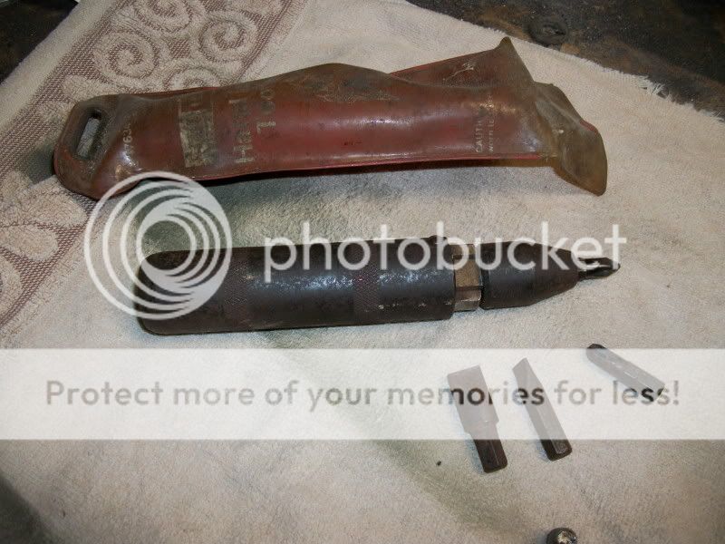

This is a tool that you should have in your box. This is an impact driver. A MUST have tool for stuck screws.

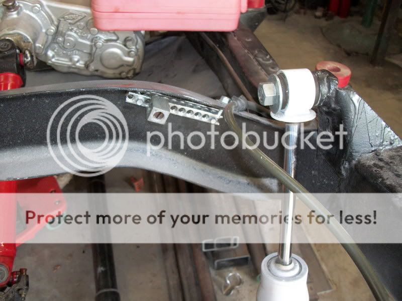

Ground buss for back of Jeep. This will catch all the rear lighting, gas tank, etc. The large lug will be for the main ground. It will go to the front.

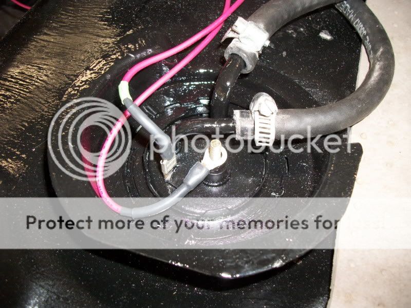

Wiring for fuel sender. I am going to be one of those POs that wires everything with the same color wire!! I don't plan to sell, so it shouldn't be a problem. Tank is repainted, wiring has dielectric grease and heat shrink.

The ground buss is a great idea Scott.
I have one of those hammer powered impacts, the work great in many situations.

Lookin' good, Scott. Nice wiring job, too! It always pays to do it right!
You sure you thought this one through Scott? Any troubleshooting down the road you will be mad at yourself when you are trying to trace wires. Actually, Clay will be mad at you.
hee hee hee... Daddy's revenge! I'm using colored tape at the ends to ID each wire.

Nice idea on the grounding bar Scott. Something you could do to make it even better is to use a rubber gasket bewteen it and the frame. Anytime steel and aluminum contact each other corrosion starts between them, it's a chemical reaction, and that will migrate over the buss bar in time causing your grounds to be less affective or even quit working. Do the same with the bolts that hold it to the frame too, make washers out of hard plastic or rubber to eliminate the metal to aluminum contact. Folks with aluminum tubs face this issue all the time and that's what they do to curb the problem.

Thanks, Jim... God Bless, Bro...

Grill is done. No runs. Came out pretty good. How long does it have to cure before I can put everything together?? I'm impatient that way...

Give it 4 hours so you will have to flip your hour glass over 4 times.
Lookin good brotha! Are you using single stage, or base/clear? Can't remember!

I know you ain't gonna bleve dis George-o... but I'm FAR more sofistikated than you are! My howr glas is motorised!! And my squaw does the labor aroun heer. Thanks for the 4 hour tip. It will sleep in the living room tonight... with the hood, fenders, and WS frame!

Single stage but in satin. I didn't want shiny military spec paint. Know whut I mean Vern? You are my benchmark... whether you want to be or not. Trying hard to keep up with pman!
