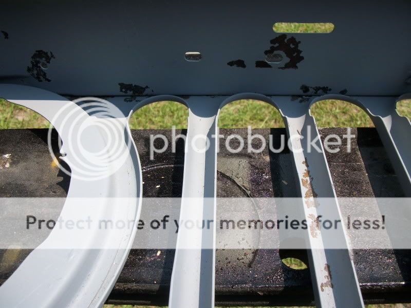

This is my problem. We sandblasted this grill and painted with 2K primer (which is also called High-Build or High-Solids or Sandable Primer). It came out great. If you have been following this build you will maybe remember this. The primer blew off with the air hose when I was getting ready to paint the grill. OOPS!
So I called Richardson's (our local automotive paint supplier) and asked "WHY!?" He said you can't spray 2K primer on bare metal... ain't nothing for it to stick too! And we had sandblasted it clean. Said we should have used Self-Etching Primer. So that's what it gets this time around.
In the end, it was a good thing I redid the grill. Little rust pockets were popping up here and there. Someone said that a pressurized blaster is better than a gravity feed. You know what I think about that comment... Right On!!
Filler is from previous work that I did. I didn't want to do THAT again, but I guess it's fate! Clay has pulled the gas tank and is touching up areas that got scratched up. 3B gave up Clay's tires, and I started blasting his rims. Man, is it hot.

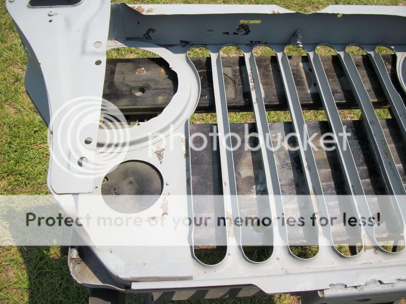

Front of grill in self etch. I will have to finish it out again. I won't make as big an effort this time, though. There is a small hole that needs welding up. A little filler. A little sanding. Done.
