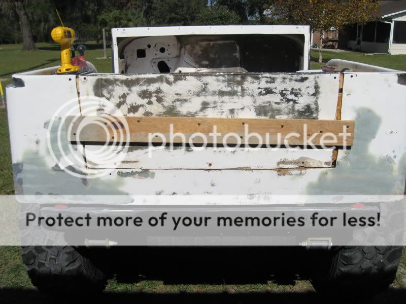

Got LOTS done today, and I'm feeling good! Here's pics of my progress. Enjoy...

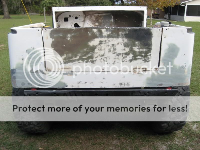

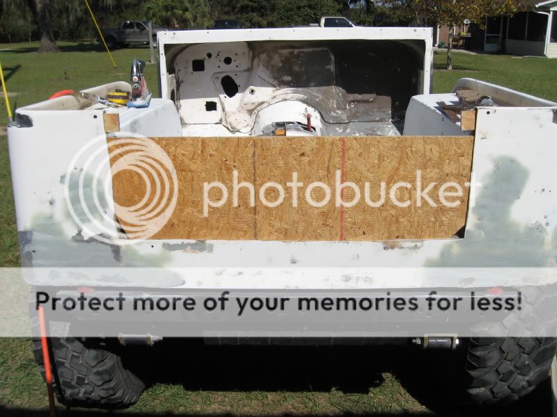

It's not really a tailgate. It's the piece the PO had cut out and used as a tailgate. I'm putting it back in solid. Here it is sitting in place.

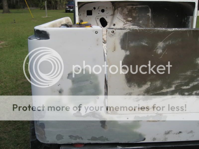

Gaps on the sides.

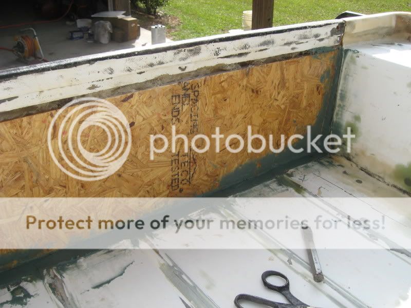

Cut some blocks to help hold the gate in place.

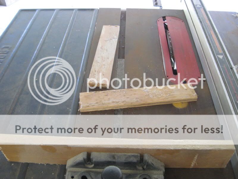

Correct size for what I need...

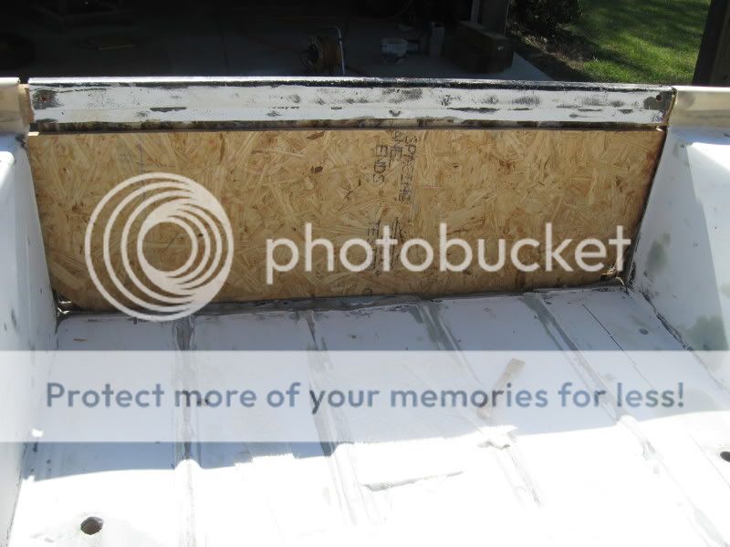

Blocks installed in tub rails. They will help hold the gate in place and create some rigidity.
Tailgate hung on the blocks. Lines up pretty good.

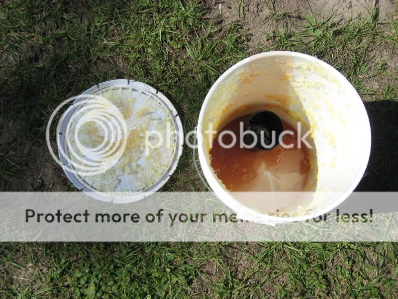

Bulk resin is toast!! Dang...

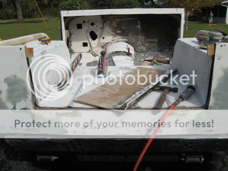

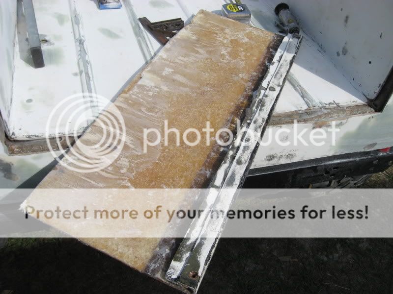

I will attach some glass strips to this side of the tailgate panel. These strips will help make a bond between the gate and the board. I couldn't really show the steps, and I couldn't build it on the ground and install it. It had to be built in place. So use your imagination and you will understand!

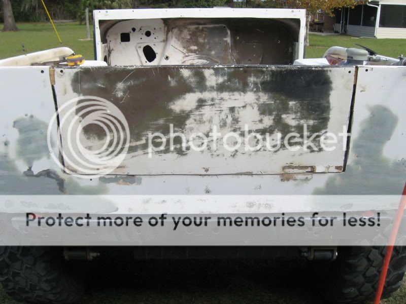

Wood blank installed. It overlaps the sides and recesses at the bottom. This will create rigidity. The gate will be set in place and everything screwed together so there is good contact.
The glass strips are between the board and the gate panel. I screwed it together for contact.

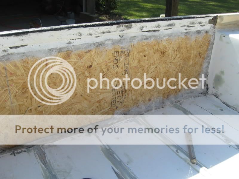

Inside view. I swear I measured that board so there would be no top gap!?
Using glass fibers to fill voids. Just pull it apart and stick in the cracks. Dab the resin in there good.
Using ProGlas to fill the voids.
Once the filler is done I will use glass strips to form the angles in the corners. Should come together pretty well. I know you'd need a sledgehammer to get it out!
