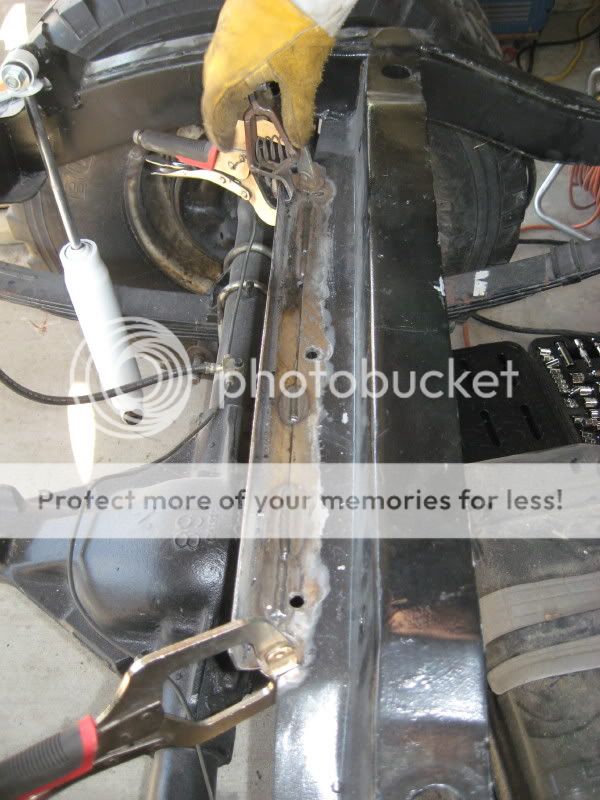

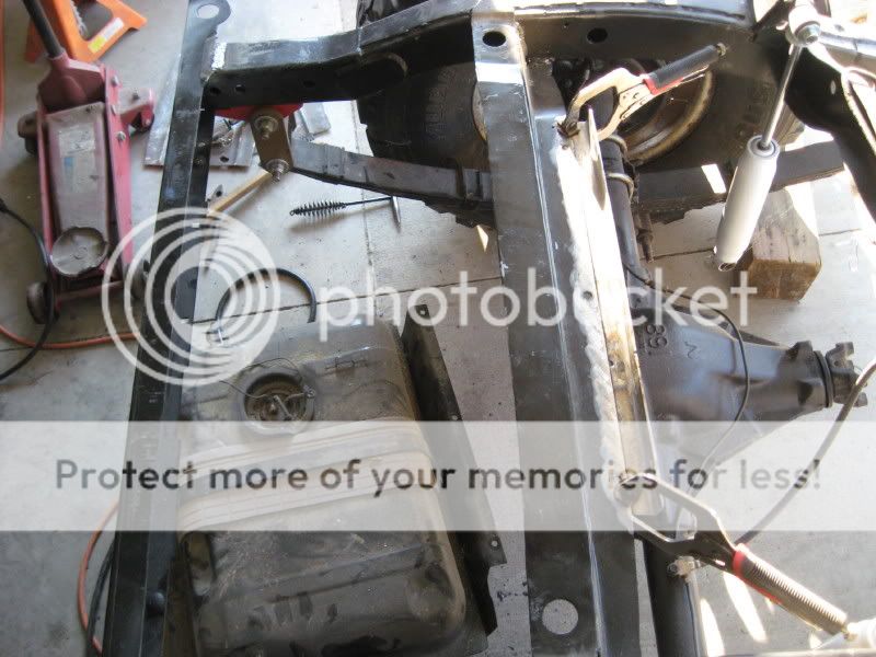

Okay... the only really good thing that happened to the Jeep today! Clay truly enjoys the welding/metal work, and it's a significant feeling to watch my son understand and act on his own. I mean, that's what we're training our children for... right? At one point, he came over and gave me a tip on how to do the glass!! G-r-e-a-t! We pmocked up the gas tank and skid only to find that the arch support, where the front of the skid mounts, didn't match up. That HAS to be because we didn't get the crossmember in the correct spot. But the tub mocked up well, so it is what it is! So Clay set about extending the lip of the arch support. We will drill mounting holes in it to match those on the skid, and we'll add some straps to the new bracket to make sure it doesn't bend from the weight of a full tank. Here is Superstar Clay...
Finished weld on the rear crossmember. Clay is using 1/8 6013 rods (rusty rods to boot) for his welds today.
Here is the bracket he made out of some angle we had in the shop.
Pretty cool...!
Clay's beads as he skips around on the bracket.

Clay nice job. As usuall too . Did you take the shackle hangers off and weld across the bottom too? I have a suggestion in regard to the angle iron that you added to the crossmember. Right now you got a seam welded and it looks great but that's not as strong as it could be. If you'd weld some straps across the seam it would be a big help. Maybe some more of that same angle iron or flat stock that's about 1/4" thick x 1" wide. Here's your picture with the additional bracing outlined in red. I'd put at least three on there.
Great idea, Jim. Much better than what I had suggested to Clay. I know he'll be glad to go burn some more rods!
