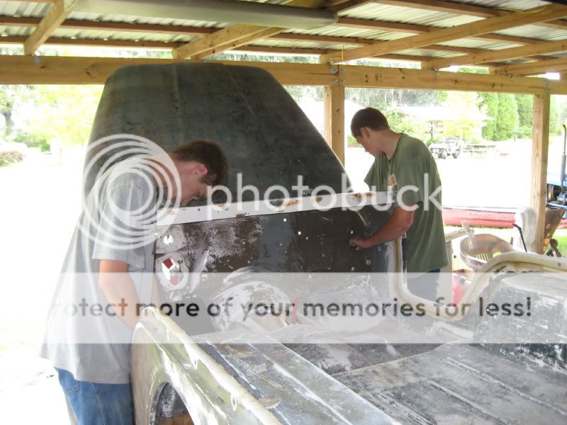

We pulled my 7 out of the barn. We rolled Clay's 5 out into the sun (it was hot and muggy). We got to work. Then it started to rain, like, out of nowhere! I don't like my stuff to get wet so I was hustling to get Jeeps back in the barn. We shoved Clay's Jeep under the lean-to, and I forgot to put the hood down!! The hood caught on the top plate of the bay. I had a wooden dowel propping open the hood, so it couldn't close!! Since the tub isn't bolted down it knocked the whole dang tub off the mounts, off the crossmember, etc. Everything had shifted significantly!! So we had to start over. If you have ever labored over getting your tub exactly right, then you know how much this killed me! I think we got it back where it needs to be. Here are a few pics of today's events. It is so hot, so humid, and drizzly that the day is busted! Might as well go take a nap!

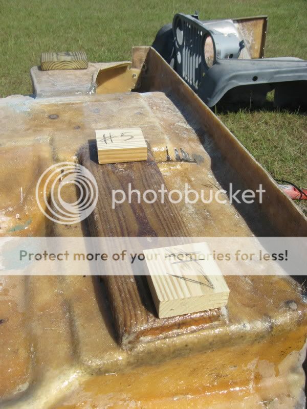

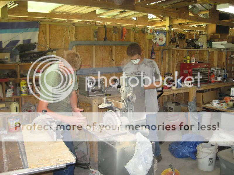

Clay's friend Samuel test fitting a wooden block.
Clay and Samuel sanding down some blocks to fit.

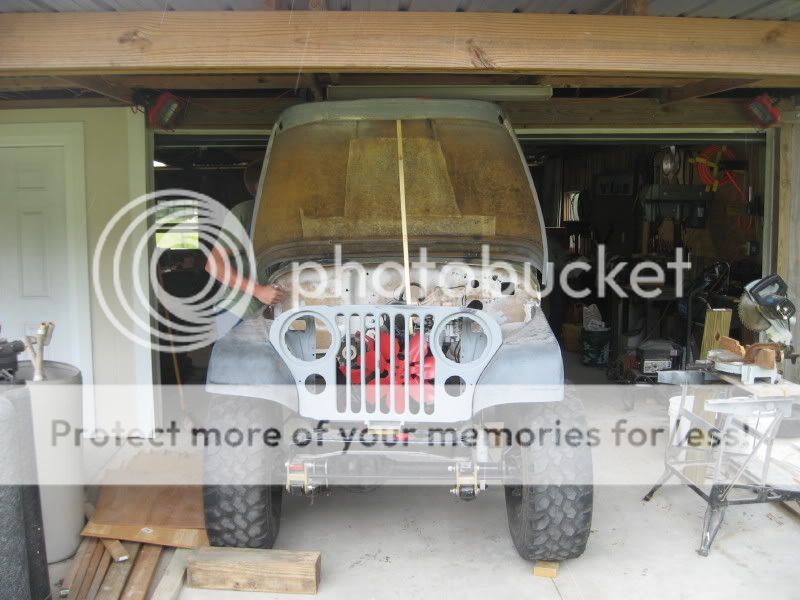

Doofus dad forgot to put the hood down, and it hit on the top plate. You should have heard the crunching sound! We didn't find anything broken however. This is while we were setting it back up.
Tightening down the fenders.

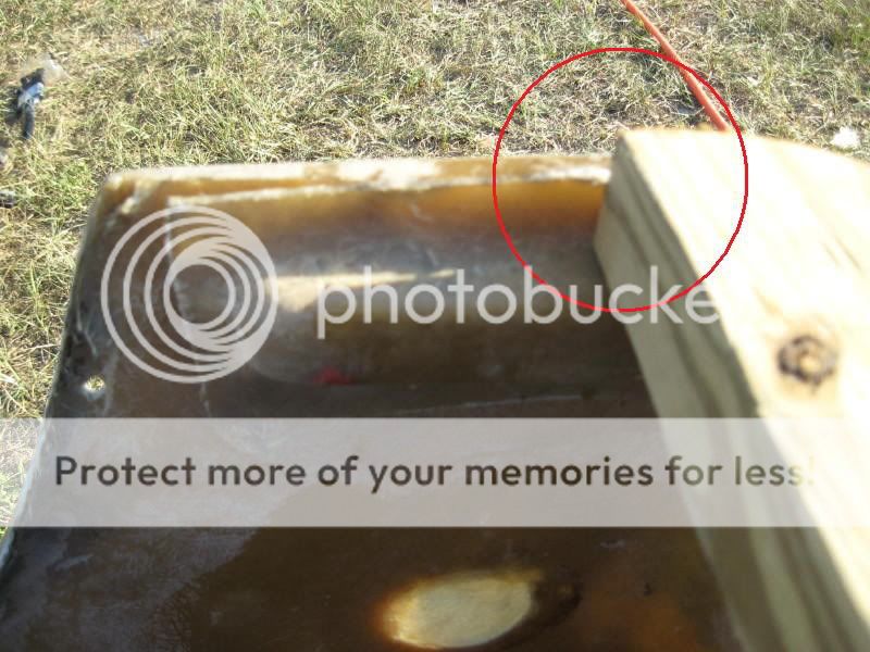

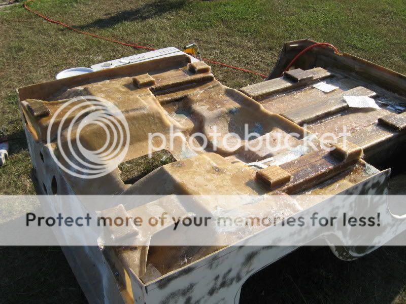

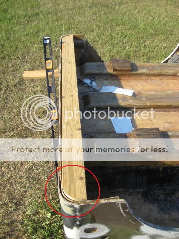

Several things going on today, but Clay is the only one who had is act together! Clay was welding, which I'll post up in a minute, but first, the problem I am having with some glass work. I need your input whether I should do this glass work or not. Is it needed? Bill (lucdog) posted up pics of metal straps for bracing for the rear/crossmember tub mounts. I am trying to use some wood glassed in to create a mounting surface for the pucks located at the rear crossmember. In the end, I threw everything on the ground, and in total disgust, came in the house! So... without further adieu...
This is a pic of the underside of the tub. There is a factory rib to strengthen the back. I THINK the rib has these t*ts to create a surface for the pucks to rest on, but they don't match up to anything. So I have to make/do something.

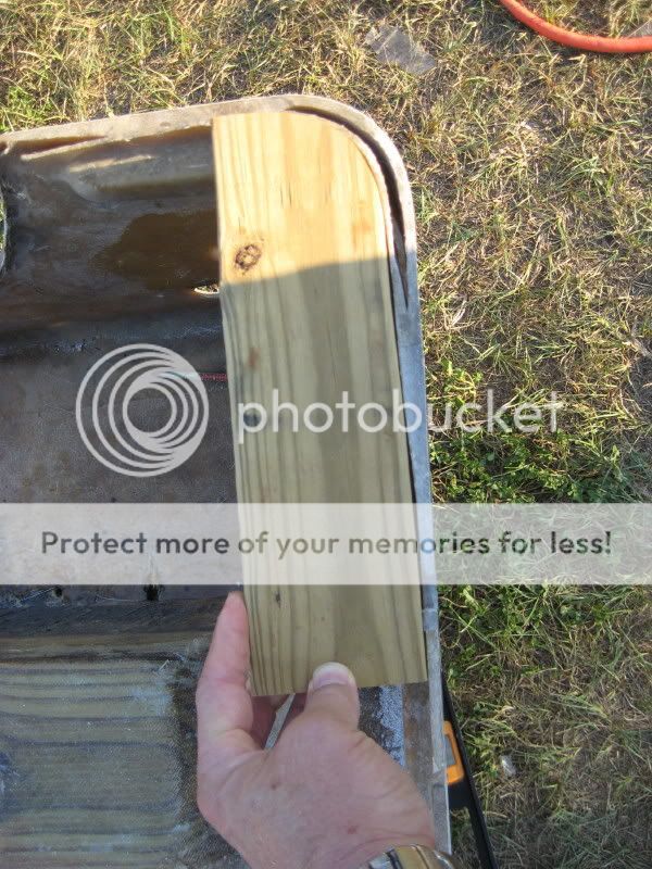

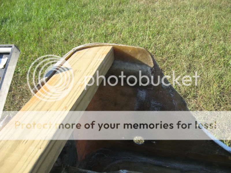

I cut this PT 2X4 to fill along the entire width of the tub. It would rest against the rib. I figured it would strengthen the back of the tub, make it more rigid. And it would make a nice mounting surface for the pucks.
The rib was not evenly installed from the factory, and you can see that one end causes the board to extend beyond the edge of the tub.
The other end looks pretty good.

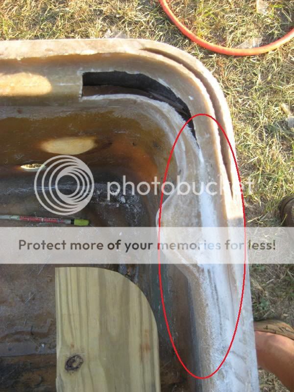

So I removed some glass to make the 2X sit lower, and that worked, but I have to remove quite a bit more to get it right. My problem today is that I really don't want to have glass dust all over me!
So because of the relationship between the rib and the board, I cut the board into blocks thinking it would be easier to work with. I am contemplating just glassing in the blocks at the corners. I am concerned that glass won't be strong enough to hold the blocks against the weight of the tub, and that in time, the glass will crack around the blocks. It will have the narrow edge of the block against the tub, and the puck would create leverage against the glass seam. Would it hold? Am I thinking right? Wrong? What do you guys recommend???? The other concern is the amount of filler work that will be needed to blend the glass that overlaps the exterior surface of the tub.
For now I am done with it! I lay in bed thinking about what I have to do, and I think about how easy it will be to complete, and then we can paint the bottom of the tub and concentrate on the inside, but karma is killing me today!

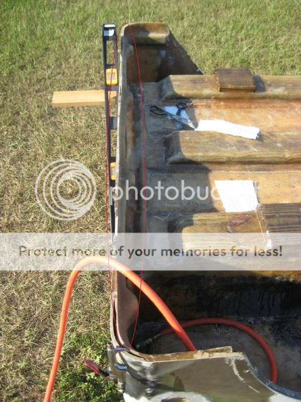

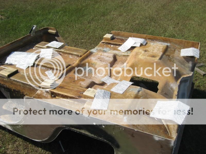

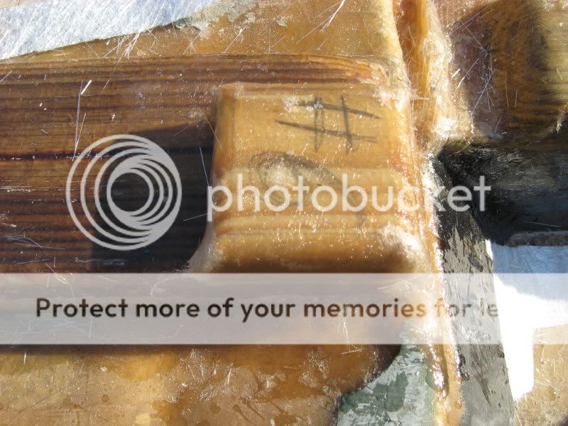

Here is my work on all the blocks the I glassed into place. These blocks are at each puck. In light of all the other glass work we did, once we mocked the tub on the frame, not all of the pucks made contact with the tub. So we custom cut some blocks for each mounting area, shaving some of them to the correct thickness so we had consistent contact at each puck. I ronically, and without meaning to do it, we have created a body lift on the this dad-blamed Jeep, which isn't necessarily a bad thing, but we don't know how much it is!! I'm guessing an inch and a half.
The custom blocks are in place.
The precut glass was sitting on top of each block so I could zip through the resin process, and a gust of wind came up and blew them all over the place... adding to my diminshing attitude!
Glassing the blcoks in...
My crappy work! I didn't have my heart in it. Still, the blocks just need to stay there. They don't have to waterproof as they are PT. I'll clean them up with the DA and maybe, MAYBE add a little more glass. These things were a PITA, and I shold have put a 45* bevel on each side.
