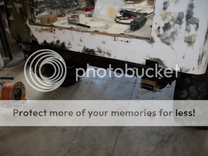

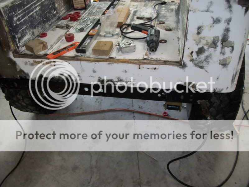

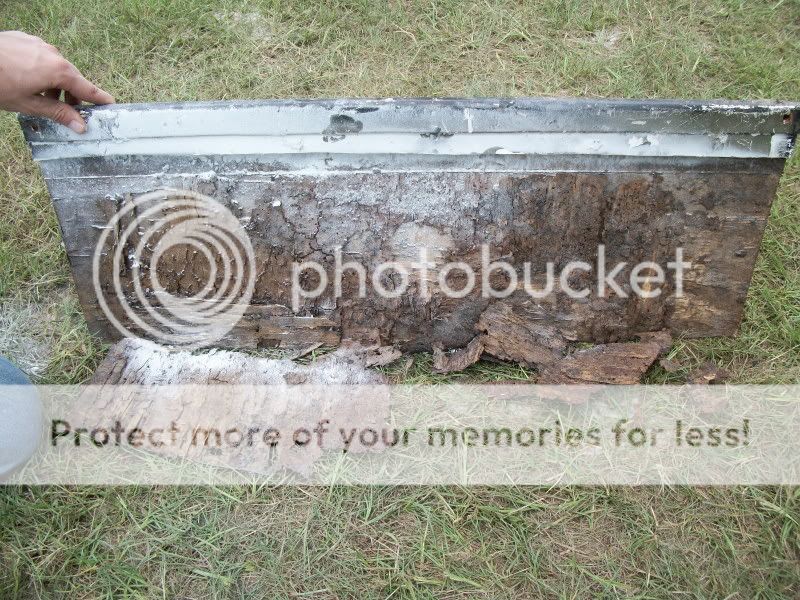

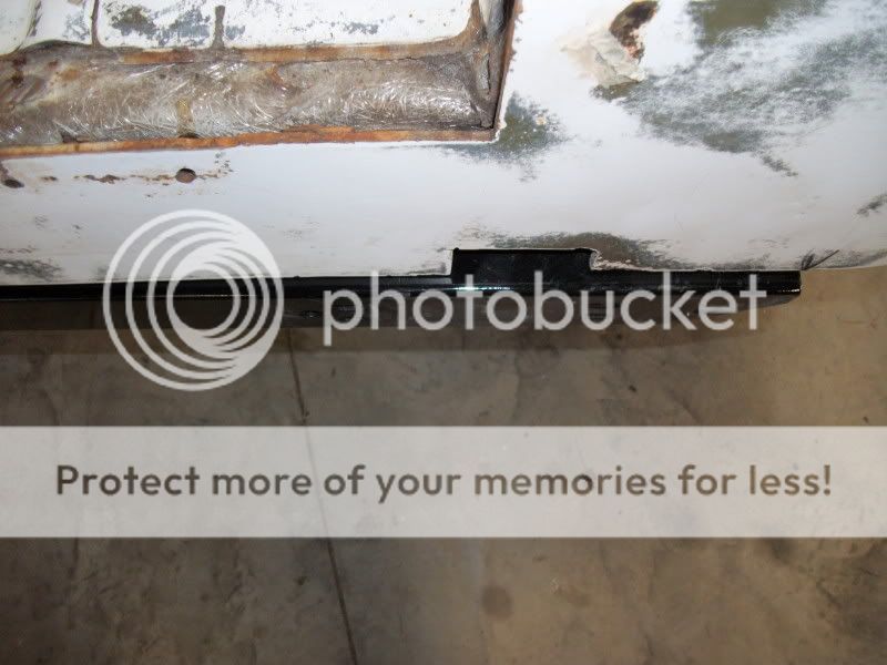

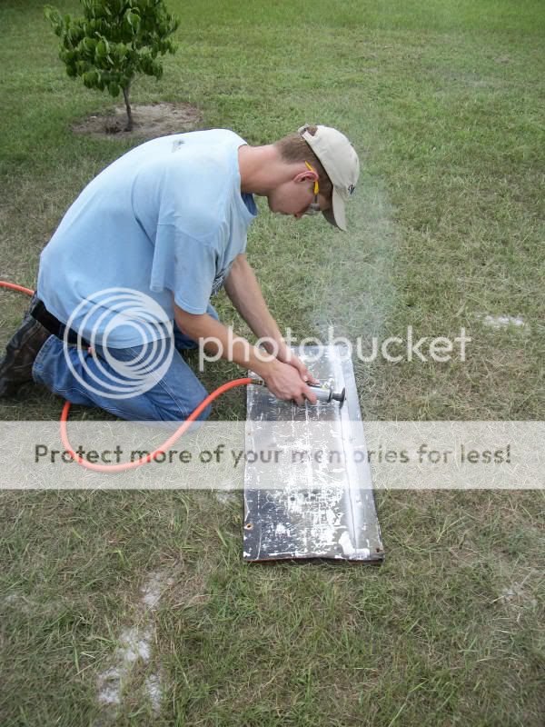

It's been a good day today, and it's not over yet! Clay and I got some important mods started. The crossmember is tacked up. This helps us figure out the mounting requirements for the back of the tub. It also gets the gas tank/skidplate off my shop floor! Wifey made a parts run for us, so we have some rattle can primer/sealer, mat, hardener, and other go-fasters.

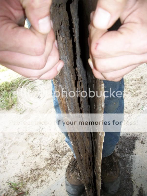

Clay has decided that he will make the back of the Jeep solid. No tailgate, no cargo net. The PO had cutout the back and made his own tailgate out of the glass piece that he removed. Clay removed the steel angle the PO used to frame out the tailgate, and we couldn't believe the dirt and crud that came out of it!! Also, check out the rotted, bug-infested wood!
We had to stop a bit to cool off. Wifey made a big pitcher of Gatorade, so we've been in pretty good shape. Fixing to go back to work. Itis getting ready to pour!
Enjoy the pics...
This first pic shows the crossmember in place. We just stuck it up there as square as possible. We have to remove some steel.
Here is the reveal on the crossmember before Clay did some grinding to the frame horns. The frame horns had been repaired/replaced by a welding shop.
Clay grinding down some steel on the frame horns. This will get the crossmember under the tub and flush.
Tacked in place, plumbed... looks good.

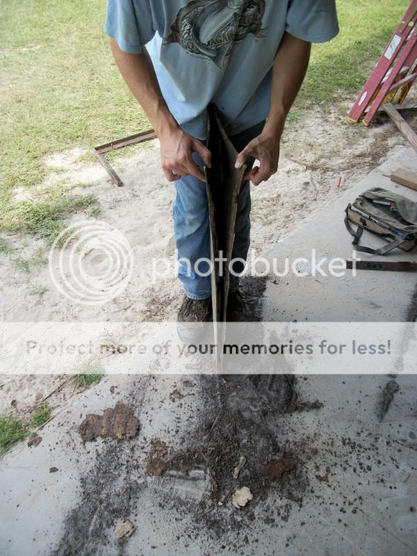

Here's Clay showing the crud that fell out between the two pieces (inside and outside skins) of tailgate. The PO cut this rectangle out, framed it with steel, and put hinges on it. We're going to reuse it to close up the hole that he cut.
This is what would happen to untreated wood that gets wet between yuor glass layers. Be careful!
Clay buzzing off the interior skin so we can remove the old wood.
Wow! I think your Jeep has termites Clay!
