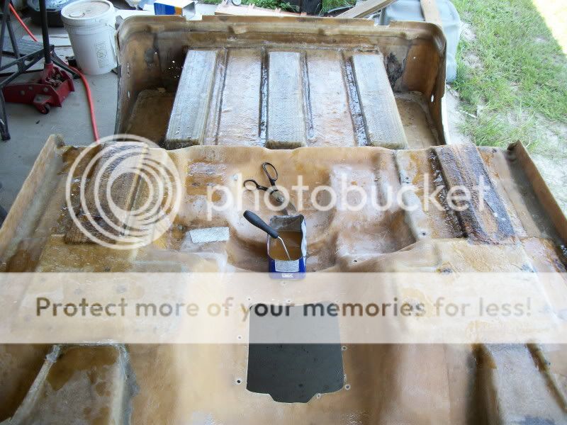

We are rocking this weekend! Have you ever gone to bed on Sunday night feeling like you wasted your weekend? Not this time...

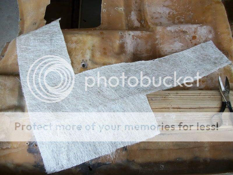

We have a couple odds-and-ends left to glass underneath, then we can paint it. I can see the light, boys! Here we are finishing up the tub mounts that we installed earlier in the thread. We're using ounce and a half mat with polyester resin. 16 ounces resin and 5 CCs hardener... gave us about 30 minutes working time. I apllied the resin the glass and Clay rolled it out. The lighter material makes bends a whole lot eaiser. Just the same, notice how to make relief cuts to make the glass lay down.

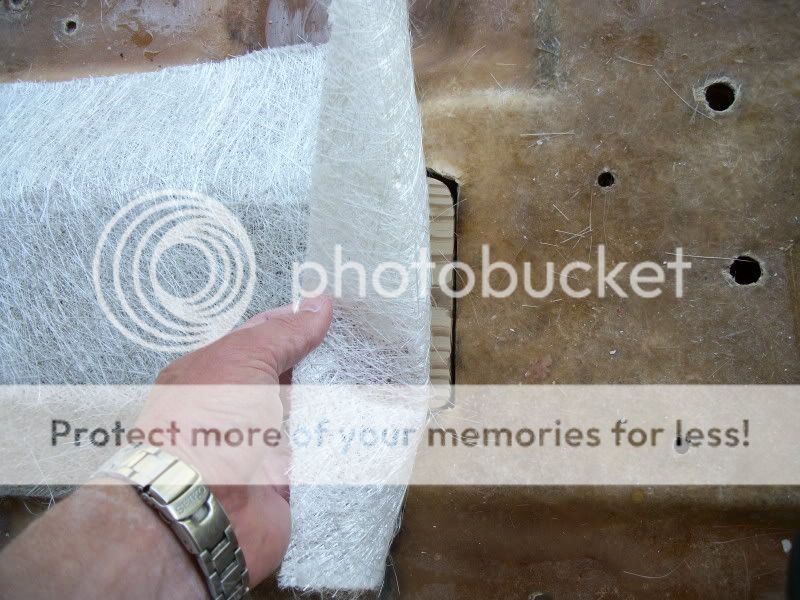

Here we go...
Showing the precut piece to use over the tub mount. I laid it out first, cut with scissors, allowing 3"-4" overlap for strength.
Here I'm just showing how much I overlapped. I tried to be consistent all the way around, but you can't always do it that way. Do what you can.

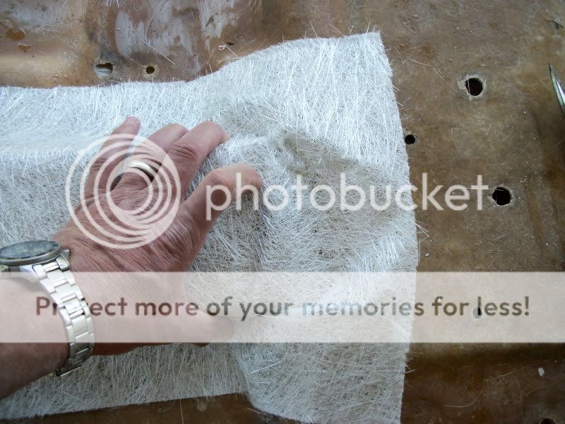

Notice how it puckers up when you force it down to it final shape? You don't want that. Break out the scissors.

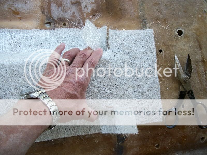

Here I've made relief cuts to get the material to lay flat at the corners. I cut off pieces that were excess and used them to reinforce the corners. You can do more than one layer at a time as long as you get it wet to the bottom. It saves time and clean up.

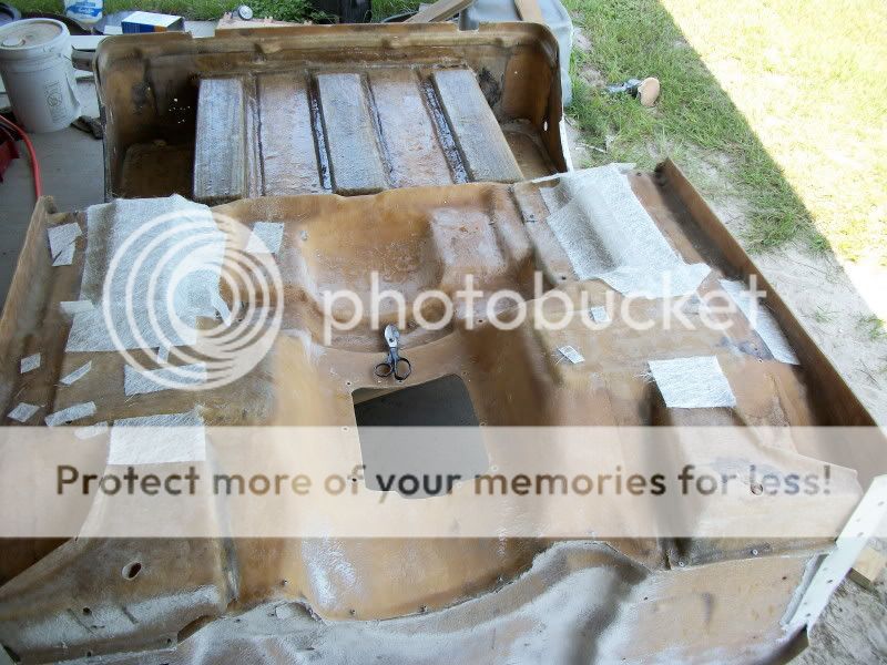

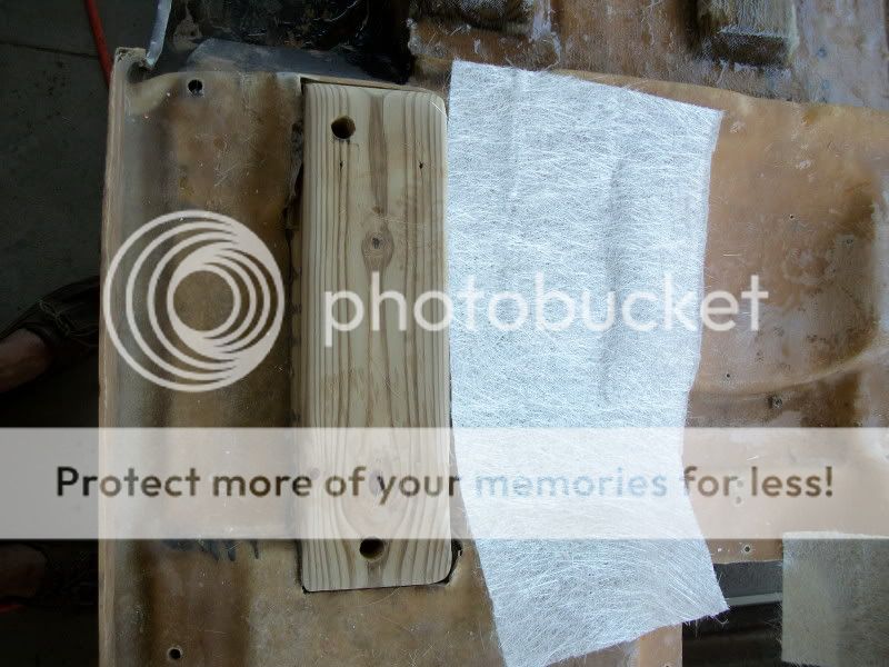

I didn't have enough left over for one big piece, so I cut this piece up to cover the mount area. You should make the material overlap a couple of inches.
Here is everything precut and in place. Notice the mount on the right side with mulitple pieces to cover the mount. All of the small pieces are covering PO holes!

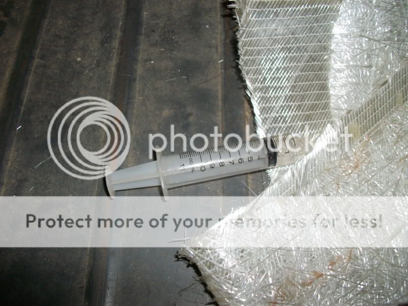

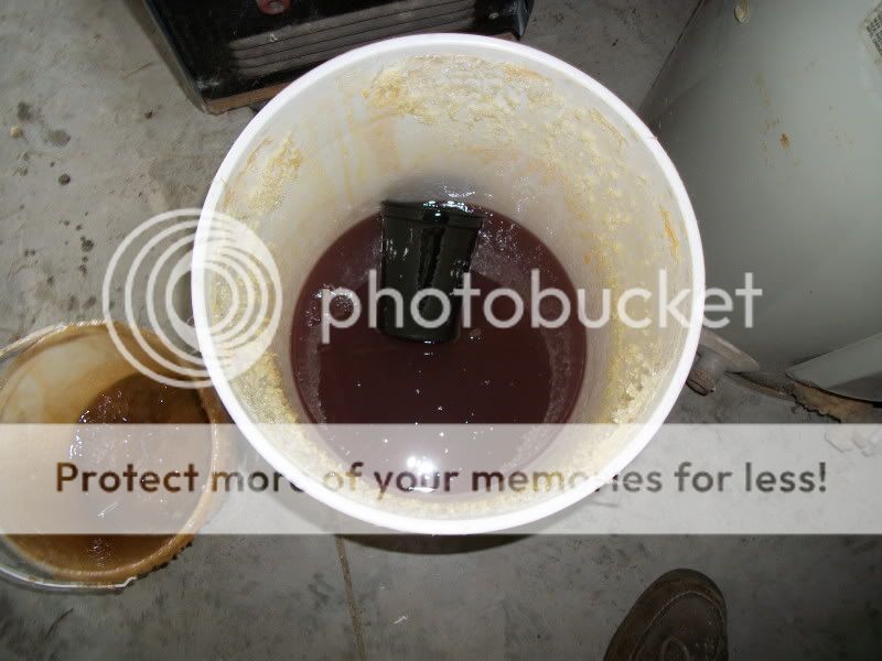

I bought some bulk resin from my friend Hal. I'm using a 12 ounce cup to measure 16 ounces of resin. Then I used 5 CCs of hardener. This is reduced from Hal's recipe of 32 ounces resin to 10 CCs hardener.
I'm using a 10 CC syringe for accurate hardener measuring. You really DON'T want to just squirt an unknown quantity of hardener into your resin. Pour in the required amount and stir very, very well.
DONE! We are getting closer to painting the underside and being done with it altogether.
