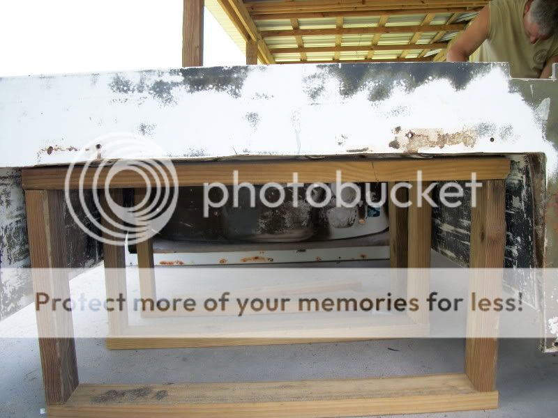

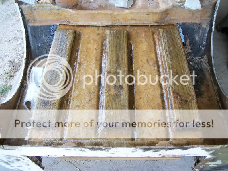

Clay first built some frames to give support to the bed while we were working. Remember, if your bed is sagging when you apply glass, and it hardens that way, it will be permanent. So make sure your surface is ready before you apply. This made the surface flat from side-to-side and front-to-back.

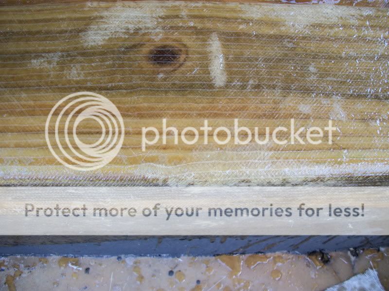

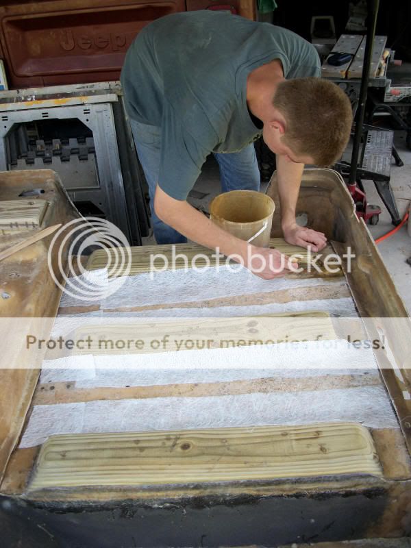

Here Clay is adding some strips of ounce and a half mat to the sides of the stringers for added strength. The strips also fill in the grooves in the bed where they had been worn through by the PO. This should have already been done, but...
Notice how the glass just disappears once the resin soaks into the fibers.

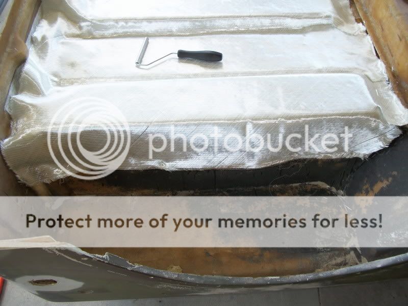

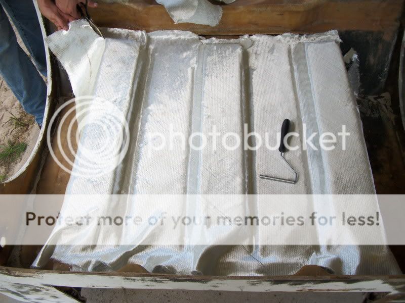

Clay's earlier stringer bracing is dry, and we are test-fitting the bi-axial.

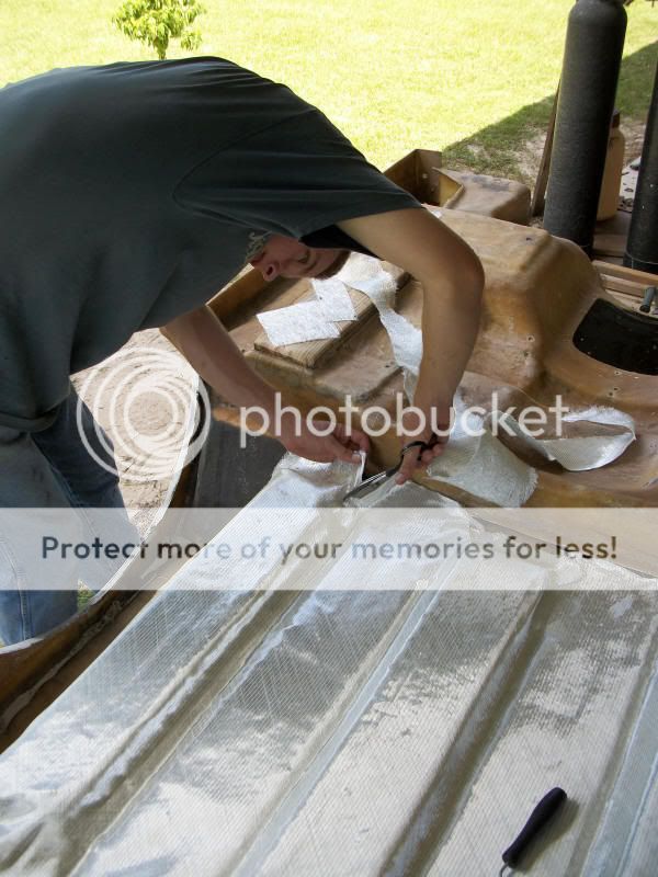

Clay is cutting/trimming to make it lay down better around angles/curves. This stuff was difficult to work with. It did not bend, and we had a lot of air when we were done. Take time to make gentle curved edges around your base pieces... nothing too abrupt. My edges were done with a 3/4 round-over bit, and it wasn't really enough for this heavy material.

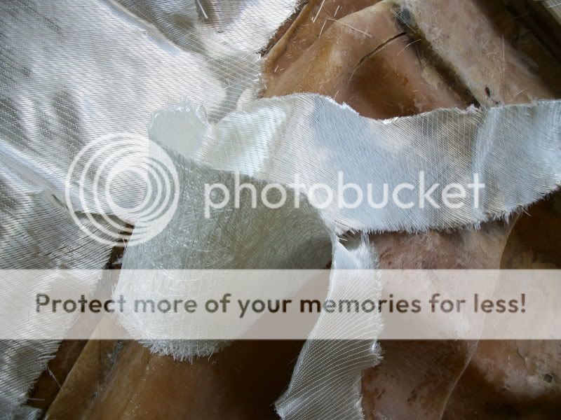

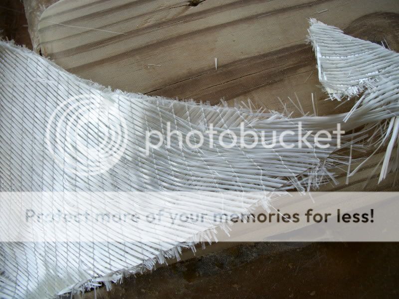

Here you can see the two layers of strands running at a 90 to each other, hence the name bi-axial.
Here is a pic of the mat sewn to the backside. I think Hal said the mat was 3 ounces, but not sure. The total weight is 18 ounces.

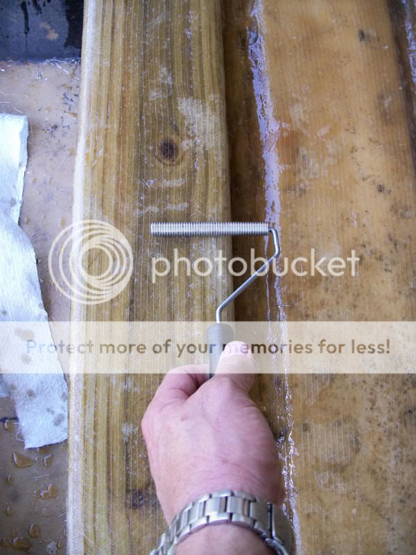

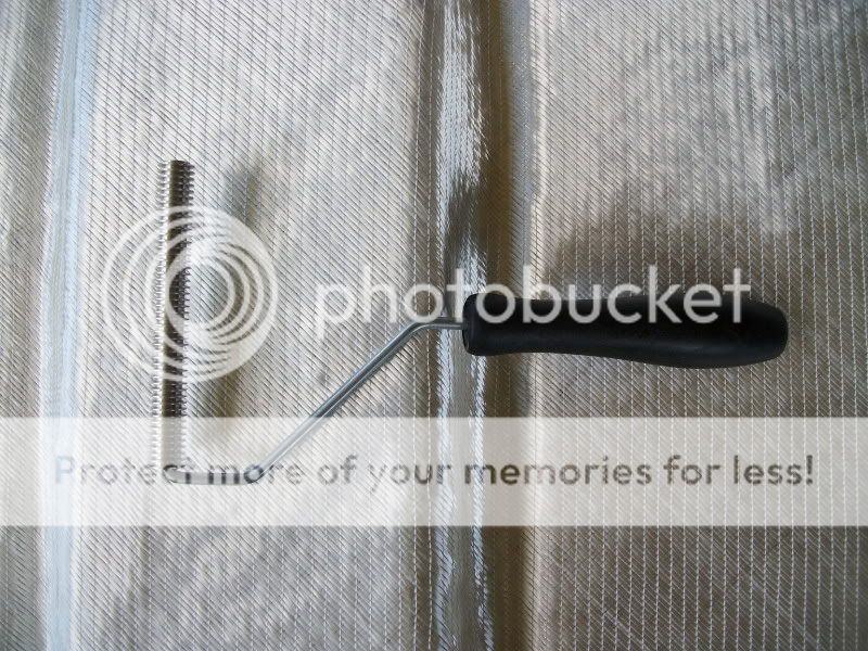

This is an air roller. The grooves in the roller allow air to escape while pushing resin down into the material. You simply roll it over the wet area before it hardens. In a perfect world, you will "chase" the air out to the edge and the mat will lay down nice and flat, and you will have a better bond. This roller is aluminum. They also come in plastic, but LT or Acetone could dissolve a plastic one when cleaning up. This is an important tool for quality-minded people. If you don't care, then use cheap paint brushes.
Just roll it over the air pocket, pushing toward the side. Easy!

Here is the bi-axial all done. It is drying. I could not wait to get a shower. The chemical heat coming off of this stuff was surprising. My skin was burning very mildly. There are several places where we have air pockets, but it will not affect the structural integrity of the bed. Once it is painted you will never tell. It set up hard, and Hal was right... this sucker is some kind of strong. Tomorrow, we flip it over, drag it out to the front yard, throw a couple of lounge chairs in it, and wave at people as they drive by! NOT...
