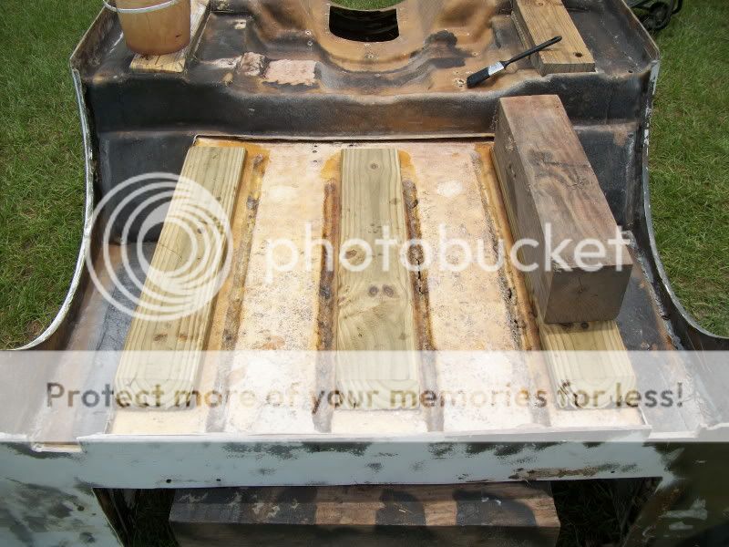

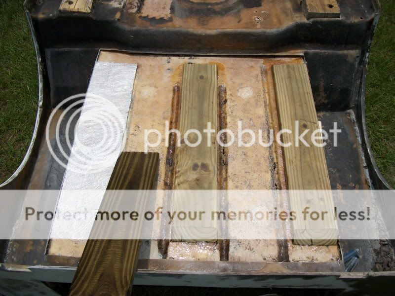

I got a little prep work done this morning, but it is fixin' to storm and the humidity has gone through the roof! My glass friend gave us some pointers on how to repair the tub area, so that is where we (I!) started. I am using 3 2X6 PT stringers for strength. Incidentally, it is raining in my backyard, but not in the front yard!
I cut the stringers (2X6s) to length, in this case 31". I made sure that they covered the areas where the tub mounts will be. Those are the outside stringers with one in the middle for good measure. I precut and layed a piece of 1 1/2 ounce mat down on each place. I beveled the ends of the boards at 45* because it is difficult to bend glass. It doesn't like to bend so you need to give it a smoother transition. I also beveled the edges with my router, using a round-over bit. The only reason I am using 31" is because that it the length of the mat.
Next I coated the bottom of each stringer with resin. Then I applied the resin to one strip of glass while it was in place, and pressed the coated side of a stringer against it. Make sure you get them where you want them! Repeat with the other stringers.
I am doing this because the factory wood was rotted and needed to be removed. This left the "Hey, I can see right through it" bed floor! Since I am going to be applying some heavy, heavy mat (18 ounce Biaxial) to the entire underside, it's not necessary to cover the whole area now. No need to waste material. All I want to do is hold those stringers in place. The small piece of mat between the stringers and the tub will reinforce the thin areas I might have covered up... so it is sort of insurance.

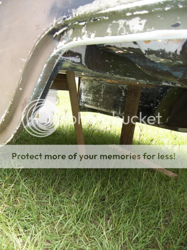

I didn't think about how flimsy the bed is right now, and I didn't consider the sag with the weight of the stringers. So I ended up sticking in some props to hold even pressure against the mating surface of the stringers. Anyone who may be faced with this should consider that in advance, and properly brace the work area to make it flat, before you start. And don't do it before it rains!
Here are some pics...
Here are the stringers going in. Two are done. Note the beveled edges.
Extra weight to make good contact on this one side. It was where the bed sagged the worst.
Props... because I'm an idiot! Should have planned ahead!!

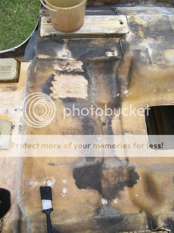

Whoowee... did it rain!!! Wifey helped me get the tub under cover JUST IN TIME!!! Thought I'd post up some tips that my fiberglass friend told me. For your viewing pleasure!
When my friend, Hal, was in business, he was buying 18,000 pounds of resin weekly, a tanker truck load! He told me some interesting things that I did not know.
Resin to glass ratio should be about 50/50. Most of the time you will end up with 65% to 75% resin to glass, and he says that's more than you need. In the boating industry, resin = weight, and that's undesirable. Maybe not such a problem on a Jeep, however.
Hal said grind your surface well. Prep is EVERYTHING! We've all heard that before. Once you have completed grinding the surface, use DRY AIR ONLY to clean. Never use Acetone or any petroleum product because of the oil residue.
He also says don't prep/grind your work area until you are ready to apply the glass. It's okay to wait 2 or 3 days, but not 2 or 3 weeks. He says the pores will close up, and you have to do it again. So do your prep, and then lay your glass.
Hal also said that grease and oils won't soak into the glass, they will stay on top. He said you can grind them right off. He was right!
In the picture below you can see some areas that I have circled...
The yellow circles show where there is a factory 90* angle. Hal said to leave that for strength. Anytime you have a bend in the glass it makes it rigid. I got lucky as I didn't remove it, but I was planning on it to make a smoother joint with the new glass. Not sure now how I will incorporate the new glass, but I have a good teacher.
The red circles show how I positioned the outside stringers along the edge of the factory glass. This will make it easy to join the new glass to the side of the bed, just overlap it. This eliminates an unnecessry bend, and remember, glass doesn't like to bend.
The green circles show where you can see through the bed. I will add some glass to these areas so I can fill from the inside with Duraglas.
Finally, the last pic is the rain! Hope you guys are having a great day. I think it's time for a nap!!
