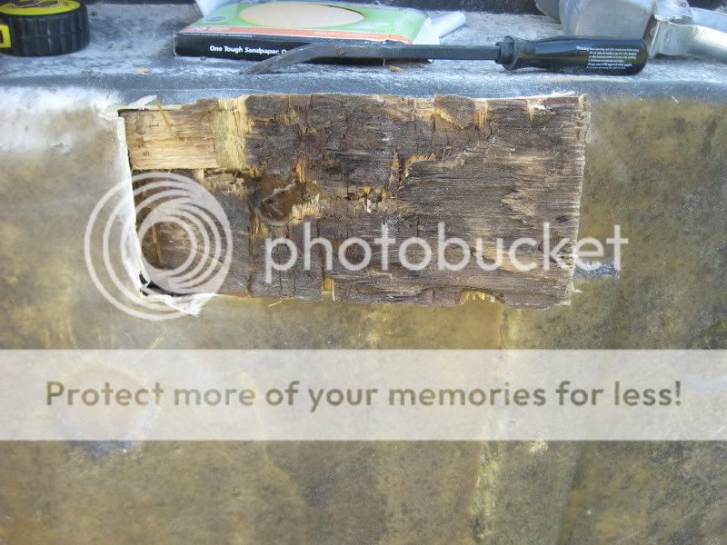

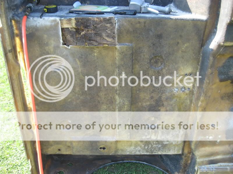

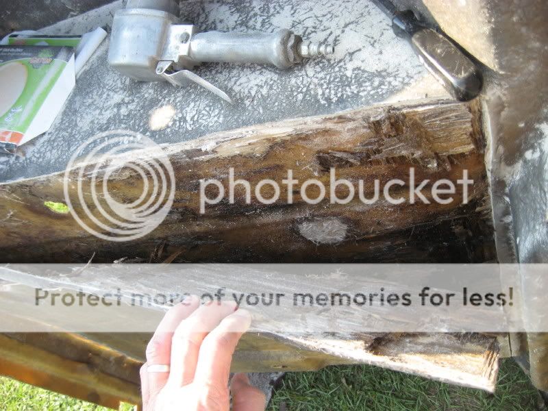

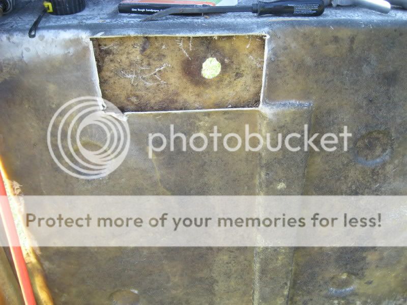

I feel like we've had a good day working although it was interrupted several times. We got back from our friends house an hour ago, and I AM SO FULL! I can't stop drinking.... Cokes, water, tea, etc!!! Clay had a little more gumption than I, and he suggested removing the entire double-walled area of the bed region. I don't know what kind of wood the factory used, but it was junk! Here are the pics of the process of this important tub repair.
These areas are the blocks where the tub mounts make contact. I was going to remove only these areas, but Clay said we needed to go further.
Using the die-grinder I cut around the raised area. Notice the rotten wood. It was wet to the touch.

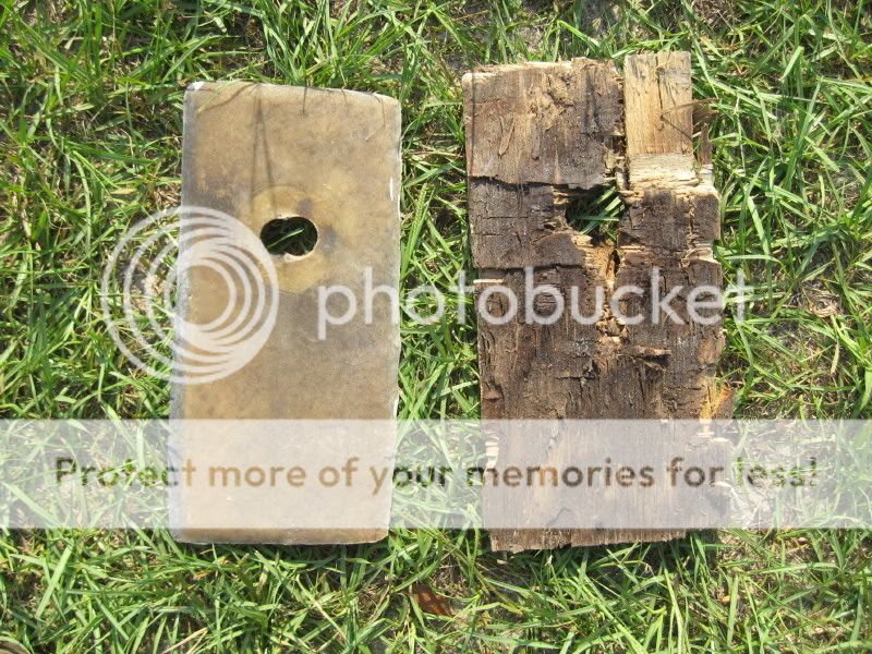

Here is the hole with the wood popped out.
Glass plug with wood backing.

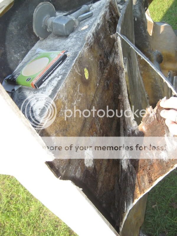

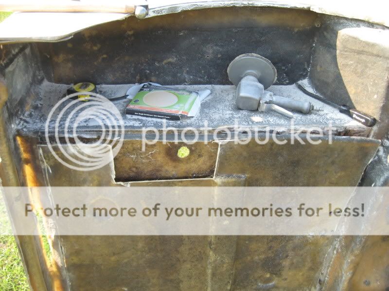

Beginning cut around the entire double-walled bed section.
A couple of peaks behind the glass.

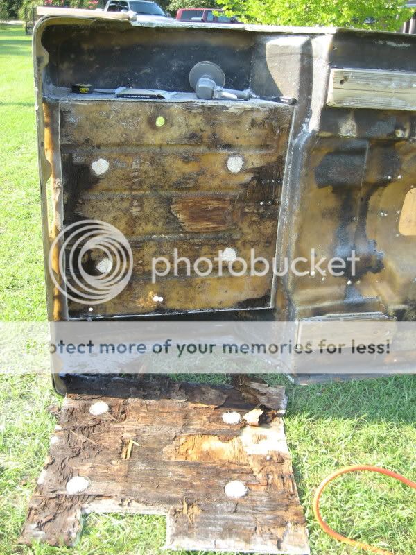

Exterior skin removed. It was quite wet between the two glass layers. It would have been a waste of time to add glass to the exterior of this tub without making this repair first. We will add some 2X6 PT to the bottom, creating stout mounting pads for the pucks. We will also add an additional 2X6 stringer for extra strength. The interior side of the glass (the piece that is left inside the bed) is so thin you can see through it in places. The PO must have dragged stuff in and out of the back of the Jeep.
Stay Tuned!... Oh Yeah... HAPPY 4TH OF JULY!! We are FREE Baby!!
