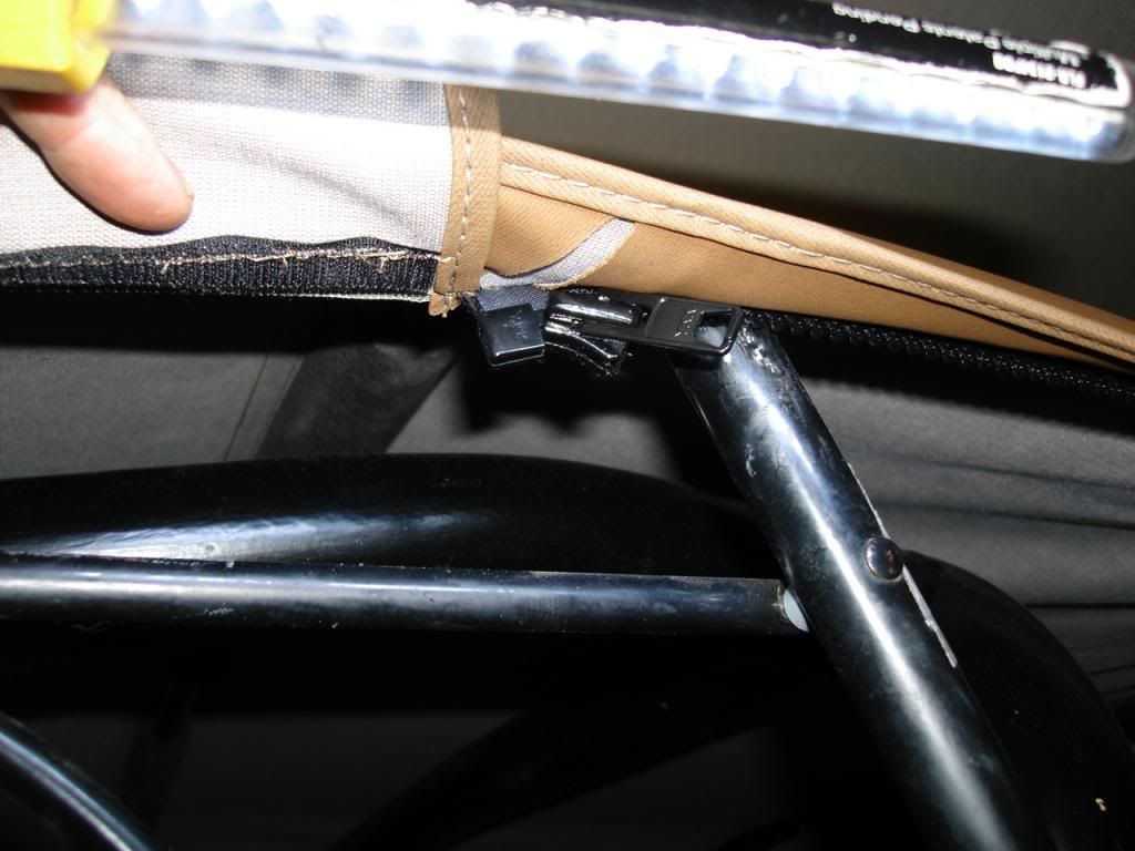

I bought a top today and it is maybe one of the bigger disappointments so far.
This thing is so tight it rips the retainers out of the corners before the rear bar can be put in the lowest hole. I have one side in now and the heat running in the garage, I will let it sit a day and see if i can gain some stretch.
Even so,,, i guess i will return it because the zipper (in the top driver side) for the side curtain is sewn in jacked and there is no way to start the zipper.

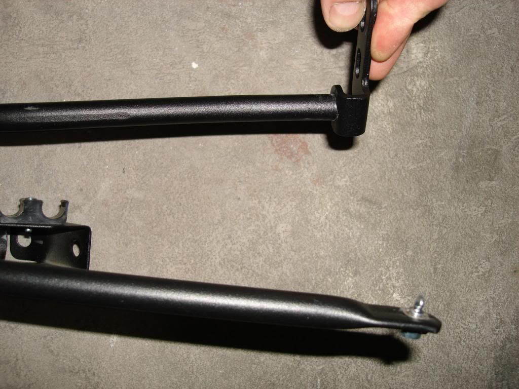

Issue two, The verticle bars at the door opening are larger than the hole they slide into. I de-burred the rod and enlarged the hole, manages to install one side. The passenger i gave up and used my old bow system, measures about .025 smaller and slides in easy.

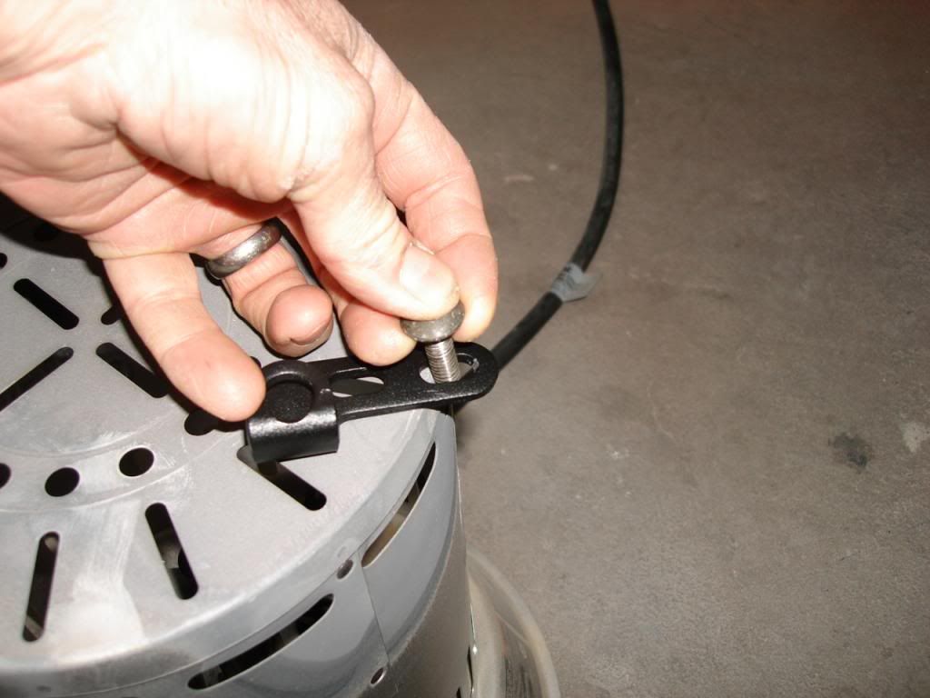

even the bolts will not fit into the door pillar bracket, i used my old pillar supports

For the hole fitment issues on the vertical rod and other places it seems they would have fit fine before they were powder coated, but not after. I had to enlarge all the holes where that was happening.
At least I can start the zippers in mine, but most of them are hard to get to, like yours but not quite as bad.

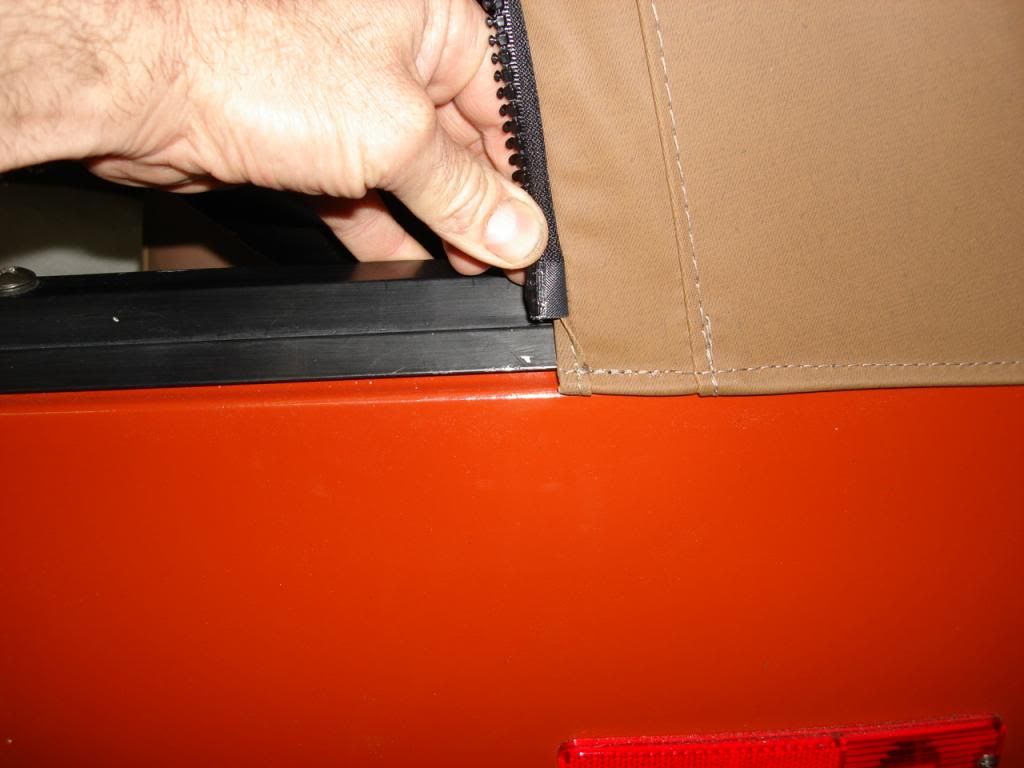

while i am complaining i will add this also, maybe i can help a fellow jeeper save some headaches.
Side curtain can not fit because of the retaining plastic conflict.
If you look at this picture you can see the old and new side curtains. On the old curtain the plastic retainer strip is shorter, about at the base of the zipper. On the new curtain it extends to the end.
the problem is on the new top, it also has the retaining plastic stitched to the end. The way it is stitched the two plastic strips must overlap by about 3/8 inch?? The panel can not be installed.
we're not talking about much but it is enough to make it impossible.

I assume you're trying to install the windows with the top already taut. You might try backing up a bit and not raising the most rearward bow all the way. That should create some slack in the top and allow some movement in the fabric to line things up. THEN you can insert the bottom of the top into the band. Then you can raise the bow.

Someone else was right about zipping in the windows while the top is slack. At least start them that way, then after you lock the bow it's a lot easier to get the windows zipped in the rest of the way.
But it sounds like you have more than superficial issues, what with the posts not fitting in the holes, etc. You could probably make it work, but if you're like me you're really tired of doing that with Every Damn Thing you buy for your CJ.
