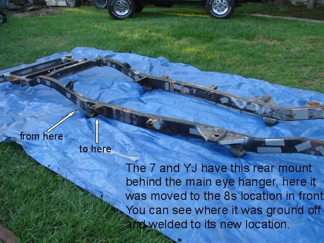

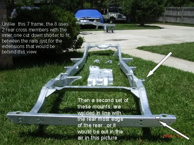

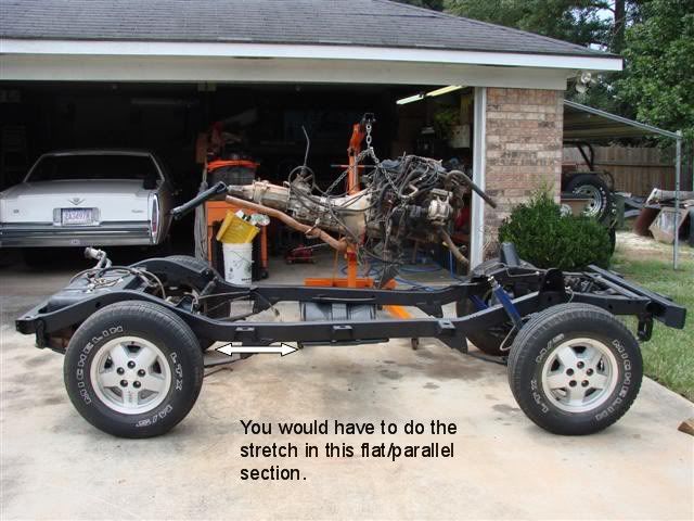

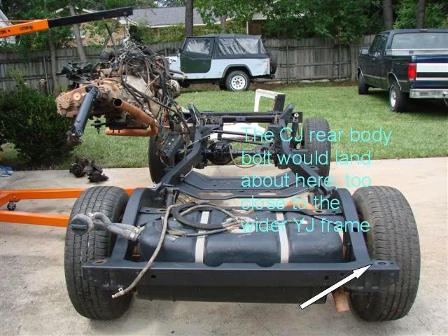

Here's a link to when I posted about making a Scrambler frame. It would apply to stretching a YJ frame as well.
CJ-8 Frame/ Body mount dimensions - Page 2 - Jeep Scrambler Forums & Discussions
Here's some pics of the mounts that are different between the CJ/YJ and the CJ-8 frame for body placement.

hey thanks so much for the pictures. this really helps me understand the whole concept.
