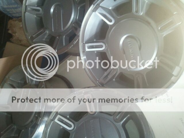

got tontoe some new shoes

Kinda. Got the tires mounted. Everybody around here wanted 30+ a tire mounted. that sure as s*** wasn't gonna happen so for about $15 for ether and air soft bbs I mounted them myself. Took about 10 oz of bbs per tire which actually is a lot.
