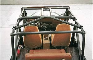

Posts: 2,418
Rockhard also sells dash mounts for roll bars. I've seen too many rollovers where the bar that attaches to the windshield just collapses.
Like this:
If you want to, you might send a bar from the just behind that connection (welded to the horizontal bar just before the windshield) to the floor and then to the frame.
Here's the dash mount on my CJ:
