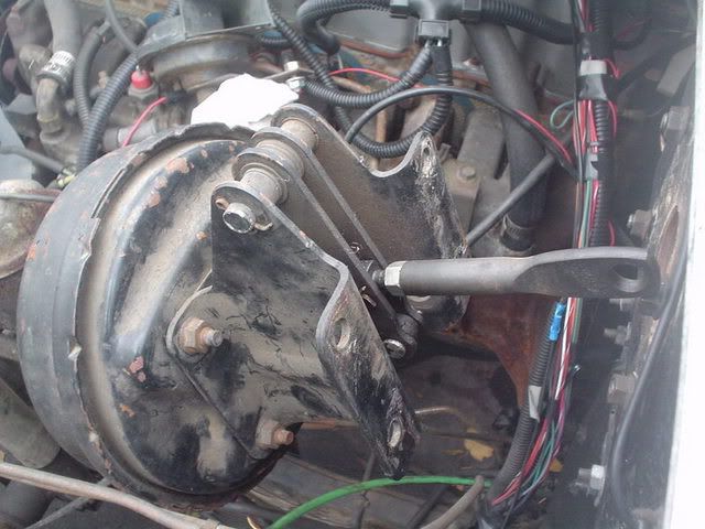

Posts: 1,097
Your never going to stop fast with 35s and a factory CJ power brake set up. I can remember putting 35" boggers on my CJ and driving it. I had to plan far in advance to stop. It was scary to drive. You can swap in a YJ power brake booster and master cylinder to get better braking. You can swap in a dual diaphragm brake booster and master cylinder from a six cylinder 95 YJ wrangler and you will be amazed at how much braking power you will have, or you can go the hydroboost route. But stop wasting your time and money with the CJ set up.
I will explain why the YJ system is much better than the CJ set up.
The push rod on the CJ power brakes is canter levered so you only get a portion of the force you apply to the brake pedal transfered to the brake booster.
Here is a picture of the CJ power brake push rod.
In a YJ Wrangler the push rod goes directly in to the brake booster so you get 100% of the force applyed to the brake pedal transfered to the booster.
