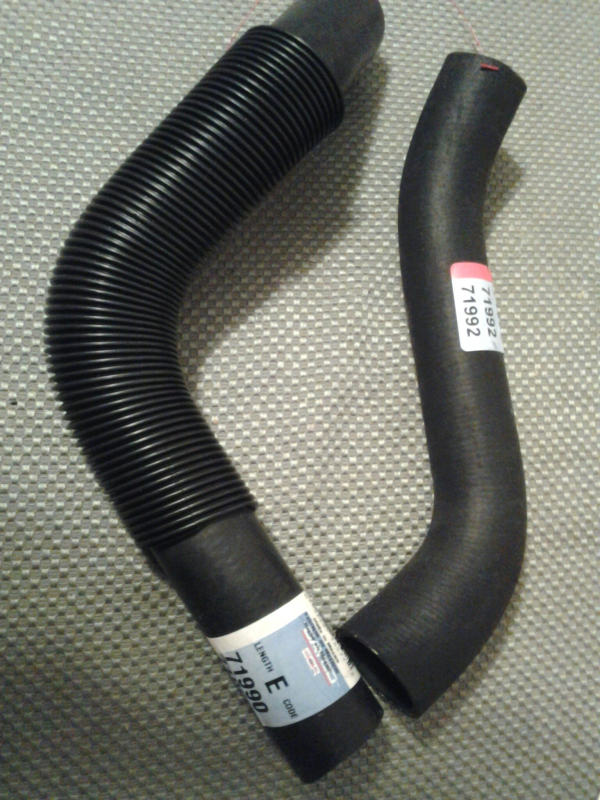

Top hose I used was a 71990 and the bottom was 71992 with little to no trimming to fit. Hope that helps

wonfastws6
where did you go to get your hoses with those number ? because all i have local is a nappa.

Napa should be able to cross those #'s over but if I'm not mistaken those are napa numbers
Those are Dayco part #'s... but you are correct that NAPA can reference them to their own supplier.

Search those Dayco hose#s on ebay, they came out to be cheapest for me on ebay shipped to my door. You can also use a radiator for a 6cyl with HD cooling, it might even be the same as the Jeep V8 one.
