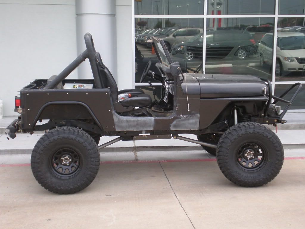

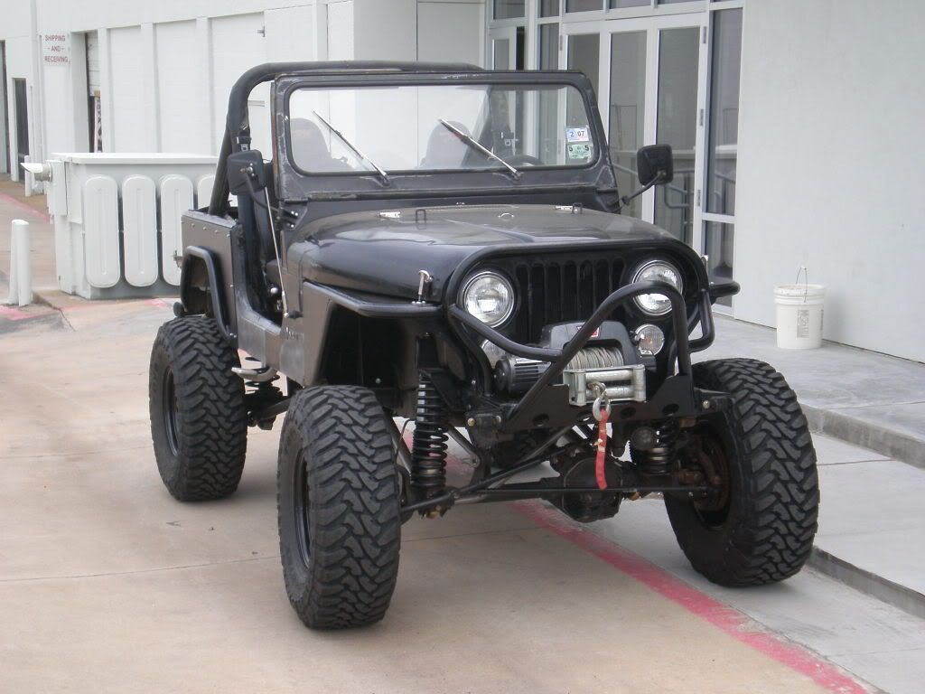

Got this 86 CJ7 at the shop here, and decided to upgrade everything. Changed the old motor out with a newer 06 4.0l, trans, and 241 transfer case. Updated all the wiring with 06 tj wiring and computer. Installed Dana 44 front and rear, 4 linked. Built tube fenders, front stinger/winch, rear tube fenders. Building a new gas tank behind the seat for a tj fuel pump. New AutoMeter gauges, Mastercraft seats, and the list goes on.

Nice Jeep! What are the plans for the cage?

right, 86... Probably the poison spider cage with some add on reinforcement.

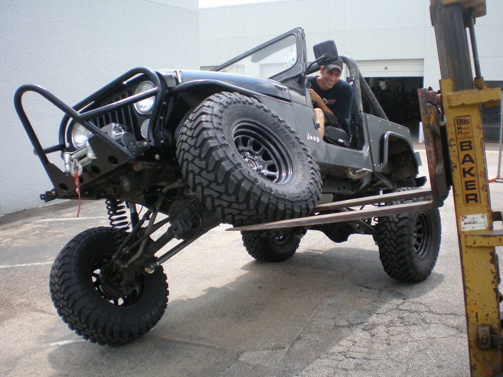

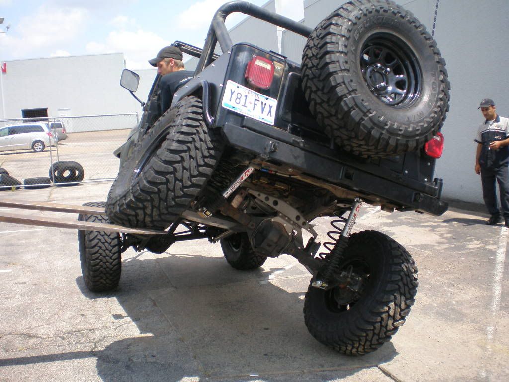

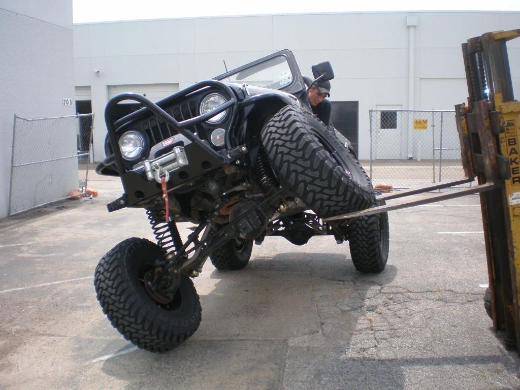

Very Nice! I would like to know what all you did to get that suspension set up on a cj. Did you buy a kit for a TJ and modify it, or fab the whole thing? How does it handle on the street? This is something I would consider for my 84. A good write up would be cool. Again, looks great.

Full Traction 4" long arm kit for a TJ. It wasn't too bad. I hacked the chit out of the frame mounts, but used almost everything from the kit. By using the long arms provided, they stretched the wheel base about 6 inches. I dont know if I would do it the same a second time around though.

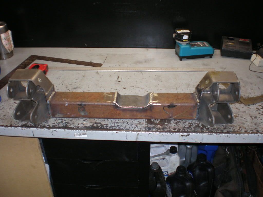

Heres an example, rear cross member. Cut the mounts off the kit, flipped them and welded in 3x3 square.
