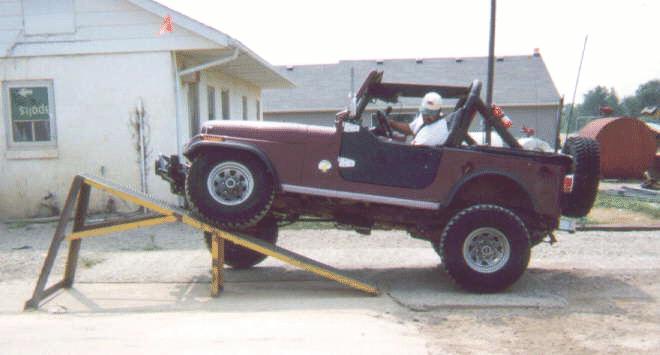

The Superlift is a 2.5" (care to guess what I have on my rig?). Probably about the best riding/flexing of the low-priced kits once you loosen the spring clamps and give 'em a trail run or two to break them in a bit. Rancho does not enjoy a good reputation for ride quality & flex...you're paying for the name with that one from what I've seen. I've gotten them to work better on other peoples' rigs with the same treatment as the Superlift springs which makes them worth no more to me than what Superlift sells for. I know I've posted these before, but here's my rig before I added more lift and moved up to 35's with the 2.5" Superlift springs, Tomken shackles (adds another 1/2" of lift), and 32's:

Originally Posted by T18A
32's. 33's will hit and bent the quarter panel behind the rear tires when the springs are compressed.
Even if I do minor offroading? I wouldn't expect the spring to compress driving around as a DD. But if that is the case I will have to go with 32's. Wouldn't it be better to put a 2.5" on the front and a 2" in the rear since the front is heavier? If they are both the same heigth wont the front be lower than the rear?

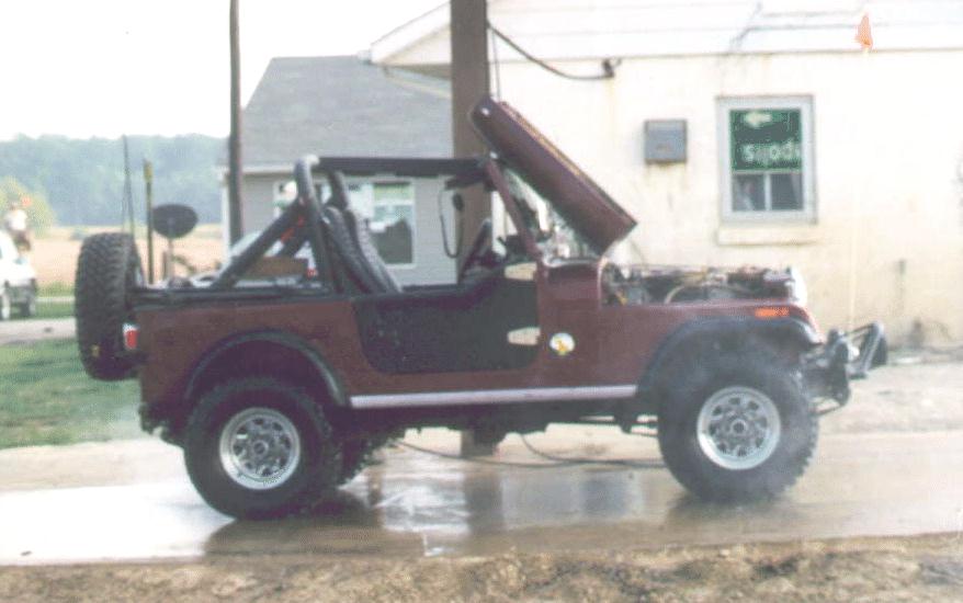

Around town you are probably fine with 33's. I used to rub my 32's against the fender flare where it meets metal when twisted offroad and lifting tires. 33's will bend the quarter panel in that situation.
I've had the opposite experience with Rancho. Their 2.5 inch springs were great. The rear sagged about 1" in 9 years. The fronts held up fine. My friend's Superlift sagged to stock height in 1 year.
Your shocks make a huge difference in the "feeling" of the springs. I had two CJ5's with Rancho 2.5" - one with Rancho 5000 shocks and one with Rancho adjustable 9000 shocks. The Rancho 5000's road uncomfortably stiff. The 9000's were very smooth. First reaction would normally be to blame the springs, but the shocks made the difference.
If Rancho made 4" springs I'd buy them, but they don't. I bought Skyjacker 4" springs and they sagged 2" after only 200 miles! I swapped them for Rubicon Express 4" which I have installed, but not had on the road yet.
Here is a picture of my 9 year old Rancho 2.5" with 9 year old 32 MT's the day I pulled them.
thanks for the pics.. that is the exact look I am looking for.. perfect blend of lift and tires.
