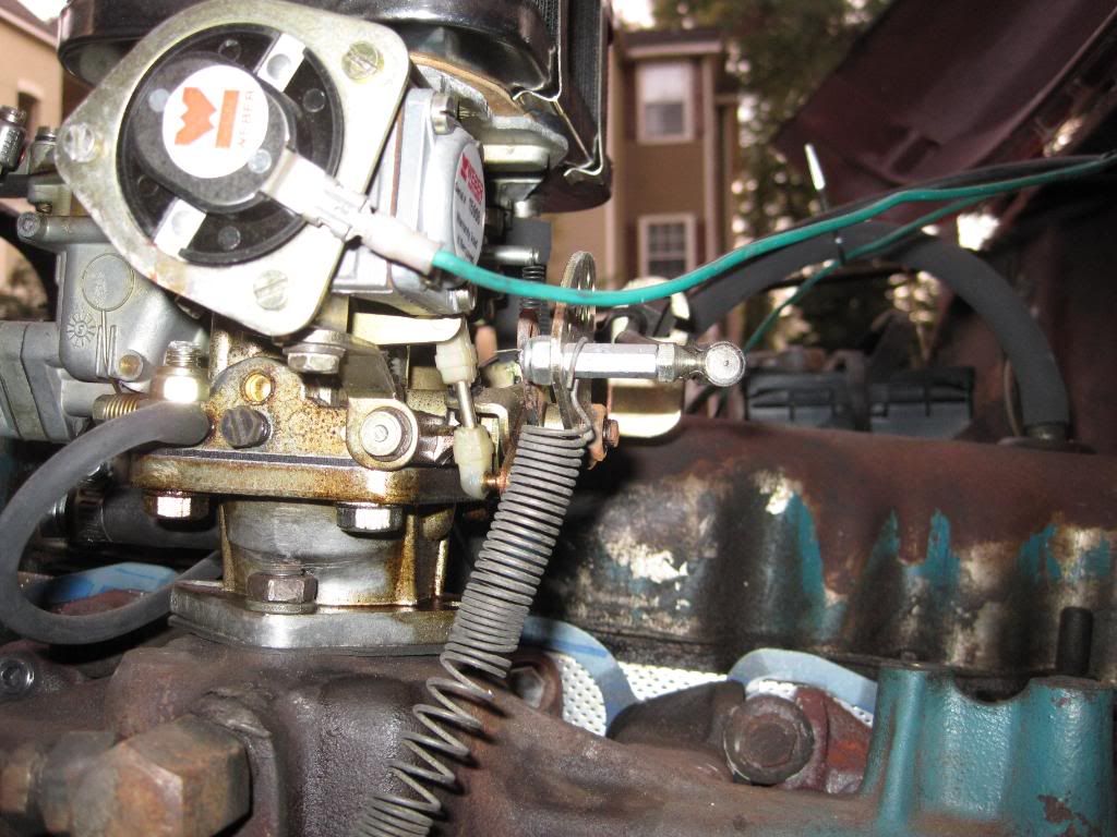

I have been trying to make absolute sure my jeep I bought is a 232 and not a 258. Most info I've found says they came that year with the 232 as a 6cyl but I don't know if it's been swapped out in the last 35 years can anyone help me figure this out since they use the same heads and manifolds.

The engine code is stamped on a pad on the right side of the block, just ahead of the distributor. It beaks down like this:
A- 258 1 bbl (71-79)
B- 258 1 bbl Low Compression (71-74, Jeep ONLY)
C- 258 2 bbl (4.2L, 76-89)
E- 232 1 bbl (70-79)
F- 232 1 bbl Low Compression (71-74, Jeep ONLY)
G- 232 2 bbl (70-74)
L- 232 1 or 2 bbl (68-69)
1. Year built code 2 & 3. Number of the month 4. Engine size/type code 5 & 6. Day built
Thus, "409C21" indicates 1962, September, 195.6 OHV (cast iron), 21st day.
Day Built "Year Codes"
1=1959 2=1960 3=1961 4=1962 5=1963 6=1964 7=1965 8=1966 9=1967 1=1968 2=1969 3=1970 4=1971 5=1972 6=1973 7=1974 8=1975 9=1976 1=1977 2=1978 3=1979
Beginning in 1980 the last digit of the year is used (1980=0, 1981= 1, etc.)

SUCCESS!!! 807E28 so it looks like built in july 1975 and it's a 232. I would guess it's the exact same motor it came off the line with!

Originally Posted by CarolinaAndy View Post
Just an FYI, your gas filter is in upside down, this can make for long cold starts. The return line should be up top so vapor can blow back to the tank on a hot shut down. If it is at the bottom it can drain all the lines when it sits, vapor locking it.

thanks for the info. I pulled it off and istalled it the right way. I do alot of stupid things but that one I can blame on the PO.
