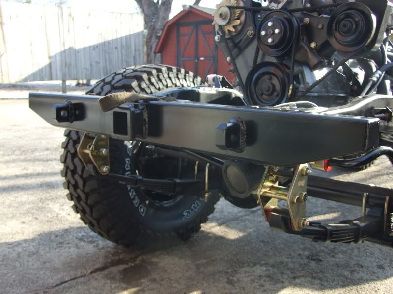

I had tow hooks welded on and just put d-rings through them....stole the idea from a buddy....I love it!!!
