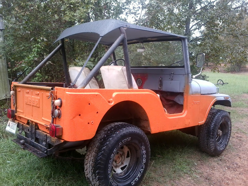

Just a little update.
I've made a little progress.
I had the brown truck deliver some parts.
Mentioned before.
Speedo cable, throttle cable, and bikini top.
So on went the parts.I even started some painting.
Well the top was easy enough the cables too.
Then the new speedo cable lasted for about 20 miles.
Then the speedometer locked up, and the cable twisted itself
into a pretzel burn up.
So now it needs a new speedometer and able too.
That is Krylon Pumpkin Orange.
Its never going to be a restored just an honest daily driver, hunting, utility vehicle.
One more snippet.
I'm going to do the 4.0 head swap soon.
I have a bad exhaust manifold and will not seal off so it sounds like a dump truck.
I have a couple 4.0 heads already and Cherokee exhaust header.

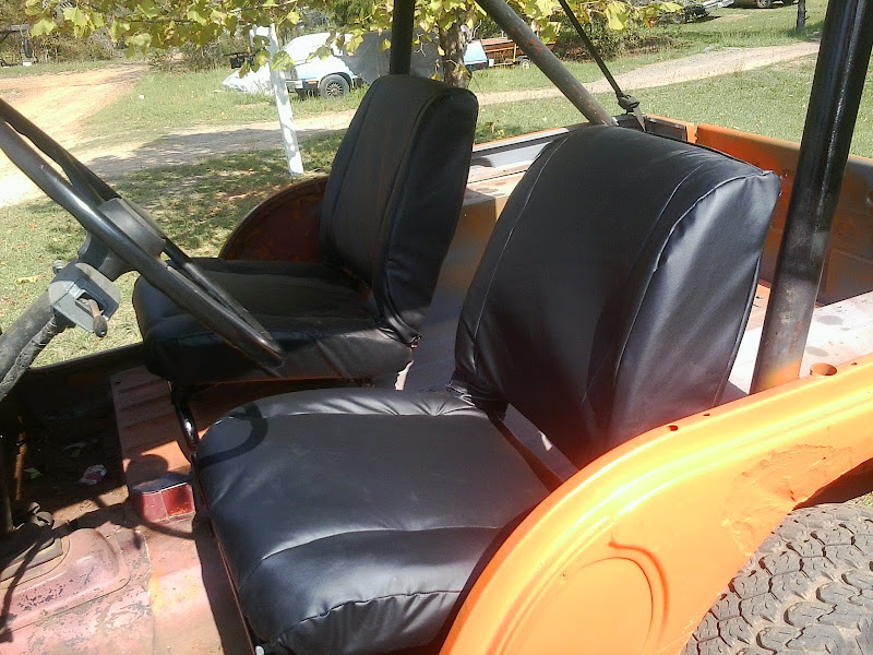

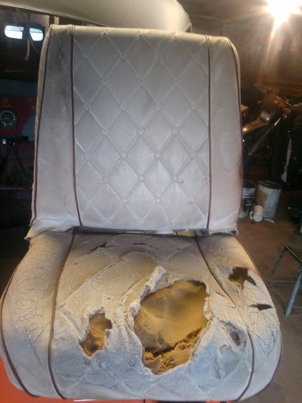

I have a friend at work that use to work at a furniture factory. He gave me
some very nice vinyl in black to recover the seats in. I've looked at the
aftermarket covers and they all look just that aftermarket tacky.
So we're going to take the OEM covers off and use them as a pattern
to make the new covers.
I think the orange and black motif is going to look good.
Caish is offline

Say it with Krylon....
It still needs another coat or two, due to light and dark streaks.
Caish is offline

So I recovered the seats, Mom actually did the sewing, and a friend
that use to work in a furniture gave me some material.
Pay no mind to the bondo there, It was all cracked out etc, and needs ground out and refilled.
Krylon Pumpkin Orange,
I like it....
Caish is offline
