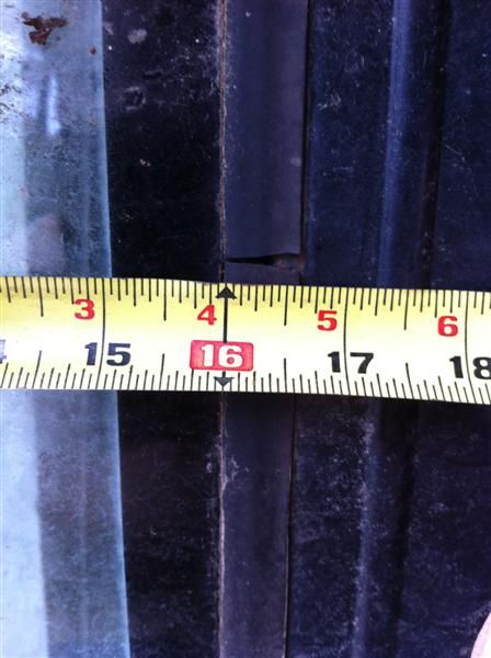

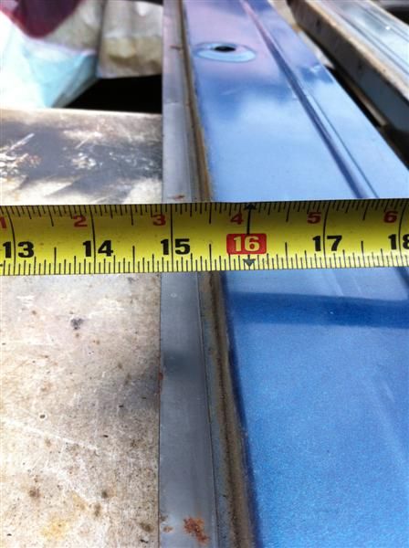

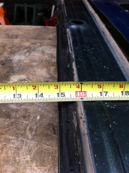

Just to get you some quick specs and pics, I pulled out a few WS frames and snapped a few pics.
Various CJ and YJ WS frames
Glass is out of all but one, so hopefully the measurements will confirm what you need
Start on the inside center edge of each
14 and 7/8s to the other side on both CJ and YJ
The CJ glass is about 15.75"
While the YJ glass is about 16.25" wide
So with the CJ glass being smaller all the way around, the difference is in the seals used with each. The seal must match the glass its being used on.
Both types of glass are larger than the inner flange in the frames. Thats OK because the glass rest infront of this flange. The CJ uses a one piece seal with offset channels....the thinner section toward the front AND glass is removed with the seal on and toward the front. The YJ uses a sealant and is glued to the flange. Then a outer seal goes around it with a metal clip at the joint and an inner seal on the inside to fill the gap.

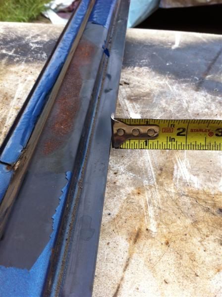

Now, here's the secrete...Both frames vary a bit on the size of the inner flange...this area... The are to the left of the tape measure end
The CJ flange averages about 9/16 of an inch all the way around while the YJ one is a bit thicker at just over 5/8s. While that doesn't matter for the YJ seal as it rest on it (glued), it could effect the CJ seal as it goes into the seal and could bottom out. What I do is use a flapper disk on an angle grinder and clean up, trim, and even out this YJ flange to better fit the CJ seal.
No, I don't have a picture of one in there right now as you will have to wait till I do body work and paint all the sheet metal first....so that's the best I can do for now.

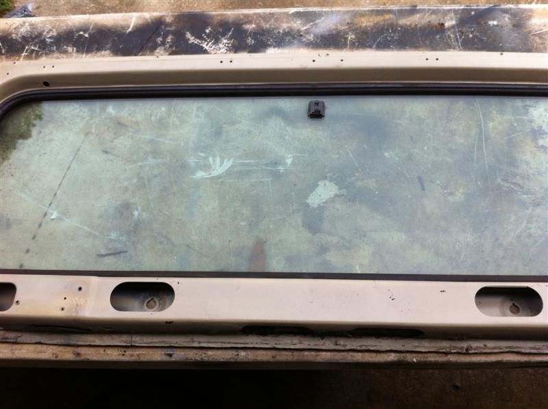

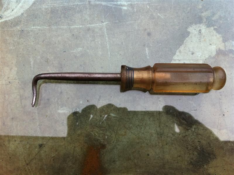

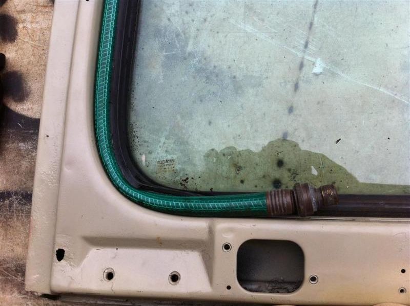

And speaking of broken glass, in case it helps some one, Ill show how I remove CJ glass and I havent broken one yet with this method....probably just jinxed myself.
This can be done in the Jeep, put a lot of time I remove the frame and place on a table (folded down could work too).

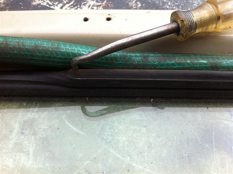

You need spray cleaner, a cotter pin removal tool, a 2x4 board, and a garden hose....yes, a garden hose. I think Im the only one who uses one, IF there's others, chime in.

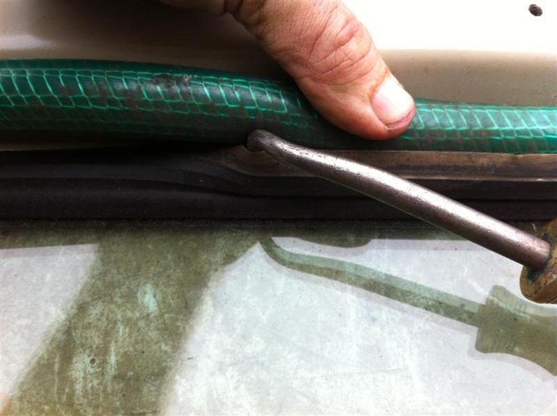

Pull back the seal on the inside and push the hose in to hold it back, work along the seal, carefully sliding the tool along to pull the seal out and push the hose in with your thumb.
You can stop just past the corner and really only need one long side and both sides exposed....but ALL corners.
Spray cleaner to act as a lube along the holes....the tool can be run between to allow it to work in.
Use a board to apply even pressure along the whole top and gently push the glass down and out at the top edge....stop once it clears, and pull forward to free the back edge. the seal should stay with the glass. Do not pry against the glass.
I TAKE NO RESPONSIBILITY IF YOU BREAK YOUR GLASS as this works for me and we all have different levels of finesse......
