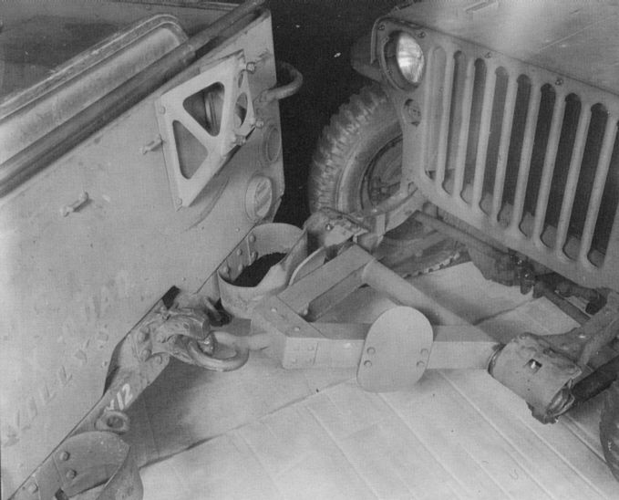

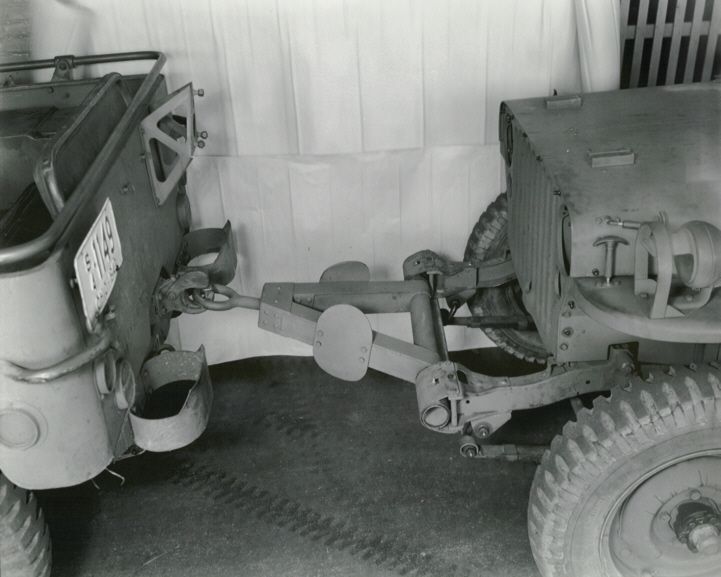

Ding Ding Ding....we have a winner
While they were used for pretty much all of the actions described above, the true function of them was for absorbers during towing (both sharp turns and jackknifing)
Often the trailers or towbars would be fitted with matching plates that lined up with them
When contacted, the bumperette would deflect like a spring and give the resistance needed to avoid damage
And this is just one of many carry overs that make our classic CJs rich is history and tradition. So now you can grin a bit when you see that huge plastic rear bumper on the back of a JK and think of all the changes Jeep went through over the years.......
