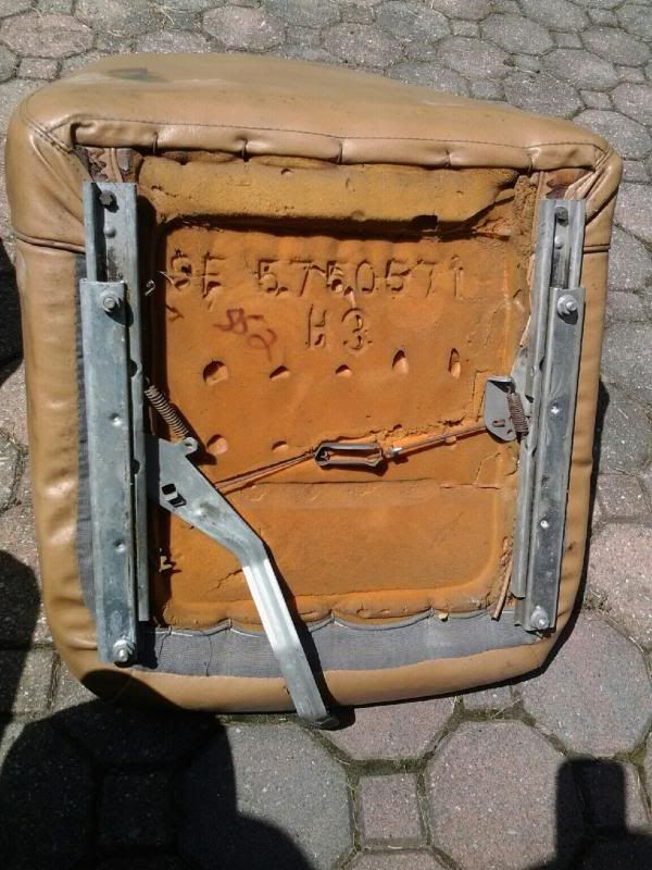

So if I use a slider like this for the passenger side the seat will be too high? What if I don't use the metal spacers? thx
CJ7ROB is offline
Hi Rob,
still trying to identify my seat. Maybe you can help. Does this one have an cj embossing? And what year is it?
