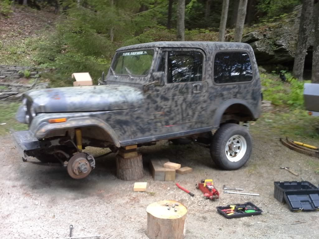

After diving into the build in Saturday's rainy conditions, it didn't take me long to determine that I forgot to purchase hardware for the main eyes of my leaf springs. I hopped in the car and spent the next two and a half hours driving around, looking for a place that sold the proper size sleeves (1/2" ID and 3/4" OD). After checking 4 different stores, I still did not find what I needed. As to not of completely waste the weekend on no progress, I decided to steal the hardware from my front shackle kit.
So I was able to finish what I needed to do in the rear. Here is how she currently stands, leaning forward:
I have not put in new shocks yet. The stock shocks are completely extended and are probably shorting my springs by an inch or more. I should have the cash to by 4 shocks, all around in early June. In the mean time, I will get the needed hardware to finish the front.

So I have a minor setback. I intended to get the Jeep pretty much completely ready to wheel for Memorial Day weekend on this up coming weekend, before Memorial Day weekend. I just found out that the new parts I ordered, yesterday, won't arrive until Monday. That is a real stick in the spokes...
So I guess I will get her up on blocks and do as much prep, in anticipation of the new parts. Pull the front springs and sway bar. Remove all 4 shocks. Have the shackles completely ready to go. Install a drop pitman arm. Swap out my tires for the 34x10.50x15 Super Swampers I have, just waiting to go on. If I successfully get through this list, then there won't be too much to do on Saturday of Memorial Day weekend. I think I will still be ready for either a late afternoon test drive , at the very least, a day of wheeling on Sunday.

Got to the Jeep around noon. I jacked up the front drivers side.

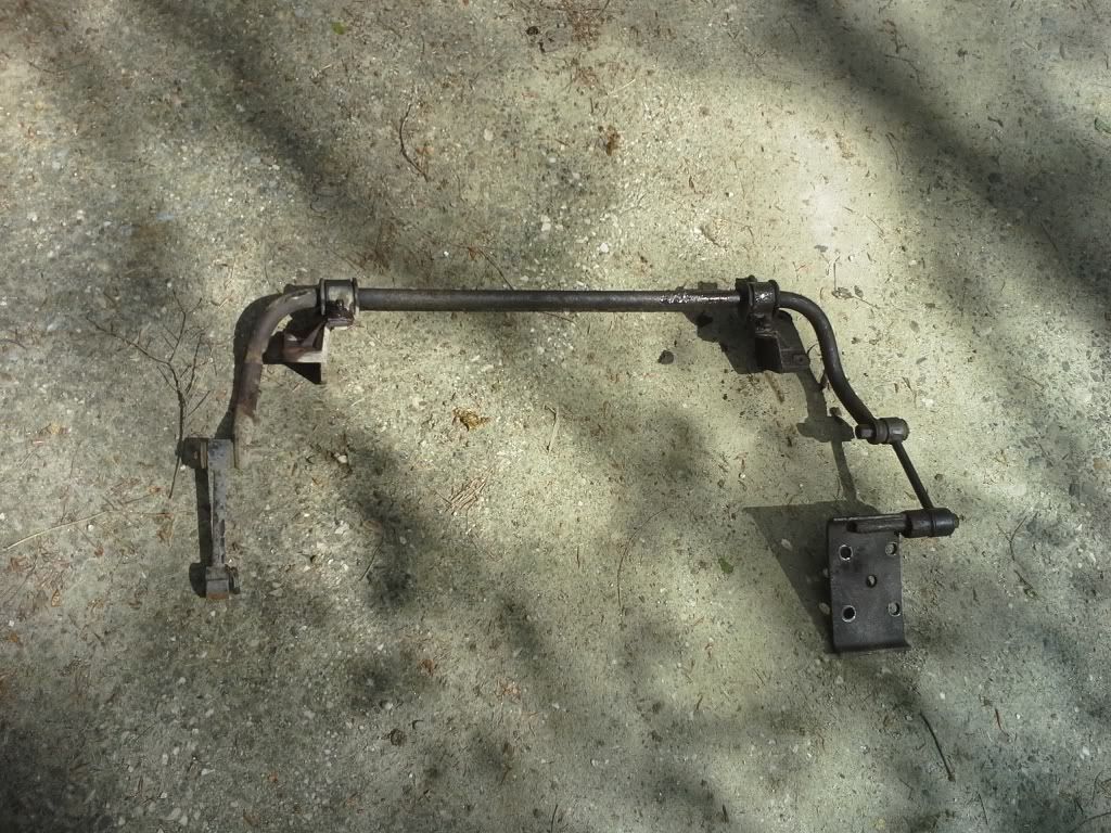

I pulled some excess hardware, ie my sway bar. Its a wheeling rig. I don't intend to use quick disconnects.
Got the drop Pitman arm in. I left the tie rod end loose, until i finish the other side.
Got the drivers side front in by the time i called it quits. One more spring to go. Then i am on to the tires. Not sure if i will figure that one out, tomorrow, or just save it for next Saturday.

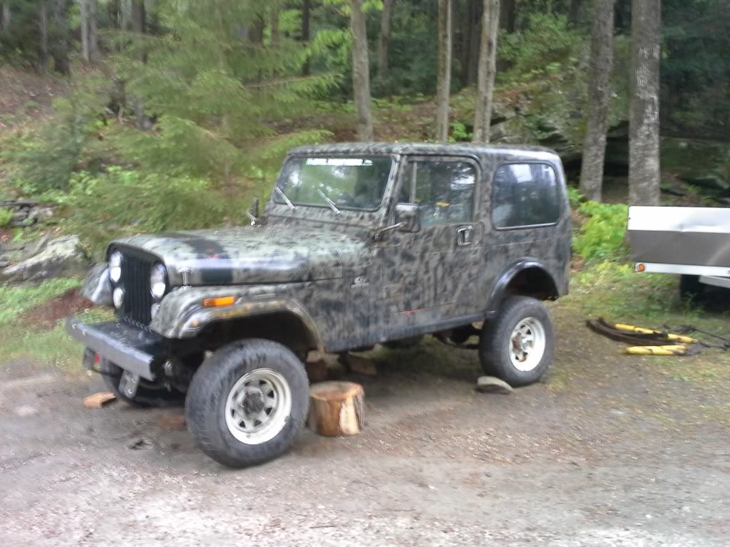

I finished up the last spring and reconnected the drop pitman to my steering linkage. Right as I was finishing, it started to pour outside. I got a little wet, scrambling to get the tire back on and get the tools picked up. It looks like a little brake line work is needed so that I do not rip them out, articulating. So brake lines and tires, Saturday. Then off to test things out on some class 4's, Sunday.

It looks great! The bigger tires will really complete the look! Cant wait to see it go this weekend. Again 1975 chevy 1500 front brake hoses are the same lenght as the upgraded 4" lines and they are like $9 a piece vs $100 for the set.
Gotta get that top and doors off too!

P.S. Not so sure about using a tree stump and blocks of wood to hold the weight of your rig. Be careful under there......

I really need to invest in some jack stands, when I have some extra $$$. Its on my list for 2013. I am, however, proud of what I have accomplished with nothing but wood and a tiny hydraulic jack.
