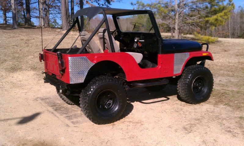

Heres my 84 laredo again after i put the locker in the front. Can anyone else relate to why the rear axle does not center when I'm at full flex, it is about an inch or two too far to the rear the tire rubs on the fender flare.
Look at your shackles on your pics. They are moving way to far during flex.

post #5348 of 8695 Old 02-21-2012, 10:27 AM
dylan0708
1984 CJ7
Location: deep river
Posts: 194
how do i stop that movement?
Longer shackles, are those cj springs? The axle looks too far back even on flat ground.

Renegade82
1982 CJ7
Location: Lewistown
Posts: 5,062
Bump stops need lowering.
His shackle at rest is already at a bad angle. Like you said his leaf spring might be longer than a cj spring. Or the shackle hanger at the rear is reversed. Look at the front spring shackle as its at the correct position at rest. It looks like the rear frame was repaired/rebuilt and maybe the hanger is backwards.

dylan0708
1984 CJ7
Posts: 194
They are rough country springs about 3 months old. Also I did repair the rear frame piece I may have reversed the hangers... Any pics of a stock one?

1979 CJ7
Location: nashville
Posts: 1,898
Just open up the wheel well and just assume you have a stretch.
