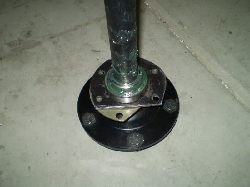

I have an AMC 20 housing that is going into a 70 Jeepster Commando. This is a blank housing, I do not have backing plates. I running into a Friggin night mare trying to find a set of backing plates in order to do this.
What I understand is you must have the backing plates since the hold in the bearsings and seals?
Im swapping in G2 Alloy Axles 4:56 gears and trussing the Wide Track 20, then Its going back to a SOA installation.
If anyone knows of a place to get cheap backingplates, or something else that would work let me know. I first thought I could just make my own with metal, but it appears the AMC 20 Backing plates dimple in to keep pressure on the bearings etc?
Only backing plates I have found so far where 100$ each, which is insane I for me just going to cut them up. Worse case, I will go back to Drums, since I found the Jeep guy has a full set of drum replacemtns that include backing plates for $350, but what sucks about that is for $300 more I could order the SSBC kit.
e
They are just flat 1/8" steel, after you hack up the backing plate. Copy the pattern of the outer seal.

So the area over the axle tubes where the backing plates would go is flat?
In all the pics I have seen it apppears to flange into the axle to hold the bearings in place.
But if its flat then this is a piece of cake, anyone have pics to verify this? Don't want to set this up and have problems down the road.

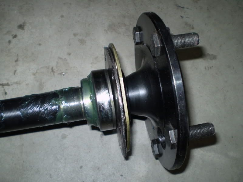

post #21 of 24 Old 01-20-2010, 05:57 PM
Totallymetal
Location: Colorado
Posts: 458
Here are a few angles of mine. Its the black disk with one flat side.

DaveFL
DaveFL's Avatar
Join Date: Jun 2002
Location: Gainesville, FLorida
Posts: 530
So in essence all I really need is a blank piece of 1/8 steel, and maybe a backing plate from someone I know to mark where the holes are located.
Thanks, this gives me a better clue, I can always mark hole points with the brackets but would be nice if I could have a backing plate that I could mark hole points with then cut from there.
Might be asking a freiend if I can dismantle his 20 for a pattern.

post #23 of 24 Old 01-21-2010, 03:09 PM
Totallymetal
Location: Colorado
Posts: 458
Wish I took measurements of the center hole. That could have been helpful. The outer seal plate gives you everything else you need.
