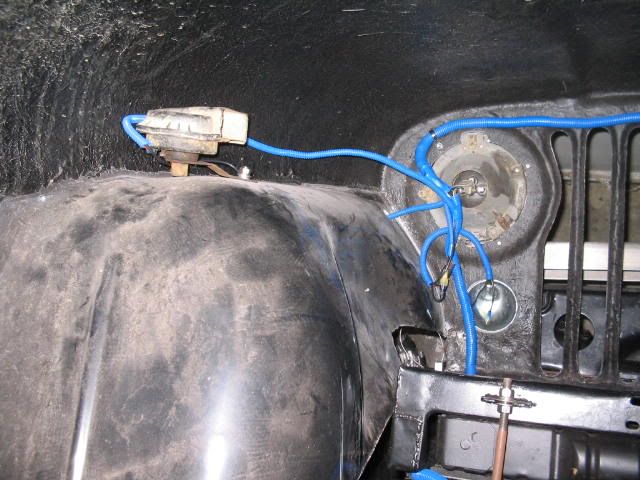

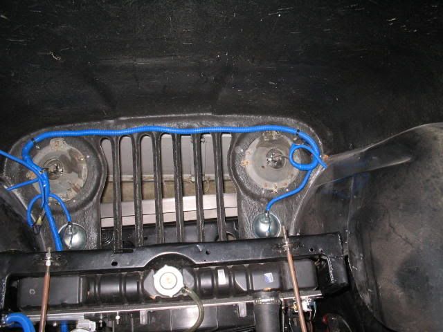

some use a angle frame welded to the frame to support the raddy ;mine I took a grill cut the raddy support out of it rbraced the bottom were it was thin and rewelded the hooks for the rods to the firewall used the fgrill body mount and the rods you can move it all around not ridiged this way
and for the lights in the front end ford trucks from the late 70's there light wiring have a plug set up wire it into your harness
the plug set up off a ford truck I just ran the wires down the support rod and down the raddy side

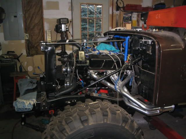

tilting a front end all depends on the front end mine had a pipe glassed into it for doing the tilt to the front and kentrol makes a hood hinge that has no pins so you make your one pin to pull out so mothing else needed to hold the hood down - for my hinge to go forward I made a alum plate with a small bearing in it and moroso quick release pins note I have no winch either
