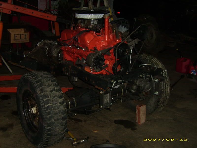

Hey guys,
Thought I would start a thread on my project I'm working on. Here are the spec's.
1979 CJ-7
1984 CJ-7 Frame
AMC 360 Motor
TH400 AT
Quadra-Trac T-case
D35 Front, AMC 20 Rear 3.73 Gears

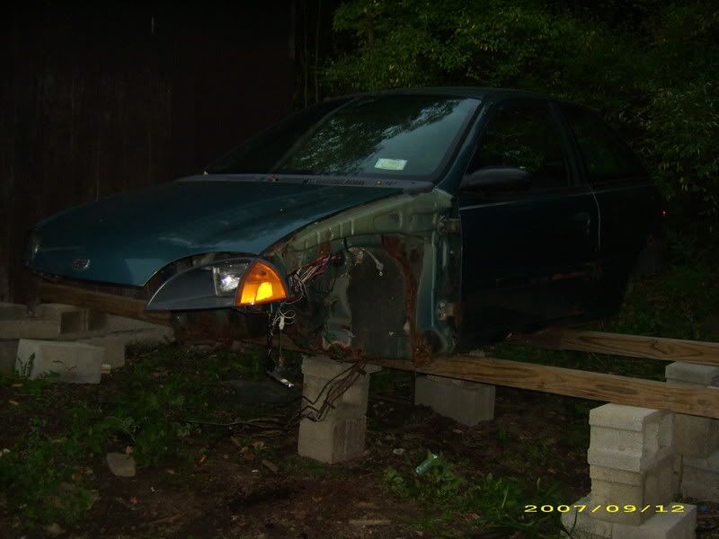

Before I get any haters on this, I want you to know I am a die-hard 4x4 enthusiast. I have wheeled with many different types off vehicles out there. The Jeep is the most common. I figure there is a reason to this. What makes a good 4x4? The guts. That is what I kept from the CJ-7. But, since so many people have Jeeps, I want to be different.
When I did my homework, I found the Metro and CJ-7 have the same wheelbase, and thought how funny it would be to make one of the smallest cars out there a capable off-roading 4x4.
The first pictures I have taken is after I welded the frame back together and put the wheels back under it. Some of you may have already seen these.
Don't even ask how long it'll take. Good news, my work schedule is 4 on, 4 off. Bad news, I'm low on cash and Winter is coming.
I'll try to keep updating as I go.

Sept. 20th update
Finally got the motor is proper position. Had to move it forward 12" to clear the Metro firewall. My friend ran out of gas while welding the motor mounts, so they are not braced yet.
The T-case skid had holes narrow enough so I could drill solidly into the frame to secure it. The driveshafts are now 26" and 29" at rest, making a better angle to the rear. I will make homemade shafts after I flex it out and get the proper size.
I also did much more work to the body. I pulled all the wires unneeded to run things like headlights, etc. Also have the whole front end and rear suspension cutout. I'm hoping to test fit it this weekend.

The Body and Frame united for the first time.
The body WILL be lowered a bit. I ran out of time as I got the 4x4's out from under the body. Depending on how much bodylift I install, the front will go down 4-7" and the rear 1-4."
For some reason, it looks so much taller than my wife's TJ with 4" lift and 33's. And it still has stock tires .
