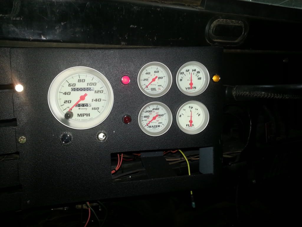

post #5 of 5 Old 12-14-2013, 05:25 AM
Blakescj7
Join Date: Sep 2013
Location: Tulsa
Posts: 515
This is how you fix it
