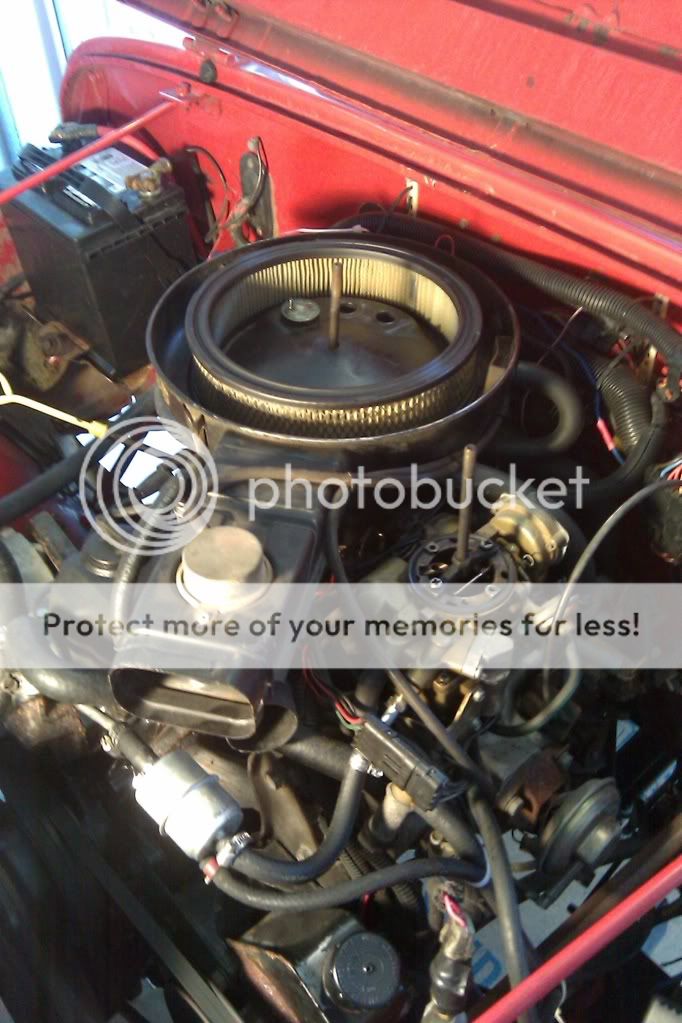

So I got a 1984 CJ7 for $800 bucks on friday. The previous owner complained that it wouldn't run right so I popped the hood and it was pretty obvious the issue, all but a very few of the vacuum lines were even hooked up. In fact most ends where they should be were capped off. I know that replacing all the lines is a nightmare, but I've found a couple diagrams online. What I really want to help me out is if someone else happens to have an 84 cj7 with a 258 inline 6 (5speed manual) could take a couple shots of there engine bay while the air filter is off so I can get a decent look at how some of the vacuum lines are placed/ran along the engine. Thankyou for your time and any help you can offer. - Anthony
So I'm Editing again, I've got some pics up of the jeep and the engine. Would anyone be willing to help point out what some of these things are because I'm having a lot of trouble getting this done and I can't figure out what some of these ends that are capped off are. Here's the URL for the photobucket with all my photos. http://s954.photobucket.com/albums/ae27/SeaJay7/

I'm in Virginia and I have to pass all the emissions tests, or atleast to get it inspected :/ After that I'm safe to undue it all again, but I have to get it together right to get it passed inspection. Do you have any photo's of your engine bays before you capped everything off?

Just an FYI, your gas filter is in upside down. This can cause long cold starts because the gas can siphon back to the tank when it sits causing vaporlock.
The filter is supposed to sit level with smaller return line off the top of it. This way on a hot shutdown, any vapors produced get blown back to the tank off the top of the filter rather that vaporlocking the gas line.
Ouch! Ok, someone posted that is just has to look right so I wonder if you hooked up all the basics for a good runner and physically cleared out anything else so it didn't look disconnected if you could pass the visual?
For starters you should see if the emissions computer is still trying to run things. To see, you need to look 'way' down on the drivers side fender under the washer bottle at the ignition module and it's plugs. The module will have an orange, purple, green and black coming out of it to one plug. The 'harness' side of this plug will 'not' have a purple wire in it. If the purple wire coming out of the module is spliced with a new wire, then the computer has likely been put out of your misery. If the purple wire just stops at the plug, then the computer is still connected to the carb and distributor.
Here are some 'basics' for vacuum for a good runner: Vacuum Hose Hook Ups - JeepForum.com
I am plagued by the long cold starts. Pictures are always easier for me. Could you post a picture of what it should look like? Thanks.
I just got slapped down in another thread by a moderator for posting the photo of it sitting properly from the owners manual (Copyright issue) and have mine in pieces right now.
Look at the above photo in post #6 and then think you can just grab the filter and twist the sucker clockwise until that bottom side hose is up top.
That way the center line goes to the carb and the top line goes to the return line.
