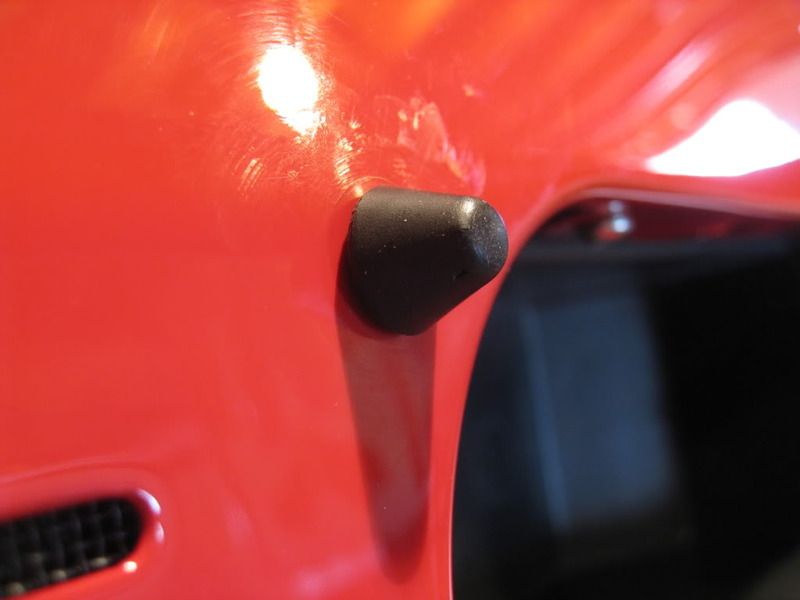

Originally Posted by keith460 View Post
Had a little trouble getting these old rubber bumpers back in their holes as they seem to have dried out some after 25+ years. I soaked them in motor oil overnight and that made them more pliable and was able to push them back in. Normally you just need to pull on the extended rubber tails on the back of them and pull them through but they broke off on the first try.
Are the rubber bumpers available anywhere? Mine were painted with the dash and I won't be surprised if they crumble on attempted removal/cleaning.
tia.
tia.
Yes, and their cheap too. Just get ones for 60's and 70's Chevy.

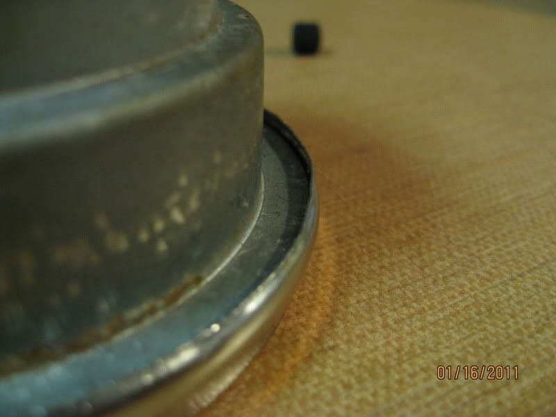

OEM Clock Repair
Been working on the clock to replace the faded clear plastic cover that won't come clean no matter what polishing compound I use. Read on the internet that some plastics, like ABS, will not come back clear due to a chemical reaction from harmful UV rays from the sun. Apparently this is the type of plastic the OEM clock face cover is made of so I must replace it.
The hardest part in repairing the clock and other OEM gauges is getting the cover separated from the gauge body. A flat screwdriver and patience while prying up the folded lips edge is all that is needed. Time consuming but gets the job done.
You can see the difference between the original plastic cover on the right and the new, water jet cut, polycarbonate or Lexan cover on the left.
