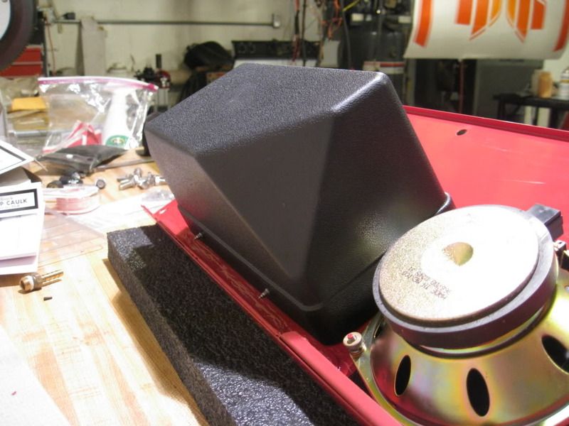

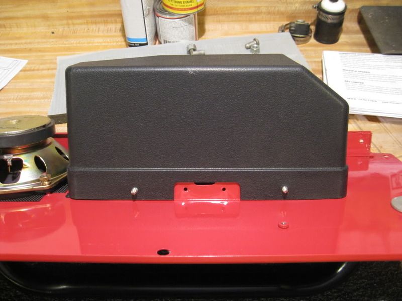

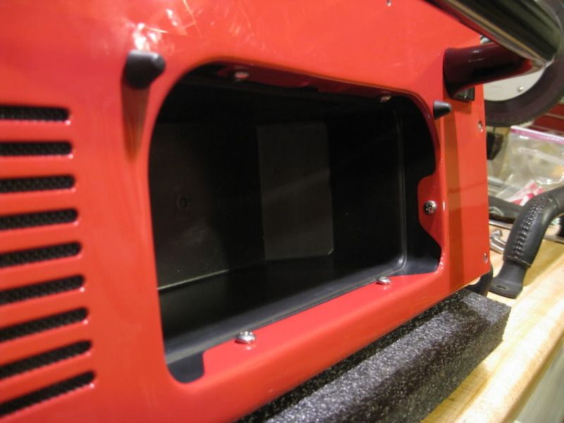

Glove Box Install
Had a little trouble getting these old rubber bumpers back in their holes as they seem to have dried out some after 25+ years. I soaked them in motor oil overnight and that made them more pliable and was able to push them back in. Normally you just need to pull on the extended rubber tails on the back of them and pull them through but they broke off on the first try.
Next I installed a new glove box that is made of plastic instead of the original black cardboard type from the factory. Both are available online at several vendors but I decided to go with the plastic one since mice have eaten the cardboard one twice already.
Word to the wise: if you are going to store your Jeep for long periods of time, place little plates of mothballs around your Jeep to keep mice and spiders out, they hate that smell.
