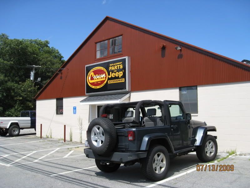

I believe Crown Auto must have corrected the problem then because Omix is a middle man that acquires Crown Automotive made parts.
I payed a visit to Crown, who are out of Canton, MA., about a year and a half ago and we discussed that very same problem with the dash lights they were making at the time bleeding "back-lighting". They were aware of it, and were working with their Chinese manufacture in resolving the issue. They read forum pages like this and that is how they found out about the problem. I also talked to them about the cheap pull knobs on the cable for vents and temperature controls that had issues of pulling off on the first try. It was kinda funny, they brought out a box for testing out of stock when I was there and sure enough, one of the knobs pulled right off the brand new cable. A little bit of yelling to the back and a few of the Design Engineers came up front to the counter and took a closer look. They gave me a free box of the cable pulls for bringing it up to their attention and just goes to show that some manufactures do care about what they sell. I mean the owner, who I have forgotten his name, was really embarrassed by the whole ordeal.
