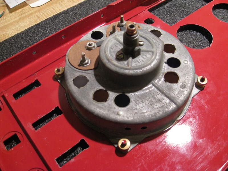

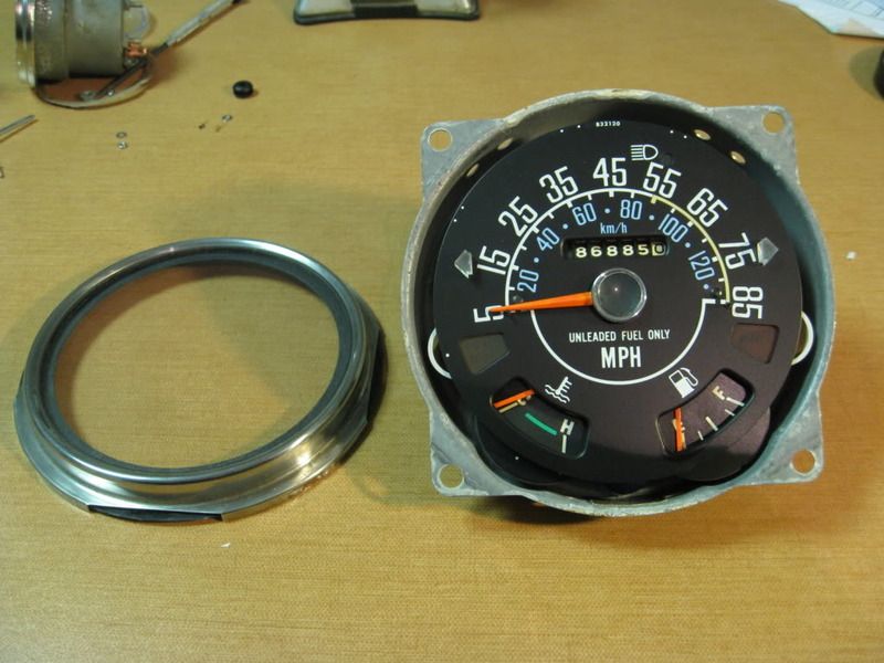

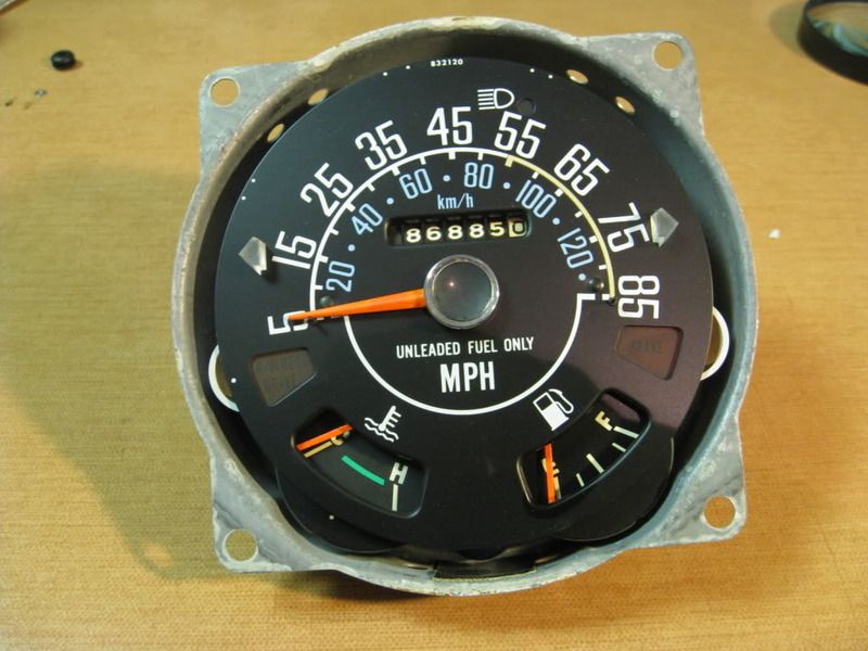

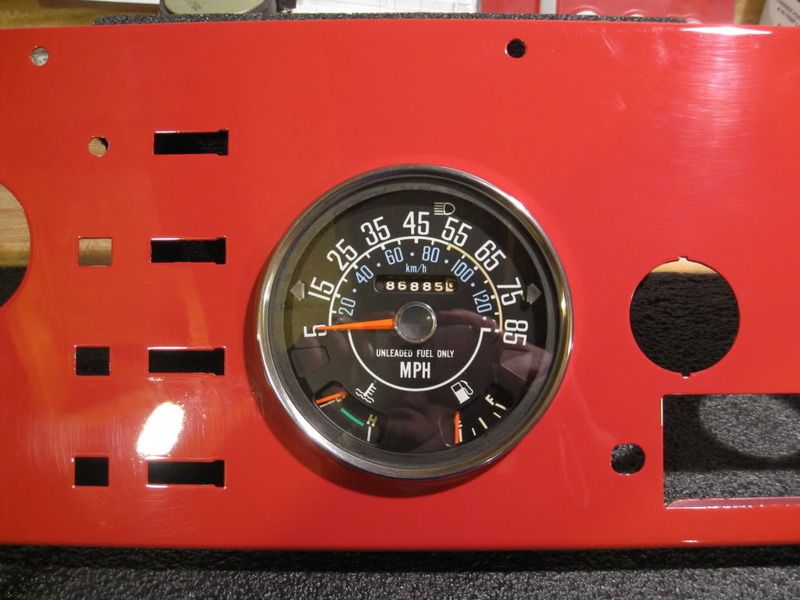

Next, I installed the speedometer using the same type Brass Thumb Nuts but they are 10-24 threads.

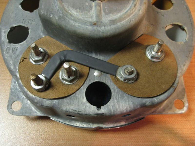

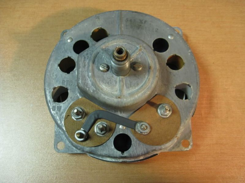

I had the speedometer apart last year to paint the needles with a fresh coat of florescent orange and refurbish anything that was needed. Replaced the insulating sleeve on the jumper bar between the coolant temp and fuel gauge with a piece of heat shrink tubing.
Also replaced some of the melted blue colored clear dome gauge lighting covers from a donor speedometer housing because I used the wrong type of bulb years ago. Correct bulb is a short length #53 bulb.
Installed Speedometer.

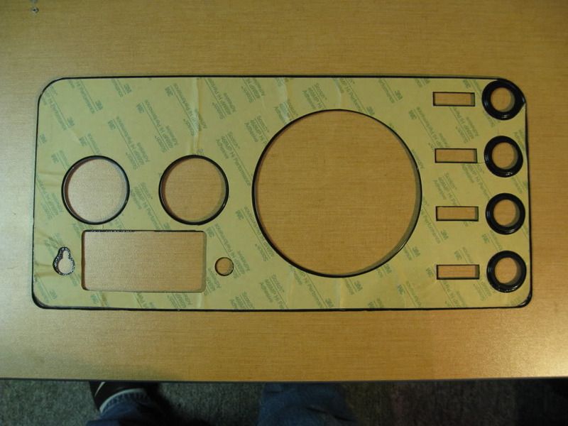

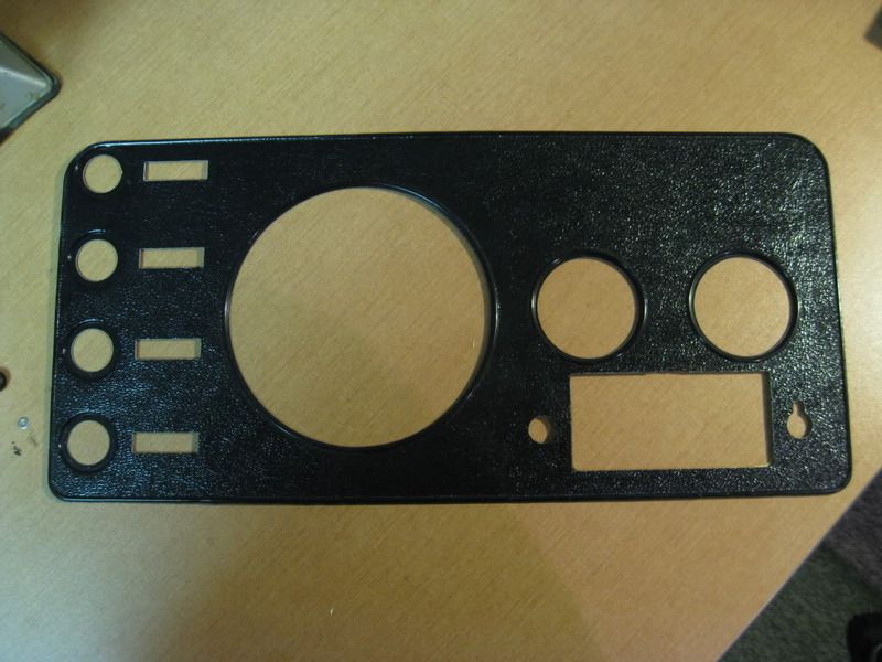

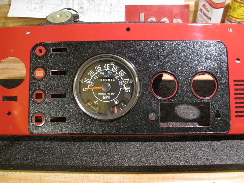

Plastic Overlay
Debated whether to install the black plastic gauge overlay only because I always liked the look of the dash without it. But, since my Jeep CJ came with it from the factory due to the Renegade package, I decided to put one back on just to have the correct OEM dash look.
It gets installed before anything else goes in as all other gauges, dash knobs and lights are mounted aftwards.

Voltmeter and Oil Pressure Gauge
Next we installed the voltmeter and oil pressure gauges using original hardware. Would have liked to have taken these two gauges apart but they proved to be to difficult to separate the glass bezel from the gauge housing without fear of breaking them. You can't get originals anymore unless they are NOS or used and their was nothing wrong with mine except the faded florescent orange on the needles. So back in they went after a little cleanup.
