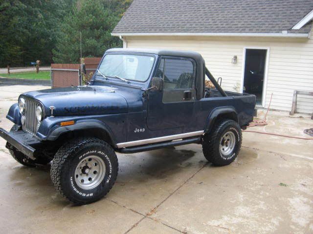

Good luck. Looks like a very clean Scrambler to start with. My Scrambler has a 4.6L stroker, AX-15 and D300. I really like this setup. Even running 33" tires with relatively high gears (3.31) it pulls hard and has no problem smoking the tires in second gear. There are lots of technical write-ups about swapping 4.XL motors into CJ's, but the CJ Offroad forum has probably the most comprehensive coverage of this issue in their 4.0L swap forum: CJOffroad.com - 4.0 Swap Information

Thanks. It looks pretty good but still needs some attention. It's got some rust issues starting that I need to address ASAP. I just finished installing one piece rear axles and an ARB air locker, so it's coming along. The PO installed 3" Black Diamond springs with ProComp shocks and 33" BFG AT's.

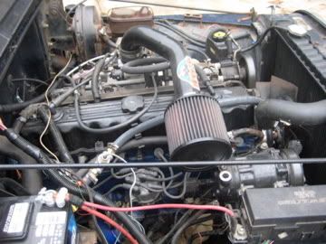

The PO built the stroker and installed it. I bought it running but needed a lot of detail work. He was okay at doing bigger projects but sucked at paying attention to detail. The wiring was a mess, none of the lights or gauges worked, half the bolts had not be torqued, etc. I spent about 3 months fixing all of his mistakes. Which makes me wonder how well the engine was built, but it's running great so far and seems very tight.
Without knowing the full details of the build, I only know what he told me which was:
97 4.0L long block from an XJ bored and stroked to 4.6L
"dished pistons" (I don't know the specifics of what pistons he used)
Competition Cams Extreme 4x4 Cam 68-232-4
62mm throttle body with 1" spacer
Ford 24lb injectors.
Hedman header
Turbo City Rock-It air intake with K&N filter
It's running the stock 97 XJ wiring harness and computer which seems to be working okay. There are some issues with using a non-stock cam with a 4.0L, you will have to cut the ears off the distributor to allow you to index the distributor correctly. It's a bit of a pain in the butt, but there are several write-ups about it on the web.
