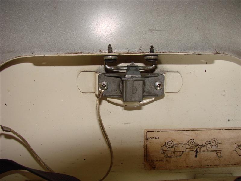

You can try to reach up to the top and poke a hole to access the inside latch. It can be pushed down to pop open the door. Its spring loaded. Another option is the unbolt the two screws at the hinges and carefully swing the bottom of the door out to reach inside to access the latch.
IF your lock knob is not rusted and in good shape, Ill trade you a good non locking door unit with bottom/inside latch for your lock and inner latch. I have a few colors.
OR once you get it open, you can separate the lock and have a key made.

Here's a view from the back side without the box in the way. The lever is sloped at pushes down as it hits the latch rod. Once clear, it springs straight back up and behind the bar that holds it shut.
Hard to explain, maybe the pic will help

I was able to get the glove box door off today, but it took a little work. I had to remove the bolts of the lower hinges, then remove the two screws holding the latch (once it locks in place). I may look into getting a replacement lock, or maybe one of the drop in locking kits that replace the box. Any suggestions?
