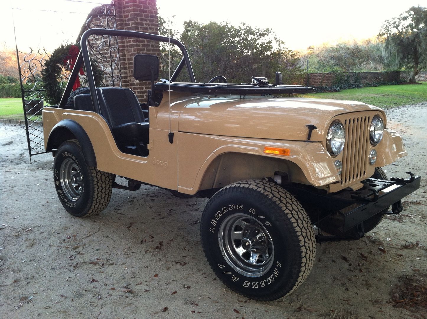

Here are a couple of daylight shots from an hour ago. Need to get the exhaust leak (at the flange at the upper pipe/manifold on the drivers side) sealed up. I smell like fumes. I also feel a transmission rebuild in my near future!

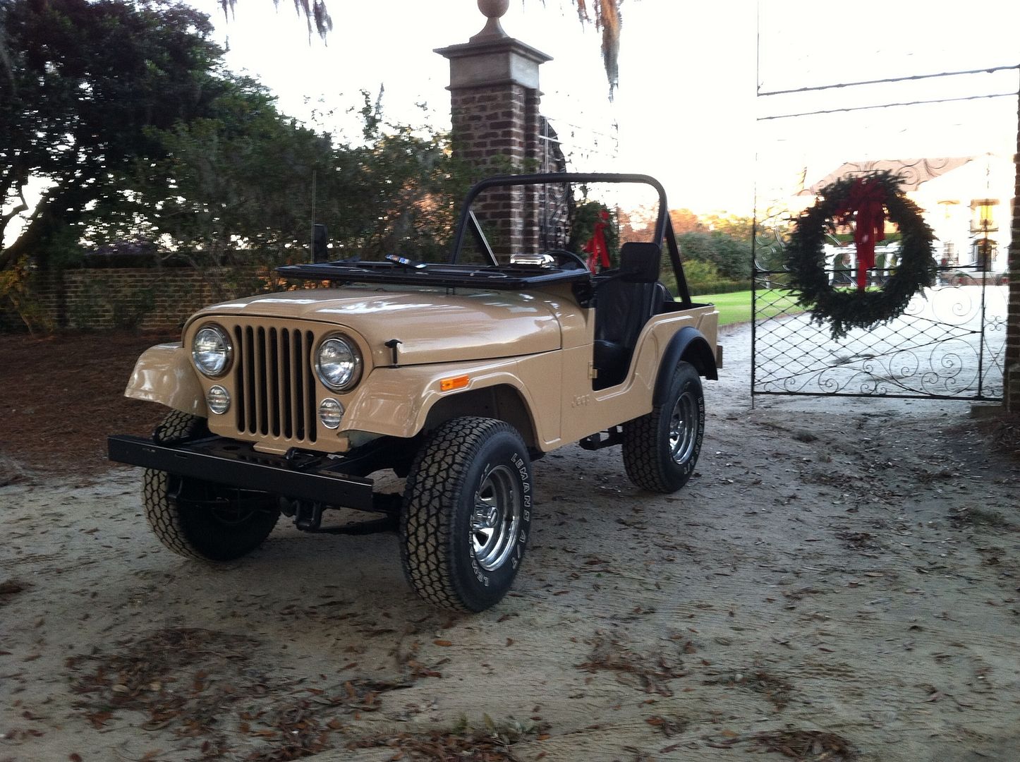

It's been a bit since I've posted any updates...well, there aren't that many (other than pulling the dash, repainting it and creating a new problem with my dash lights). But I have cleaned up a few things, and am having a hard time keeping the wife out of the drivers seat. She's a wedding photographer by trade, and recruited one of her shutterbug friends to snap some christmas card pics with the CJ in it. I'll post those later (they turned out great), but in the interim I had to send a few poser shots I took with my crappy phone camera:
Blurry shot of the wife unit enjoying her Jeep:
Dropping the transmission/clutch this next month to square away a few minor issues there, and then I guess it's time to run the dual exhaust to let that V8 rumble

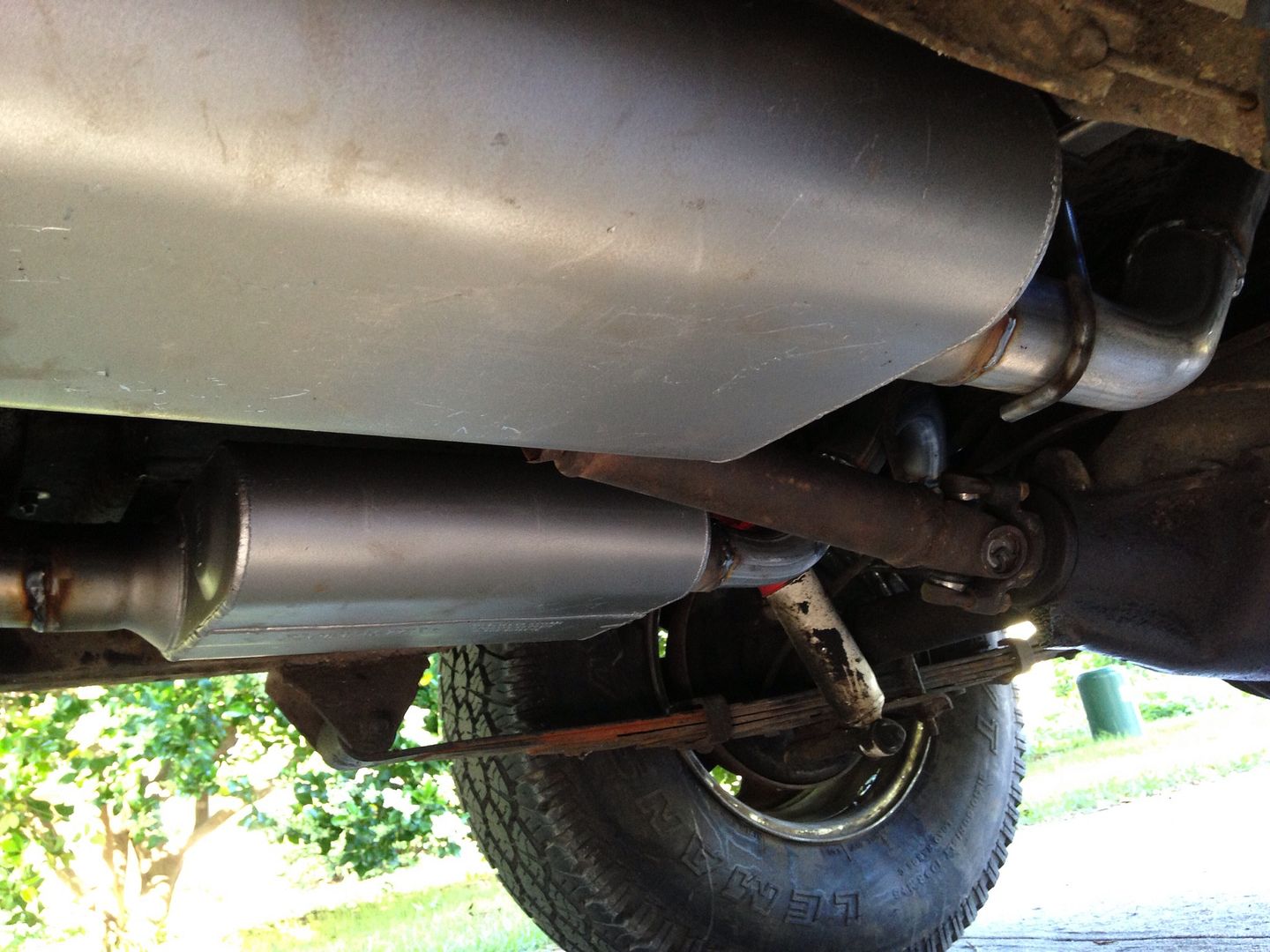

It's been a while since I've updated this thread, but thought I'd show off my new exhaust!

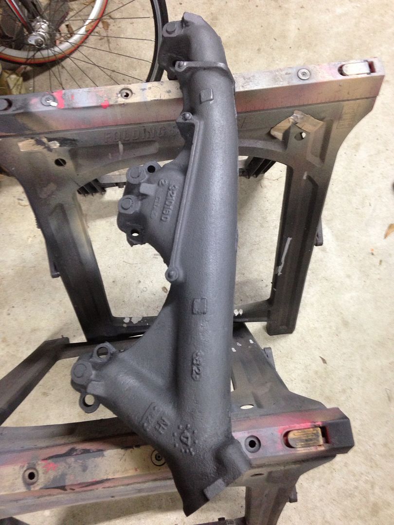

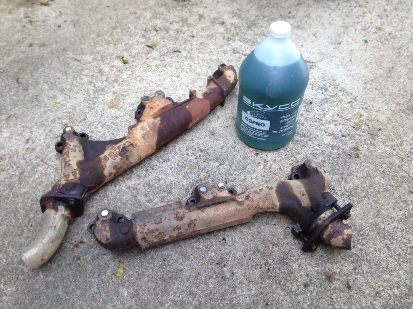

I've had a nagging leak between the exhaust manifold and exhaust pipe flange. The PO had installed new exhaust a few years back and it was less than admirable. The 304 felt like it was struggling to breathe and I've always had a soft spot for the V8 rumble. After some research, I decided to stick with the stock manifolds, duals, Flowmaster 40's and exits behind the rear wheels. I'm thrilled with the results.
I first needed to do something with the rusty old manifolds. I really liked what Matt1981CJ7 did to his, so I picked up a bottle of Ospho, dipped the overnight, wirewheeled and painted them in POR15 Intake Manifold Gray (in hindsight I wish I'd picked a more "silver" color, but they still turned out fine).
By the way, when I posted these pics on another thread regarding exhaust, a member correctly pointed out that these were not CJ manifolds (these have a rear dump on the drivers side which interferes with the clutch linkage). Well, as it turns out, the muffler shop that installed the old system for the PO put a severe bend in the pipe to clear the linkage, and this resulted in a massive restriction in the flow. The shop I used got creative and made a more custom mandrel bend which preserved the integrity of the pipe opening. They tucked the mufflers between the rails and did a really nice job with the exits in the rear. Also, the power difference I have now is amazing. Part of me thought "Nah, it's just the sound that makes it SEEM like it has more power", but after a couple of days of driving it, I'm fairly convinced that restriction was costing me some HP.
I see a summer project in my future. The underside of this thing is NAS-T!
