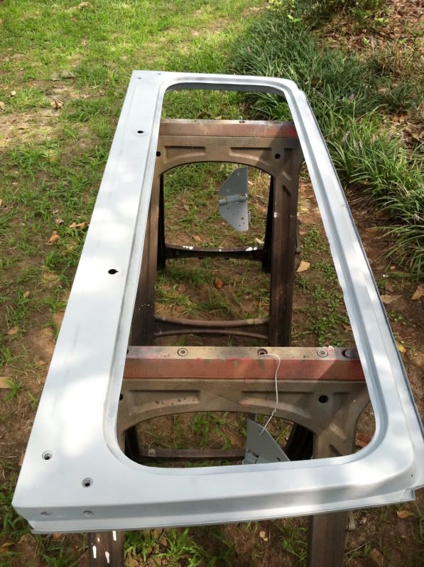

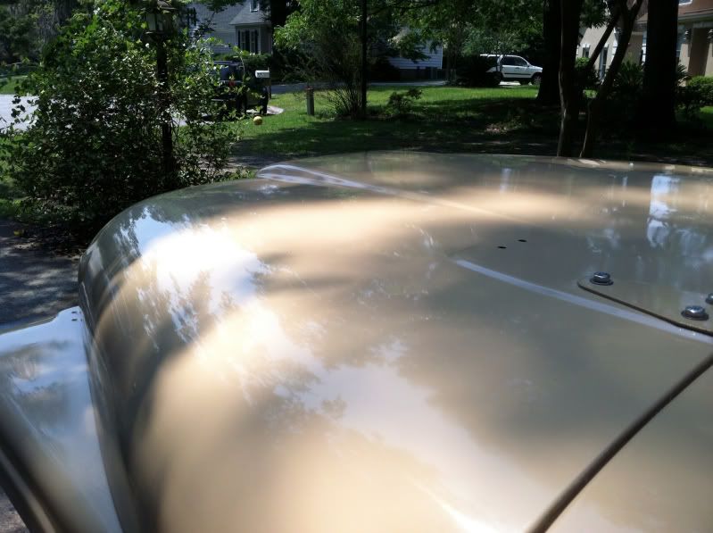

Worked on the windshield and also figured I'd better "cut n buff" the paint before it ended up rock hard. Did anyone know it's hot outside? I'm about ready to pass out, so I've stopped until tonight when I'll paint the windshield black.

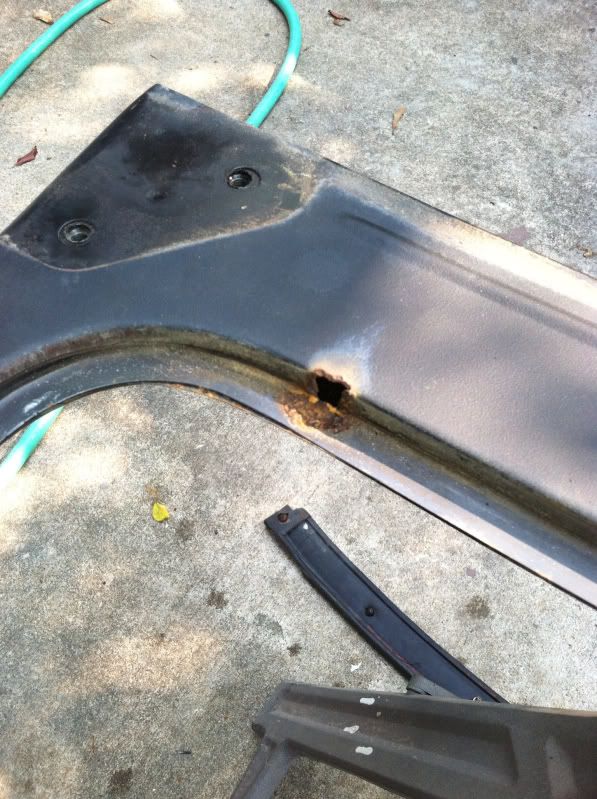

The PO also painted the windshield black, but used a "textured" finish. The frame had plenty of rust. This was a pain and took nearly all day Saturday. If I had to do it over I think I'd just buy a new frame (especially since I think this one wasn't original).
I used aviation paint stripper, and finished it off with an air grinder with a gasket remover pad which worked perfect!

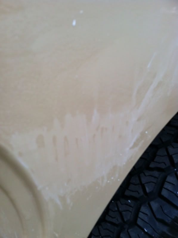

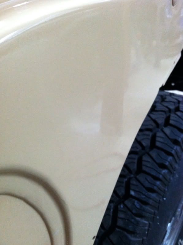

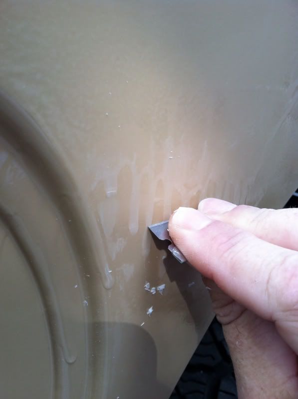

Now this Is one of the neatest tricks I've ever heard of! I had some very bad "runs/sags" in the clear on the drivers side due to poor lighting and needed to sand them out. I read about the "razor blade" trick, and it worked perfectly. I almost had fun scraping this stuff off!
And finally did a little wet sanding and compounding. The heat about killed me at this point. Time for a beer.

Razor blade is a cool trick, and it buffed out great.

I TOTALLY forgot to get new bolts for the windshield bracket. The old allen heads were shot, so I bought new stainless ones today. And yes, I fixed the rust. I couldn't weld it without blowing more holes in the metal, so I used the waterproof fiberglass body filler. I used that on a hole in my YJ windshield and its lasted for 7 years now!!
