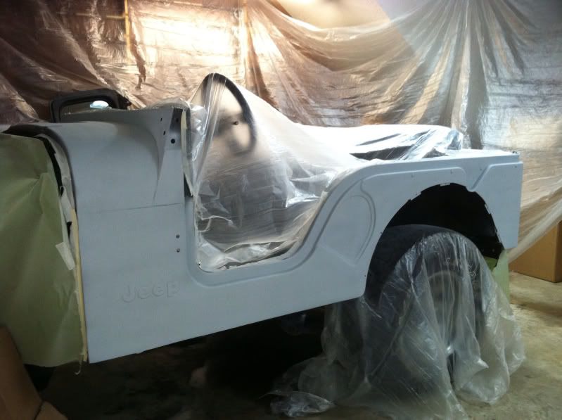

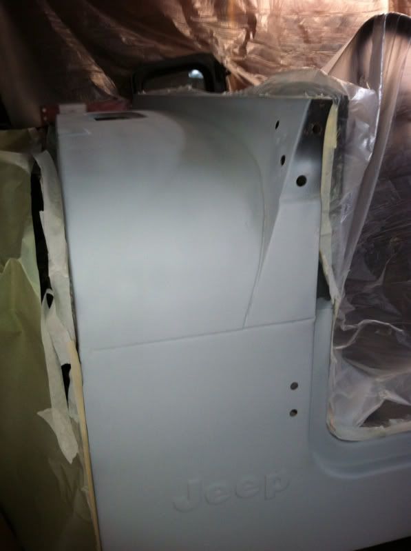

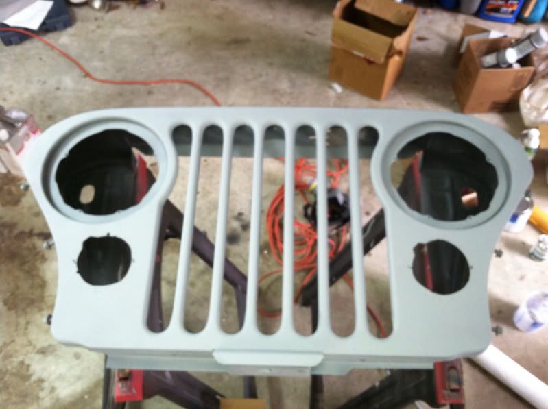

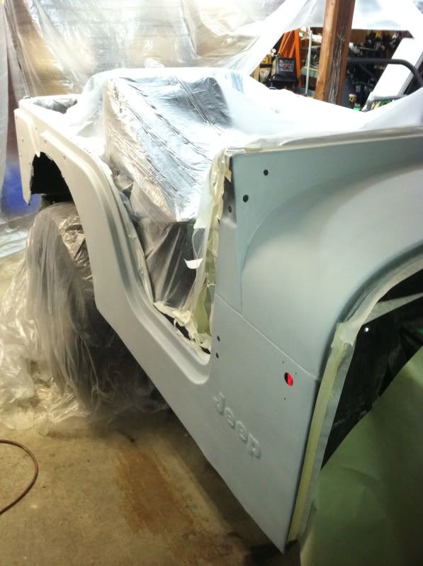

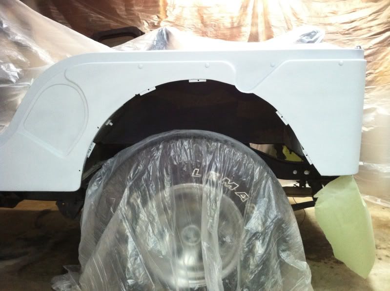

Finally, an update on Turd Ferguson. I kept finding little nitpicky things to repair (and found another rusthole on the floorpan next to the driver side rocker that had to be welded prior to laying on any new paint), and weekends have continued to get consumed with "other" priorities, like buying a new Elk rifle. Well today I finally got up the energy to build my redneck paint booth and sling on the primer/sealer. I'm using LIMCO 800k primer, and the first thing that I discovered is this stuff is a little thick, and I should have reduced it a bit since I'm shooting the whole thing (primer/base/clear) with a 1.4 tip. It just made for a slow process, but it's done and my next step is to sand it, shoot the base coat (Cameo Tan) and the clear. If I can stay out of the boat and gin-n-tonics I'll get it finished next weekend.
I put a small window unit in the garage to try to keep the temps down. Today it was smokin' hot and humid. Little A/C isn't cutting it so I've got a feeling I'm going to have to use the slow reducer on the clear to keep the orange peel at bay. Why do I always wait until summertime to paint these blasted things???

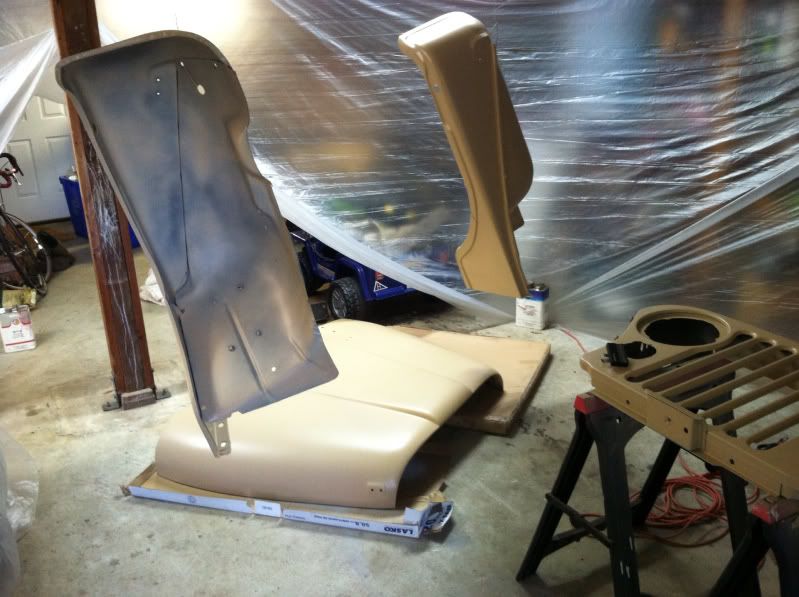

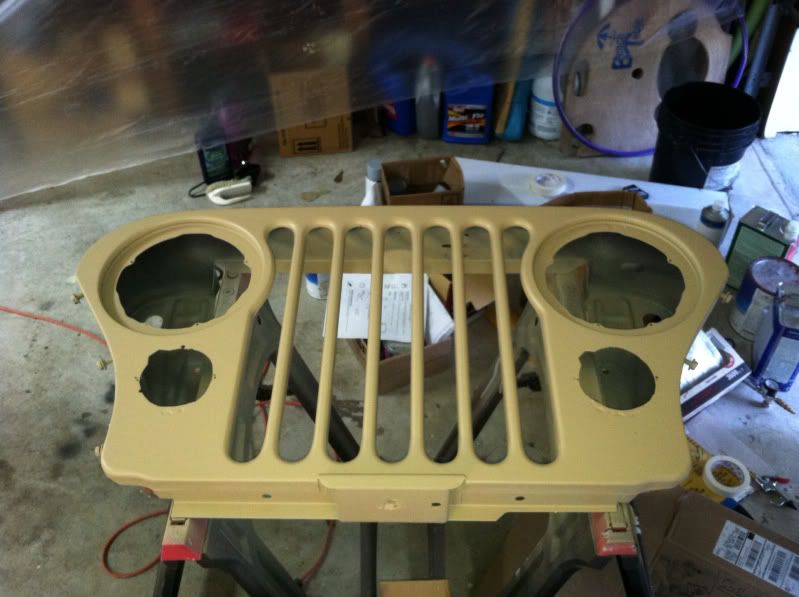

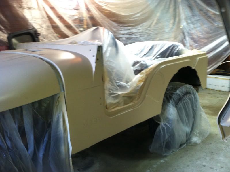

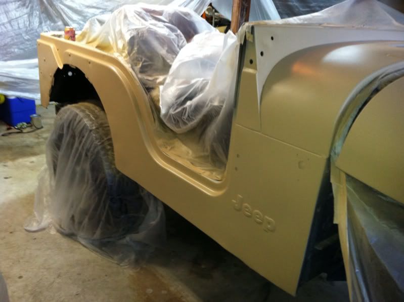

FINALLY got the Basecoat on this afternoon! The color looks a little darker inside the garage than it actually is (Cameo Tan). If I was a single man I'd be spraying the clear on it tonight. This part is always easy, but shooting the clearcoat is what has me trembling in a corner knawing on my fingernails. Last time I did clear I had orange peel like no tomorrow, so I'm hoping I can keep the garage cool enough to keep it smooth.
Not sure why I wear the Tyvex suit. I should go commando under it next time..yeah, TMI!
I was running out of room, so I laid the hood in place over the engine and painted it there:
