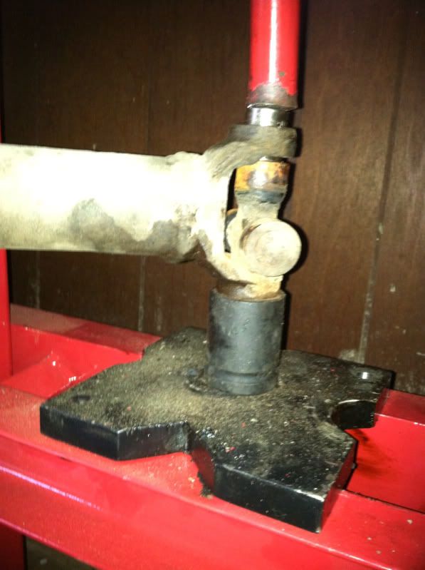

Squeezed in an hour tonight which was long enough to install a new set of U Joints on the rear driveshaft of Turd Ferguson that will hopefully eliminate the driveline vibes I felt last Sunday when I took it out for a test drive.
I've got to stop beating myself up over this Jeep (literally). Wacked myself in the mouth with a wrench while laying under the 5. And that's not me with a bad lipstick job. That's blood that was all over my mouth when I crawled out from under the CJ.
Nothing exciting to report, but will say that the Shop Press once again proves it's worth. Pressing out U Joints takes no time at all!!! No more whacking on 'em with a hammer.

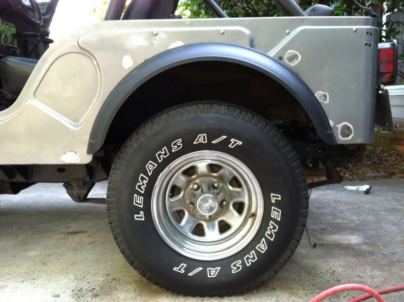

As mentioned, the PO hacked the front fenders and fenderwells to install TJ flares (even though he had no plans for large tires). I thought they looked heinous, so it's going back to original, with standard flares. Today I threw the front fenders on to check for fit, just to be sure i didn't need to hack on freshly painted steel. Fortunately, the Crown (technically it says "Cobra King" Made in Taiwan) fenders fit perfectly. I'm impressed. Sadly, the drivers side went back to Quadratec today since the gorillas at UPS threw it around enough to dent it in two spots. Here's a shot this morning with the fender on the front and the rear flare "mocked up" on the tub. Note the old TJ flare holes. I filled those in today.

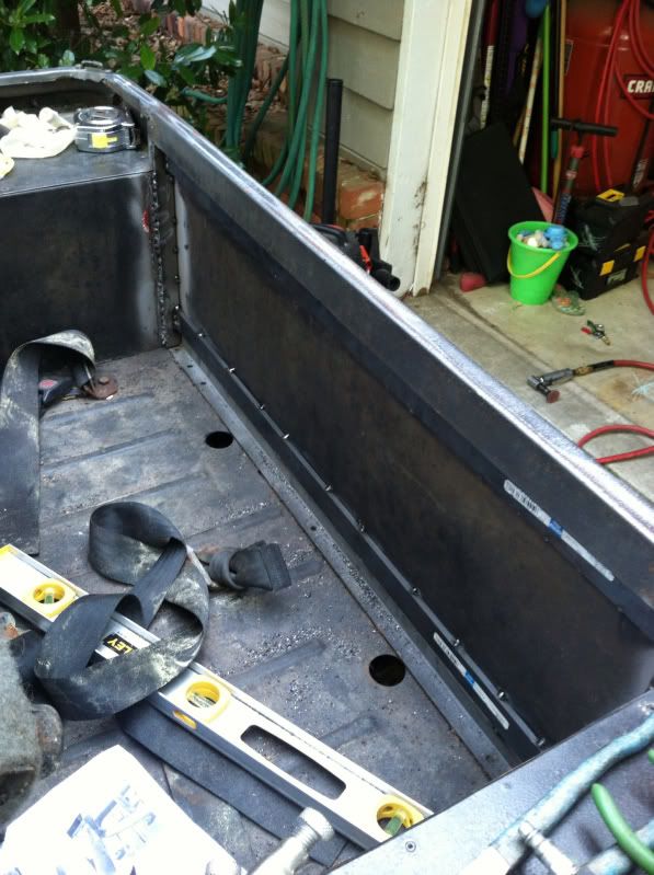

Next I needed to address the rear tub hack job. I decided the best way to reinstall the flares as close to the original position would be to weld "tabs" in the opening to give them a lower mounting point. I know I'm overdoing the pictures here, so I'd better become a "supporting member" since I'm a bandwidth hog.

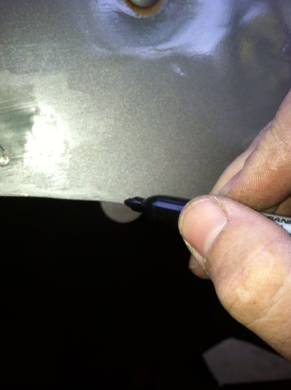

I clamped the flares in position, and found some old round magnets in the shop and put those on the backside of the wheel well to mark where to tabs needed to go.

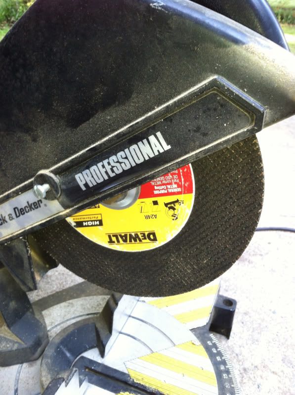

Then I cut out small rectangular pieces of sheet metal, sprayed them with weld-thru primer, and tacked them on. By the way, I've found a metal cutting blade for the miter saw is a great way to quickly cut out pieces of sheet metal. Here's what I'm using:
Then I used a stepped drill bit to make the holes for the screws that will attach the flares to the tub:
Here is the finished product. Old holes are filled, and even though the flares are still a little high, it's close enough. I'm not putting this thing on Barrett-Jackson anytime soon, so it works for me. It should look much better once it's painted and all buttoned up.
I owe Pathkiller big time for telling me about the "welders spoon" trick. With that copper piece held behind the old holes, you can make short work of filling them in with the MIG.

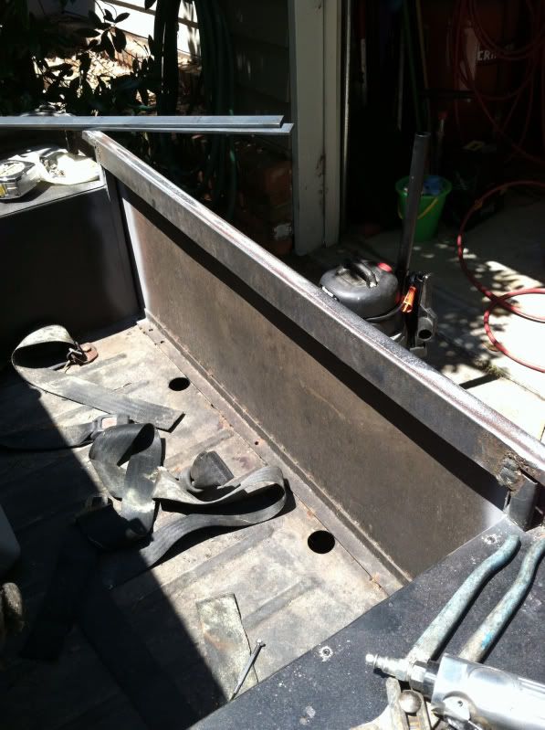

The CJ has a solid back, and there was no tire mount, so I needed to shore up the sheet metal back there for the spare tire carrier. Here it was when I started:
Here it is finished. I welded steel on the sides at the wheelwells to give me solid bracing to weld two more thick pieces of steel laterally across the rear. I drilled through the lateral pieces to bolt on the tire carrier and the braces are doing a good job of taking the weight. I'll reinforce it further if it appears to not be strong enough. Like the numbskull I am, I forgot to take pics of the tire carrier before i removed it.
