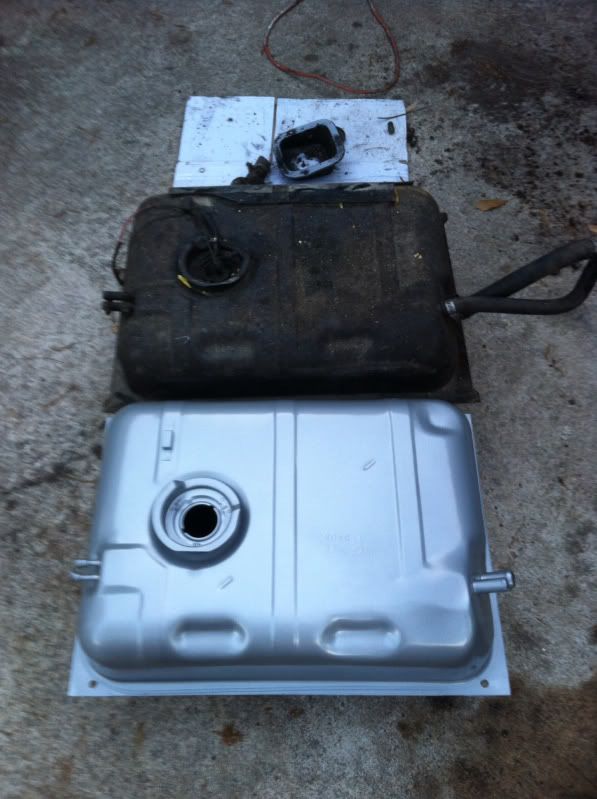

So here is what has happened so far- when I drove it to the house, my wife said "it smells like gasoline-it's stinky". Well, the gas tank was leaking as it had a million pinholes in it. So the first thing needed was a new gas tank (I went ahead and ordered new fuel hoses and sending unit just to be done with it.
New tank vs old...
When I dropped the tank, the skidplate had some nice rust. Rather than spend 70 bucks on a new plate, I patched up the old one, cleaned it and POR 15'd the whole mess (by the way, the skidplate bolts on the rear of the frame have always annoyed me, I welded new bolts in from the topside so I don't have to deal with "spinning" nuts that aren't captive). At this point I was using fluxcore wire on the MIG, so it's a little ugly and I kept finding that I was blowing through the skidplate. "Ironworker" on this board was a huge help on educating me that I need to go with 75/25 gas on the MIG, so that's what I'm using from here on out for the rest of my repairs. I wasn't overly concerned with the appearance on this since the patch welds face toward the front of the vehicle.
The new tank is in (what a pain getting it back in there by myself-the floor jack was helpful). Next up are the new debacles I'm facing.
